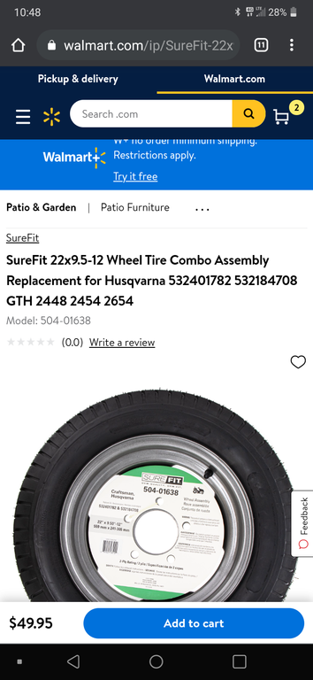

Jason X 19 #1 Posted July 18, 2021 (edited) I have a 1972 WHEEL HORSE COMMANDO. The rear tires were old (like 38 years) but hanging in there. When one finally went flat it shredded. I found that 22 x 7.5 x 12 are discontinued but 9.5 will fit just fine. $80 each was the cheapest tire I could find but then I found these at walmart.com and Amazon. They're already on rims for Husqvarna. I was gonna have them mounted on my horsy rims because they're cheaper than just buying the tire. Guess what? It's the exact same rim as my horsy!!! They bolt right up!!! Edited July 18, 2021 by Jason X Grammar 5 Share this post Link to post Share on other sites

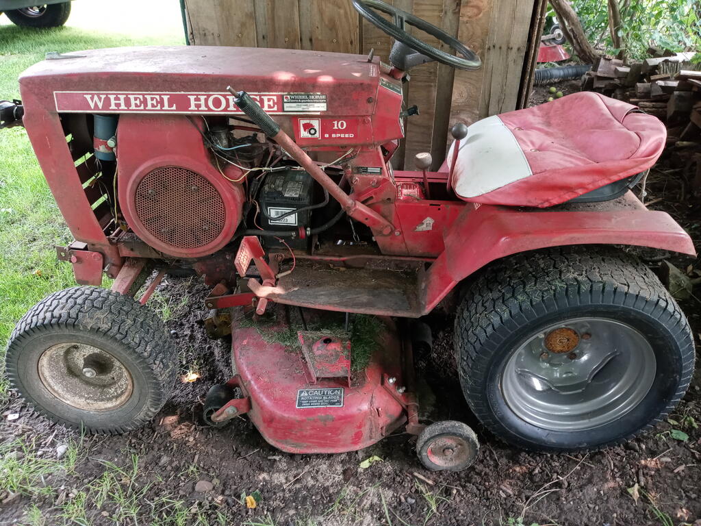

Jason X 19 #8 Posted July 20, 2021 On 7/19/2021 at 12:29 PM, Jason X said: Yup 2 Share this post Link to post Share on other sites
RandyLittrell 3,894 #9 Posted July 21, 2021 On 7/20/2021 at 1:33 PM, Jason X said: Those look good and are a steal in price! Randy Share this post Link to post Share on other sites
Jeff-C175 7,203 #10 Posted July 21, 2021 6 minutes ago, RandyLittrell said: Those look good They do! And for a 'worker', I don't think I would paint them white either! They look just fine like that. 1 Share this post Link to post Share on other sites
OutdoorEnvy 1,730 #11 Posted July 21, 2021 (edited) Awesome Deal! Wish I knew that was there a couple months ago... I had to track down rims and tires separate and thought it was a good deal at about $65...but had to paint the rims and remove and mount tires myself... You picked the much smart option for sure...they look great and I like the grey rims myself for a worker...that's what color I painted mine Edited July 21, 2021 by OutdoorEnvy 1 Share this post Link to post Share on other sites
ohiofarmer 3,319 #12 Posted July 21, 2021 I think that actually Wheel Horse actually used the grey paint on some of the late square hoods. The certainly used it on my 416 and 520. 2 Share this post Link to post Share on other sites
