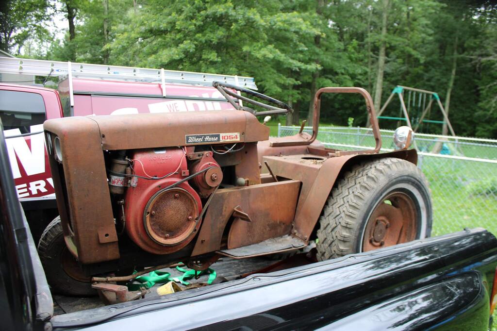

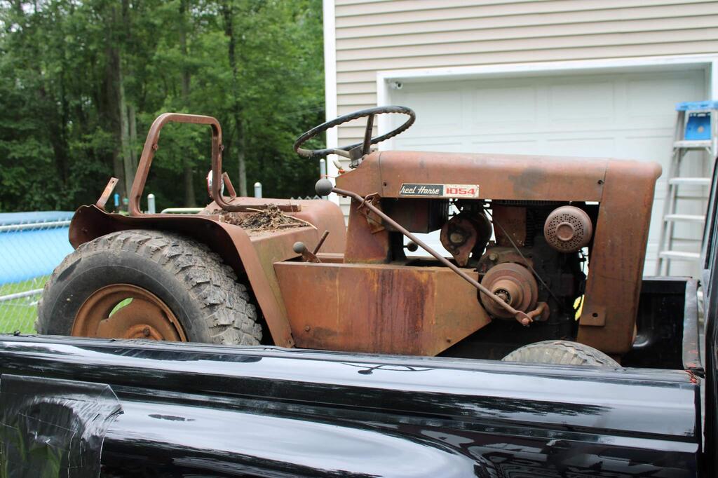

Butterscotch1054 6 #1 Posted July 17, 2021 Hey Everybody! First post. New to community. Just purchased a 1054 for $200. Deck included. But the PTO clutch bearings are shot, missing balls... any idea if i can get just the bearings without the whole clutch/pulley assembly? Thanks! -Ethan 1 1 Share this post Link to post Share on other sites
oliver2-44 9,493 #2 Posted July 17, 2021 (edited) Welcome Thats a nice patina looking tractor you found. Youll find lots of friendly help here along with a few doses of friendly ribbing. I did a search for 953 1054 PTO bearings and didn’t come up with any details. Maybe our File Moderator @gwest_ca can shed a litttle light on them. Also, Wheelhorse used standard bearings on most everything, so you should be able to take your existing bearing and seal to an industrial bearing house such as Motion Industries and have them cross reference them. Edited July 17, 2021 by oliver2-44 Share this post Link to post Share on other sites
Herder 2,354 #3 Posted July 17, 2021 Welcome to Red Square. The clutch and PTO are a bit different than the others produced in the years to follow, someone here will most likely have a part number for the bearings. Nice find!! And you beat me to it. Share this post Link to post Share on other sites

Ed Kennell 37,703 #5 Posted July 17, 2021 to the Nice find. Like Jim said, get the bearing and seal out and take it to a bearing supplier to match up. NAPA is usually willing to measure and match bearings. 1 Share this post Link to post Share on other sites
gwest_ca-(File Mod) 10,971 #6 Posted July 17, 2021 Welcome to Red Square. This may be what you have. Click on the fuzzy picture in the link. The 5196 bearing is replaced by Toro 109842 Napa 7-04250, Rotary 484, Stens 230-033, Stens HD 230-037, Generic 9504AB Remove the handle and the snap ring on the small stub shaft. Remove the snap ring holding the bearing in the pto hub. Pull the hub off the crankshaft. Use a long drift punch to drive the bearing and stub shaft out. Work some new grease into the large needle bearing but don't leave any excess in there so that it runs out under use and spoils the friction disc. Notice this is for crankshafts with 1-1/8" diameter. Some early 10hp models used a 1" diameter crankshaft. Garry 1 1 Share this post Link to post Share on other sites
squonk 40,870 #7 Posted July 17, 2021 Cheap Napa alternative # PP204RR6 About $6.00 1 1 1 Share this post Link to post Share on other sites
953 nut 54,674 #8 Posted July 17, 2021 Nice looking survivor there, most of the bearings and seals on a are standard items that can be obtained at reasonable prices. 2 1 Share this post Link to post Share on other sites

Butterscotch1054 6 #10 Posted July 17, 2021 5 hours ago, gwest_ca said: Welcome to Red Square. This may be what you have. Click on the fuzzy picture in the link. The 5196 bearing is replaced by Toro 109842 Napa 7-04250, Rotary 484, Stens 230-033, Stens HD 230-037, Generic 9504AB Remove the handle and the snap ring on the small stub shaft. Remove the snap ring holding the bearing in the pto hub. Pull the hub off the crankshaft. Use a long drift punch to drive the bearing and stub shaft out. Work some new grease into the large needle bearing but don't leave any excess in there so that it runs out under use and spoils the friction disc. Notice this is for crankshafts with 1-1/8" diameter. Some early 10hp models used a 1" diameter crankshaft. Garry Thanks Garry! Will shop around locally and measure the crankshaft to bs safe. Share this post Link to post Share on other sites
