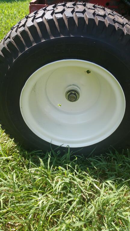

Marv 894 #1 Posted July 16, 2021 Installed new sealed bearings. Made the wheels look new. No grease on them. Marv 6 Share this post Link to post Share on other sites
