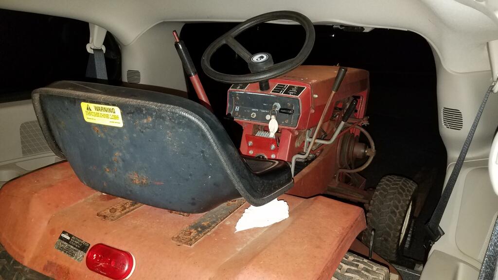

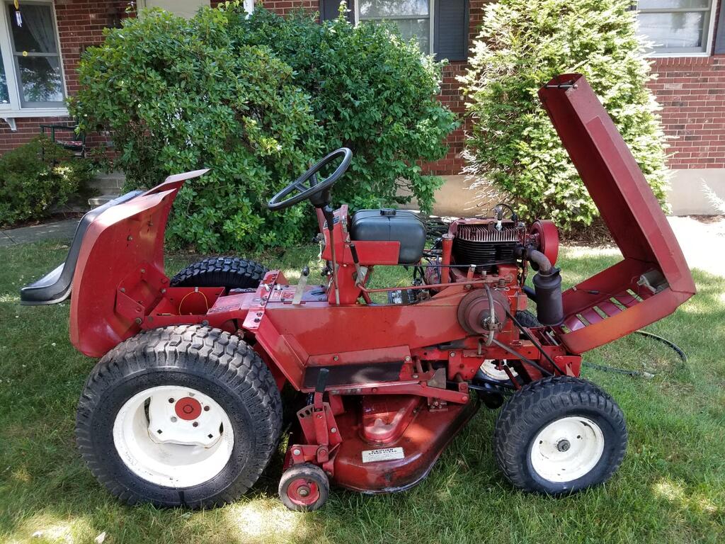

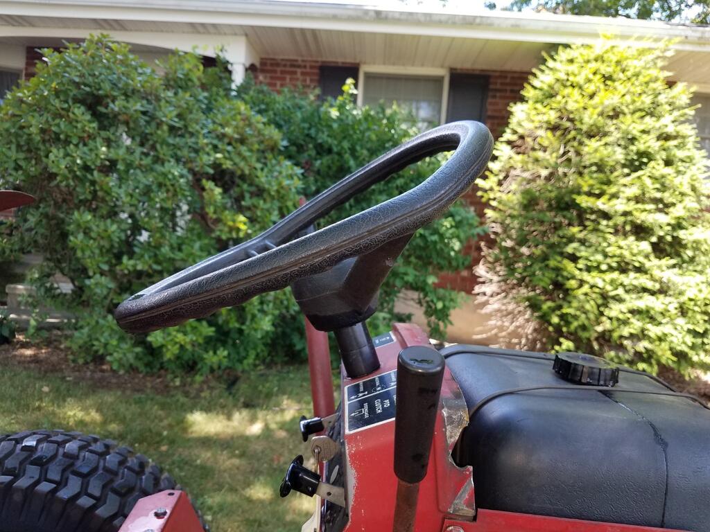

Inspectorjoe 473 #1 Posted July 2, 2021 I bought a 1974 C-120 with a bent steering wheel. I did see the damage in the listing photos, but wasn't concerned about it. Putting it into the minivan, it suddenly became a concern. Unfortunately, when the wheels are pointed forward, the wheel is bent upwards. The tractor should have barely fit through the rear opening, but the upward bend of the wheel made it a no-go. Letting the air out of the tires and some muscling got in for the ride home. Does anyone have a technique for straightening the wheel without removing it from the column? I searched here, but didn't find anything. A general internet search didn't bring up much, other than prying it with a 2X4. Share this post Link to post Share on other sites
roadapples 6,983 #2 Posted July 2, 2021 I removed the wheel and put a piece of 3/4" rod in a large vice. Slipped the wheel over the rod to hold it, then I could bend it by hand. Take your time and you can get it real close... 1 1 Share this post Link to post Share on other sites
daveoman1966 3,808 #3 Posted July 2, 2021 The two spokes don't appear to be bent but, if they are, use a BAR CLAMP parallel across them and draw the clamp until you think they are straight. I'd insulate the 'cleats' of the bar clamp with rags to preclude damage to the s/w cushion material. Having stated that, it appears to me that only one side of the s/w preimiter is bent UP. Make a loop with a chain around the now straightened spokes (rags again)...one end of a 2x4 in that loop. Now, using the 2x4 as a lever, pry DOWN on the 'up-bent' section of the s/w. You shouldn't have to pull the s/w to fix this. Share this post Link to post Share on other sites

rmaynard 15,927 #7 Posted July 2, 2021 (edited) That's a soft-touch wheel. The plastic is more like a very high density foam. It normally won't crack. The wheels made with hard plastic do crack fairly easily. I have found that leaving the steering wheel mounted is the easiest way to reshape them. That wheel was probably bent by the operator constantly pulling on it to get off and on the tractor. Steady pressure in the opposite direction and the bend should return it to a reasonably straight condition. Hold the other side of the wheel down with a ratchet strap looped behind the dash tower or completely under the frame. Edited July 2, 2021 by rmaynard 2 1 Share this post Link to post Share on other sites
8ntruck 7,391 #8 Posted July 2, 2021 Might be a good idea to brace the ends of the spokes to the dash as well. Share this post Link to post Share on other sites
Crazyredhorse 296 #9 Posted July 3, 2021 do the 2x4 but make a T one slide it in from bottom and against spokes Share this post Link to post Share on other sites
