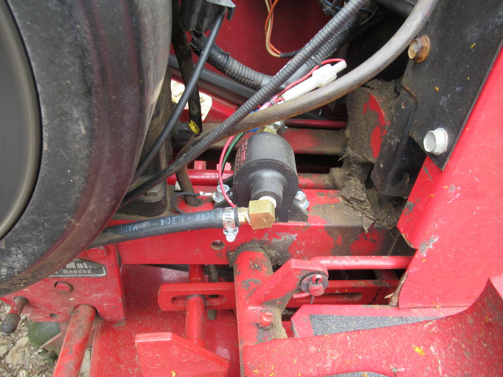

formariz 12,381 #1 Posted June 30, 2021 I see this question once in a while. For the tractors with tank under seat I mount them right on frame behind engine. There are already two holes in frame that match pump and it is below the level of tank . It’s also an easy spot to service pump if needed without having to remove anything else. 2 1 Share this post Link to post Share on other sites

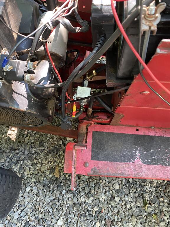

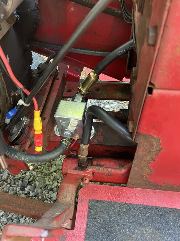

ranger 1,862 #3 Posted June 30, 2021 7 minutes ago, squonk said: Those pumps push better than pull but as long as you got a good gravity feed why not. I have a 953 that's going electric next month. Prolly put it near the tank. It would be interesting to see if there is any pressure differences between rear or front mounting an electric pump. If there is a drop in efficiency/pressure mounting further away from the tank, perhaps “el-Cheepo” pumps with maybe suspect higher pressure delivery than advertised would be better mounted closer to the carb. I doubt though, with the distances involved, there would be much, if any, difference. I have one mounted in the same place on my C121 that @formariz has his, it works fine, filter is at tank outlet. Share this post Link to post Share on other sites
oldlineman 1,802 #4 Posted June 30, 2021 That's where I put mine on my 1989 414-8 like above holes already there and easy servicing works great. Bob 2 Share this post Link to post Share on other sites
