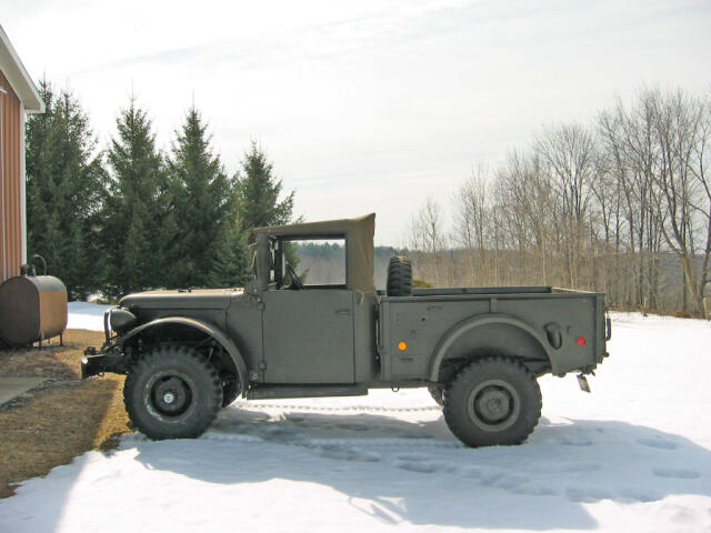

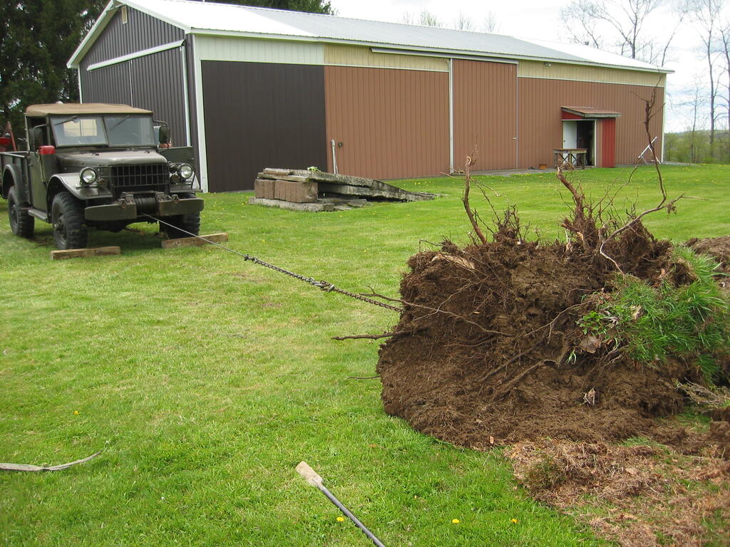

pfrederi 21,105 #22 Posted June 30, 2021 If you want reliable (fixable) Dodge 4WD you need one like mine. 4 3 1 Share this post Link to post Share on other sites
squonk 48,029 #23 Posted June 30, 2021 13 minutes ago, pfrederi said: If you want reliable (fixable) Dodge 4WD you need one like mine. That would be one heck of a ride from Wisc. to Pa! Open the door and you would be pouring Jim,Cindy and Dan out onto the ground! 1 Share this post Link to post Share on other sites
pfrederi 21,105 #24 Posted June 30, 2021 17 minutes ago, squonk said: That would be one heck of a ride from Wisc. to Pa! Open the door and you would be pouring Jim,Cindy and Dan out onto the ground! They would have the opportunity for many stops...9 mpg or so 3 Share this post Link to post Share on other sites
Achto 32,579 #25 Posted June 30, 2021 (edited) 4 hours ago, pfrederi said: They would have the opportunity for many stops...9 mpg or so About the same mileage that we got with the heavily loaded 2017 Cummins. One big difference would be that we were holding 70 + MPH. I'm guessing your truck would do about 45MPH, maybe 50MPH down hill with the clutch pushed in. Edited June 30, 2021 by Achto Share this post Link to post Share on other sites
