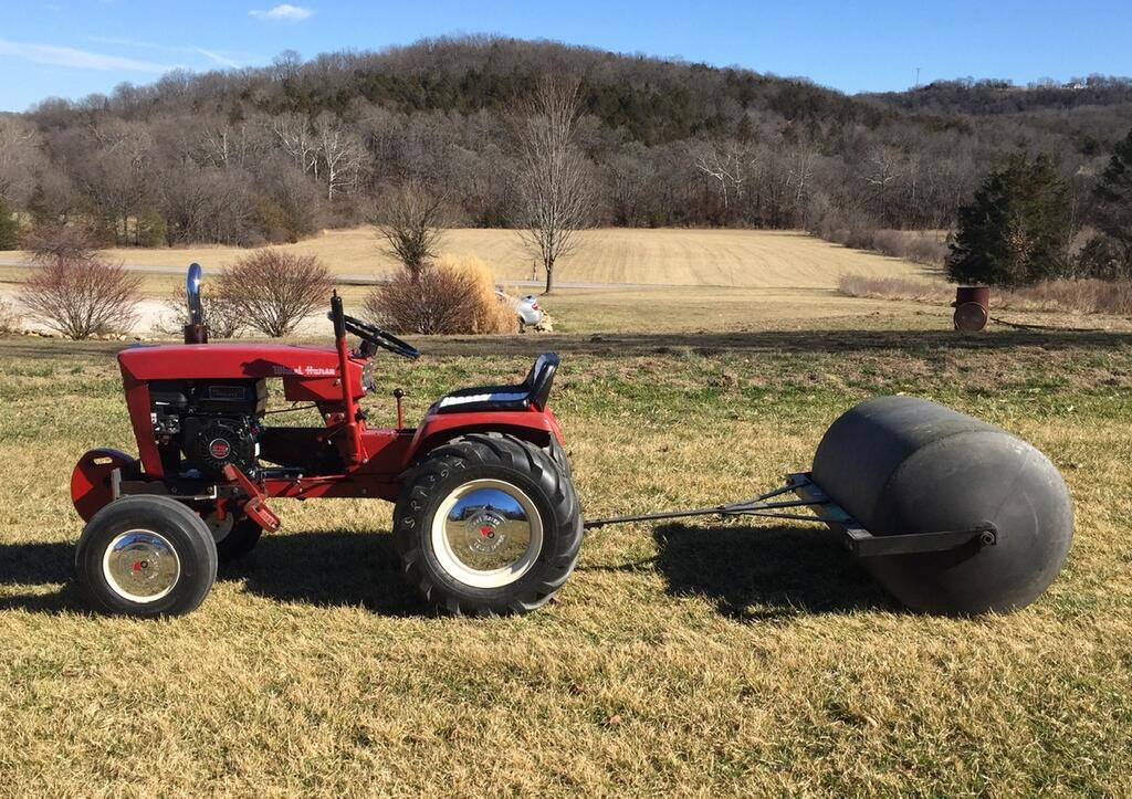

cschannuth
I absolutely love mine. I got an inexpensive roller and dad had the engine on his shelf that he never used and I put it together about four or five years ago and it has been incredible. It has tons of power and even with my oversized engine pulley it will push snow in high gear without even breathing hard. As far as their toughness, my brother bought his kids a mini bike with a Predator engine in it about 12 years ago. He’s not one for maintenance and that engine has never had the oil changed once and other than me checking it whenever my kids ride it, the oil never gets checked. It still starts on the first or second pull after all these years.  Here’s mine with a few tweaks over the years. 2686078D-779D-4312-BEDA-9C7AF97D897B.jpeg.4e4898d3fe478a3845c570ef19e2a8da.jpeg26700342-E3F6-402C-92CD-A8C8234BF57D.jpeg.d12f30efebb32decc9ca9e3671d23ddb.jpeg29A85A35-5749-4E36-90B5-841A517B4F7A.jpeg.be4097948510beb601327241169353d1.jpeg
