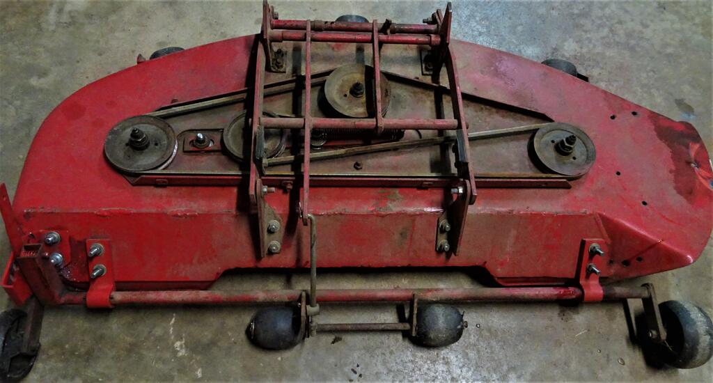

ljfarraher 16 #14 Posted June 23, 2021 I think I found an issue as to why I cannot get the foot convert to work.. On the leveler bar for a 48" deck part# 78360 is there 2 bars or 3 bars which includes the front to rear pitch bar?? Parts schematics show 2 and I have 3 welded in place on the cross bar which includes the one right under where the foot pedal would normally go. Share this post Link to post Share on other sites
Jeff-C175 7,203 #15 Posted June 23, 2021 16 minutes ago, ljfarraher said: I have 3 welded in place Pictures would really help diagnose! Share this post Link to post Share on other sites
Jeff-C175 7,203 #16 Posted June 23, 2021 20 minutes ago, ljfarraher said: leveler bar for a 48" deck part# 78360 is there 2 bars or 3 bars which includes the front to rear pitch bar?? This is an older 48" deck but I don't believe there's any substantial difference in the layout. Sorry I don't have a rear shot showing the back side more clearly... Share this post Link to post Share on other sites
ljfarraher 16 #17 Posted June 23, 2021 (edited) 7 minutes ago, Jeff-C175 said: This is an older 48" deck but I don't believe there's any substantial difference in the layout. Sorry I don't have a rear shot showing the back side more clearly... That's what I thought..dang it.. I have a 3rd bar far to the right of your deck from front to rear and the middle bar in less than 1/2 inch from the center pully grease zerk..this has to be the wrong leveller arm for this deck when this guy re-done the tractor and deck. Edited June 23, 2021 by ljfarraher 1 Share this post Link to post Share on other sites
Jeff-C175 7,203 #18 Posted June 23, 2021 23 minutes ago, ljfarraher said: I have a 3rd bar Sometimes more bars are better... like when you get thrown out of one, you go down the road a piece to another. Can't you show us a picture? 1 2 Share this post Link to post Share on other sites
ljfarraher 16 #19 Posted June 23, 2021 4 minutes ago, Jeff-C175 said: Sometimes more bars are better... like when you get thrown out of one, you go down the road a piece to another. Can't you show us a picture? My town..ran outta bars..gotta quit getting thrown out so much.. Anyway..deck still under so hard to get pics and in middle of a cluster to clean and make room to get it off for pics.. Think I'm going to get an original and replace so I can use the pedal conversion. Only $90 so not bad to finish my project. 1 Share this post Link to post Share on other sites

Lee1977 6,874 #23 Posted March 22, 2022 The third bar is for the vacuum powered by the deck pulley to keep it level. I added the third bar to my deck to keep it level when the vacuum is on, mine isn't power by the beck but wanted to hang down with the hose and chute is on Is this the bar your deck has. Share this post Link to post Share on other sites

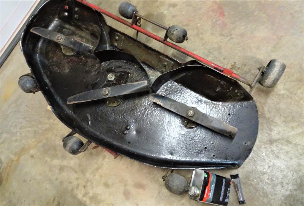

giddyap 1,569 #24 Posted April 8, 2022 On 6/23/2021 at 12:43 PM, ljfarraher said: Sorry I don't have a rear shot showing the back side more clearly... Is this the rear shot you speak of? This deck is new to me, the previous owner welded a plate all the way across. It's the best deck I've seen so I decided to undercoat it. At half the cost of POR-15 I used fiberglass resin . Share this post Link to post Share on other sites
