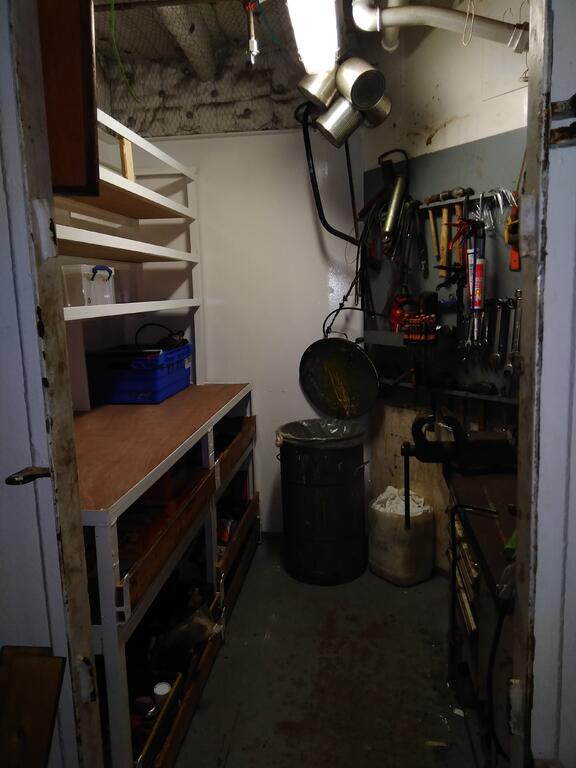

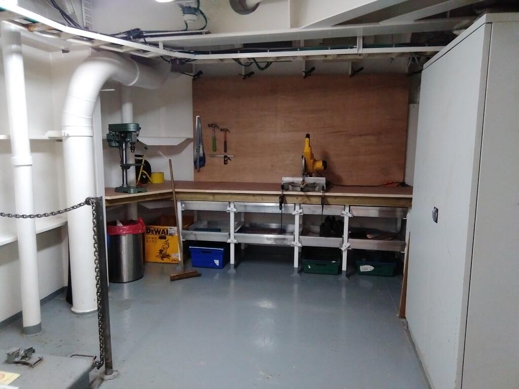

Dan.gerous 2,696 #1 Posted June 17, 2021 (edited) Just got home from a very busy trip away - got a ton of work done on the ship, but only managed about four hours sleep a day in two short bursts! After complaining that I had no woodwork shop onboard, but was expected to do a lot of repairs, the company finally let me have one in an otherwise badly used space. Unfortunately they got a shore company to build it, and it was awful! It was 1m high, too narrow, had a vice mounted in a corner that was effectively unusable and featured the worst storage drawers i have ever used. The top also had metal raised edges- not very handy for wood tools. I started the trip with cutting equipment in hand and removed the brand new incorrect top, and at the same time reducing the height so I could put a more user friendly top on. Then cut out some of the awful drawers and moved them to one side in a slightly more useful stack. Lots more to do as I want cupboards to hide the mess of tools rather than an open front. See attached pictures of the project from it's humble origins as a locker space. More to follow as I also built a second workshop this last trip.... Edited June 17, 2021 by Dan.gerous 11 8 Share this post Link to post Share on other sites
peter lena 9,093 #2 Posted June 17, 2021 @Dan.gerous , good going on that dan , shows interest and get it done attitude, we often would set up a mini shop in various buildings and decks , so we always had a go to point . made any call much easier . retired 24 / millwright at PFIZER , INC . pete 2 Share this post Link to post Share on other sites
seuadr 489 #3 Posted June 17, 2021 very nice! as a "shore person" i would never have thought of the toggles to keep the drawers closed - of course when i see them it makes perfect sense... 3 Share this post Link to post Share on other sites
Dan.gerous 2,696 #4 Posted June 17, 2021 1 hour ago, seuadr said: very nice! as a "shore person" i would never have thought of the toggles to keep the drawers closed - of course when i see them it makes perfect sense... The shadow board has to hold tools as the ship moves from side to side - not as easy as putting a screw in to hold something! The vibration down there is something else again - when we are coming into port each morning some of the equipment falls apart like the little square and the mitre saw. I was bored at 4am the other day so spent the two hours before we tied up finishing a project. The vibration was that bad that I could barely draw a pencil line, and everytime you put a tool down it would vibrate away out of reach! Its ok though as I generally do my work while we are alongside each day. 2 Share this post Link to post Share on other sites
Dan.gerous 2,696 #5 Posted June 17, 2021 3 hours ago, peter lena said: @Dan.gerous , good going on that dan , shows interest and get it done attitude, we often would set up a mini shop in various buildings and decks , so we always had a go to point . made any call much easier . retired 24 / millwright at PFIZER , INC . pete I cant bellieve the ship has operated for 18 years without a chippy shop - I'm not one for accepting things as they are, always striving to improve my workplace! also its a nice place to do my own stuff - instead of turning my cabin into a woodwork shop like I normally do. 1 Share this post Link to post Share on other sites
Dan.gerous 2,696 #6 Posted June 17, 2021 1 hour ago, seuadr said: very nice! as a "shore person" i would never have thought of the toggles to keep the drawers closed - of course when i see them it makes perfect sense... The drawers dont stay closed long without something to secure them. Those toggles are awful and will be in the rubbish bin as I carry on with improvements - you need three hands to open a drawer at the moment. I guess it must be unusual as a shore person, we have to think in a third dimension for everything - even putting your coffee cup down is a bad idea, just hold it until you finish drinking unless you want to clean up a mess. Having a shower can be entertaining as the water moves all over the place on a really rough night. 4 Share this post Link to post Share on other sites
Handy Don 13,340 #7 Posted June 17, 2021 I especially like the countertop lip that lets you clamp down tools like the miter saw, drill press, and even the vise. I've been noodling how to convert a nice oak tabletop I salvaged years ago into a nice worktable and that idea will definitely be part of it! As for drawers, some of the stronger nylon child-proofing drawer latches may work for you--not too expensive, no rust, and most work one-handed. 3 Share this post Link to post Share on other sites

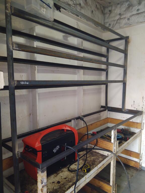

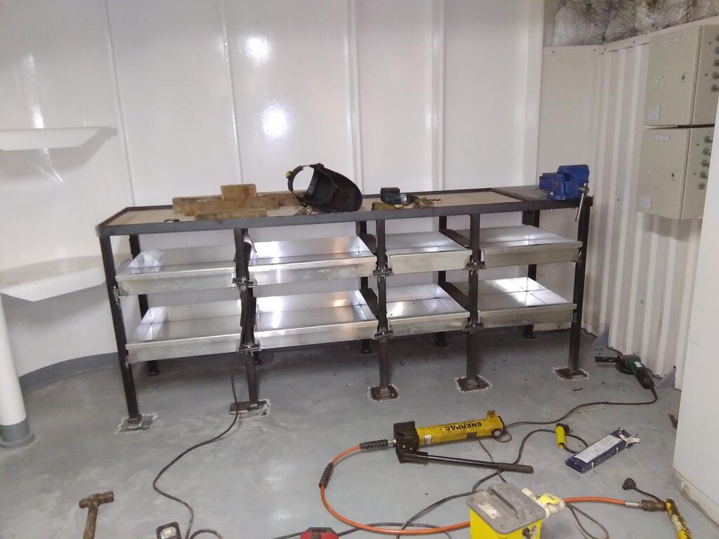

Dan.gerous 2,696 #9 Posted June 17, 2021 My second workshop project last trip involved rebuilding our pathetic deck workshop. You can see from the picture that is quite small with only about a metre of workbench. Not a great size considering the ship is 125m long. I removed the full height shelves to one side, cut them down to bench height, then rebuilt narrower shelves onto the new bench. The scrap shelves were then welded together and mounted in another compartment - so nothing was wasted. We now have lots of bench space, useful storage, and order in what was a terrible area. Certainly getting plenty of welding practice in, although I am still not very good! 4 3 Share this post Link to post Share on other sites

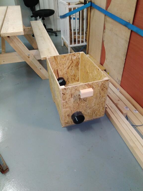

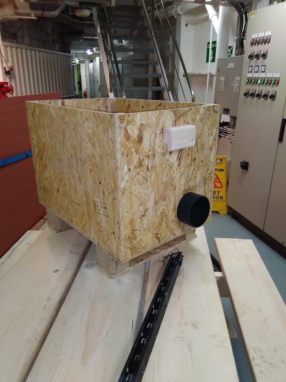

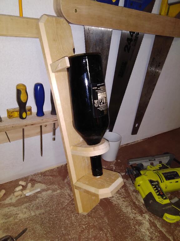

Dan.gerous 2,696 #11 Posted June 18, 2021 The next two jobs in the woodwork shop were both favours for crew members. The first is a soundproof box for a bit mining machine. Apparently it's so noisy they are worried the neighbors will complain! Anyway, he now has the wooden box and just needs to add insulation and the ventilation fans into the large holes. The other quick project is a bird feeder made from a Bailey's bottle. The guy wanted it as a present for his elderly neighbour. Was so simple to build, a pleasant time filler. My next goal is to teach all these people some basic skills so that can make their own stuff! I don't know why they think I have so much free time, I am flat out 24/7 as it is, unlike most of them who just do the minimum and no more. 4 1 Share this post Link to post Share on other sites

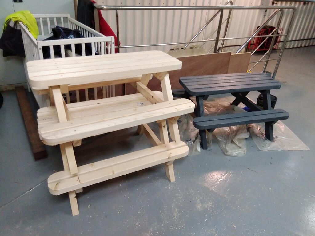

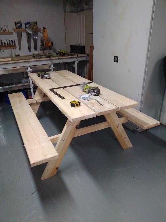

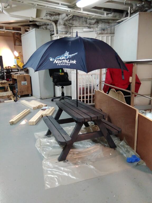

Dan.gerous 2,696 #19 Posted July 12, 2021 The second project was a half scale replica of the picnic table for our hotel directors grand children in Edinburgh. I have been asked to make two more..... Was good fun and only took about three hours. 7 2 Share this post Link to post Share on other sites
Stormin 9,983 #20 Posted July 12, 2021 BTW On 6/18/2021 at 7:35 AM, Dan.gerous said: I hope that's fastened down, Dan. You don't want to here the cry, "PICNIC BENCH OVERBOARD". 1 4 Share this post Link to post Share on other sites
Dan.gerous 2,696 #21 Posted July 12, 2021 59 minutes ago, Stormin said: BTW I hope that's fastened down, Dan. You don't want to here the cry, "PICNIC BENCH OVERBOARD". Would you believe that we didn't actually bother securing it, makes it more exciting as it's always in a different place each morning. 2 Share this post Link to post Share on other sites
