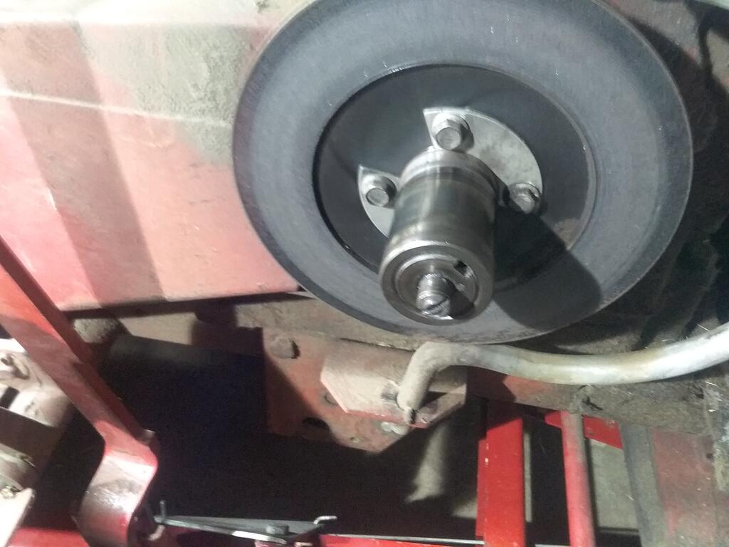

I'm replacing my clutch plate under my pto bell. What is the torque of the four bolts that hold it to the drive pulley? 100 and 400 series. Thanks.
WHX??
I don't think there is a WH spec so I would just go with what spec those bolts are. 1/4-20 aren't they?

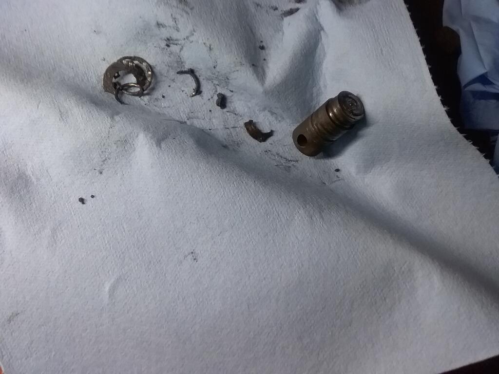

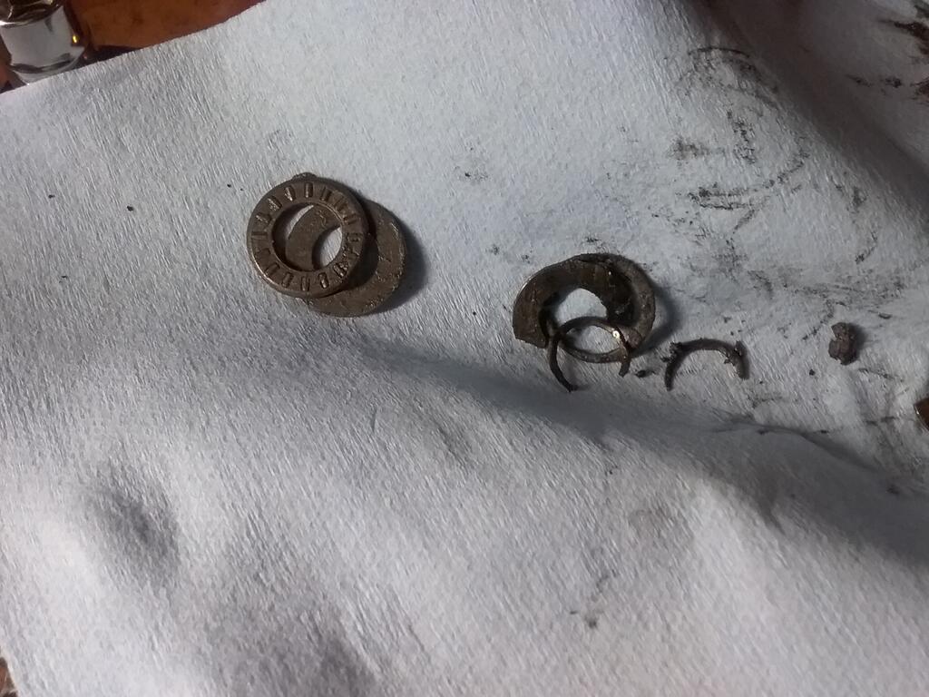

Thanks. Found this inside of PTO. Looked over the pdf and the flat head at the end of the PTO is not in the file. Is the PTO shaft damaged?
gwest_ca
Get a new pto shaft #33 and bearing plus 2 retaining rings and forget those internal parts. The new shaft will pull the bell out because of the 2nd retaining ring.

5196 has been superseded by 109842 . The old pto shaft looks badly worn so figured the bearing inner race is also. If the bearing is OK reuse it.
