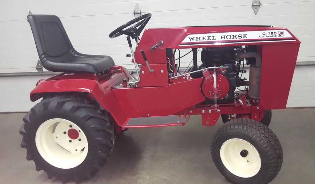

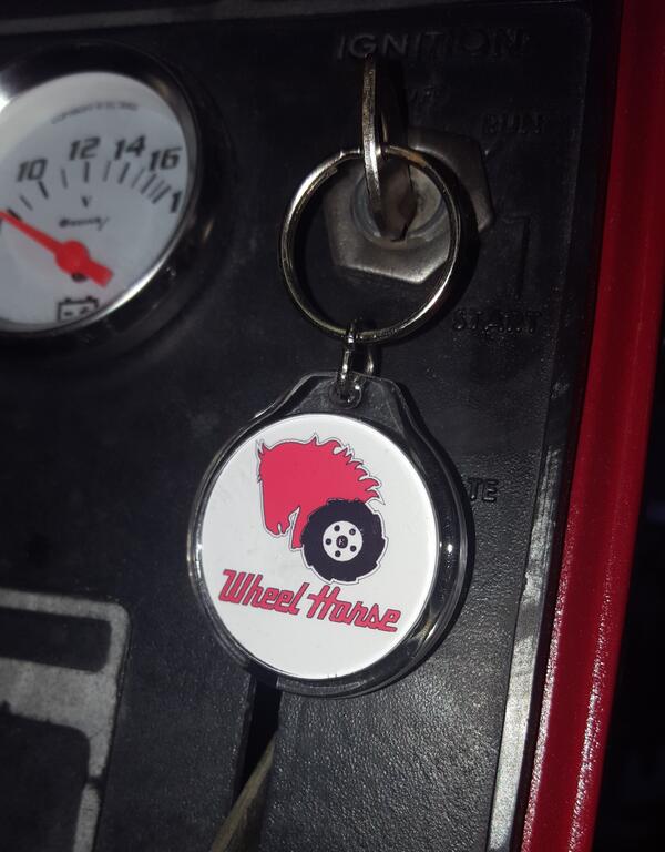

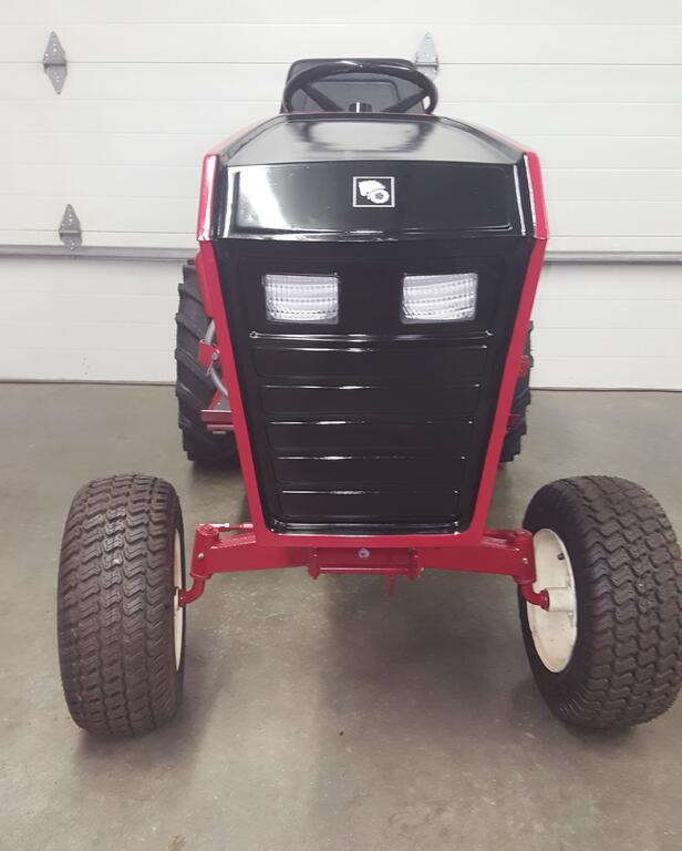

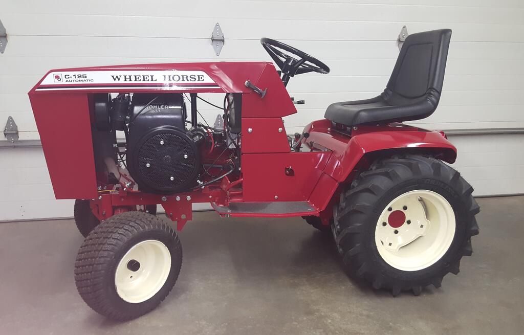

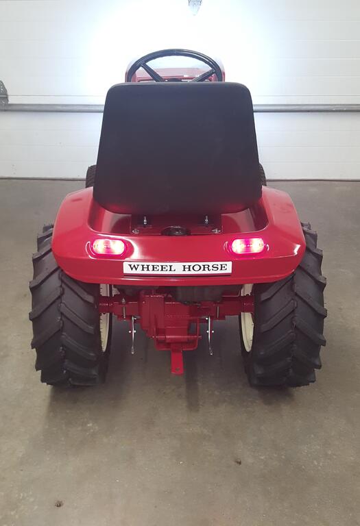

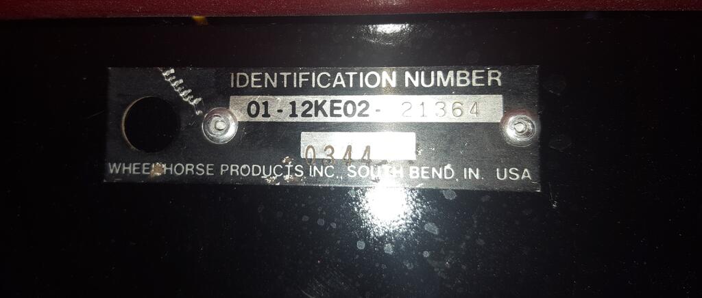

Gregor 4,847 #6 Posted June 15, 2021 The serial number tag, and the key chain are on the C-125A. That means it's officially done. I believe the tractor is VERY sound mechanically. As with all my tractors there are places where the paint could be better, but then there are a lot of places where it could be worse. I did some re-paint after the gas can fiasco, I think it turned out OK. I got the "creep" adjusted out of the trans, so it's fine now. The motor starts immediately, and sounds great. To me anyway. Now that it's done, it's time to move on to the 175. 6 13 1 Share this post Link to post Share on other sites
