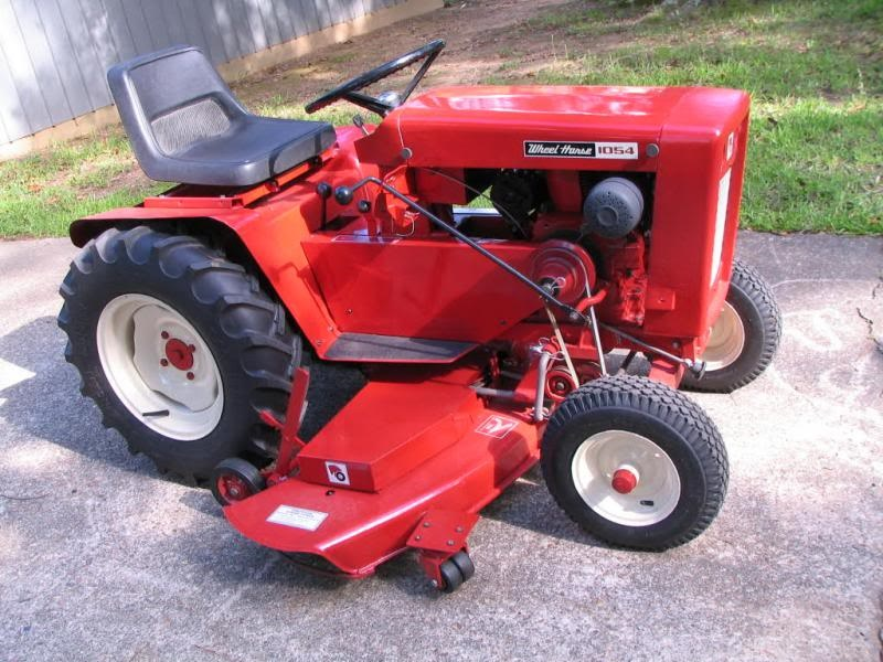

And I agree with that ---- but, oddly enough one of my early buys when getting the Horse bite was a 1054 out back in the weeds (which of course had the 10hp) was from an elderly gentleman who had bought it new --- with a 48" deck! I got her all slicked up and running good and used the deck .... briefly, and pretty quickly felt it was struggling a bit. I didnt need another tractor and ran a quick CL ad and a fella with lake front property with a pretty steep climb from lake to house and he was using a -- unknown -- with turf tires and they just wasnt getting it. I had added new ags to the horse and that convinced him. Have often wondered how that worked out.
I seldom regret selling one, but I kinda wish I'd have hung on to that one:crying-yellow:

That's a beautiful tractor pacer. I hope it all turned out for him.

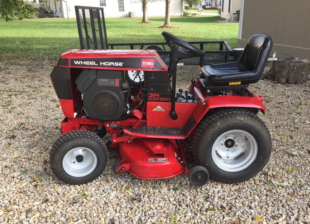

My 275 hour, like new, runs perfect, 314-8 doesn’t pull a 42 inch deck like I thought it would so I would say a 10 horse would be a real pain in the butt. I am used to my 16 horse twin Briggs and a 20 horse Onan so I’m probably spoiled.FD905F45-4EC5-451F-A542-57CEDEA9D988.jpeg.6fa4fddb6c3667209e4ed95e5c3fc28b.jpeg
