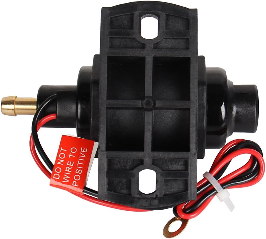

peter lena 9,556 #1 Posted June 8, 2021 https://www.amazon.com/CarBole-Electric-Gasoline-Universal-Operating/dp/B01B7DCQA0, been using this on c-85 , 12hp magnum swap , very solid and reliable unit , great price , mounted just in front of engine , on frame , near original pump mount . silent , reliable , might change my other 2 horses over to the same , pete Share this post Link to post Share on other sites
pacer 3,177 #2 Posted June 8, 2021 Havent seen that one, similar appearance/shape to the round ones on the bay, of which I had used several of and liked them - but for whatever reason the last 3 that I got failed after 3-4 weeks, so couple yrs ago I switched to the 'Facet' square shaped pumps and havent had any problem with them (and, they are imports in the under $20 range) I had to do a closer look at that tab saying 'dont use on positive' - first glance looked like the tab was on the red!! Keep us/me in mind if it fails or any problems, I wouldnt mind switching back to that design. 1 Share this post Link to post Share on other sites

lynnmor 8,254 #7 Posted June 9, 2021 Since that pump has 5/16" nipples and one review has a photo showing that the nipple pulls out easily, I won't be buying. Share this post Link to post Share on other sites
roadapples 6,985 #8 Posted June 9, 2021 4 hours ago, peter lena said: @roadapples , this the model i have , https://www.amazon.com/dp/B01B7DCO6Q/ref=twister_B07BMQJV3H?_encoding=UTF8&psc=1 , lowest pressure , with no issues , pete Ok, the one on your first post went to 7psi. From what I've learned on here, don't go over 4psi. Thanks for clarifying.... Share this post Link to post Share on other sites

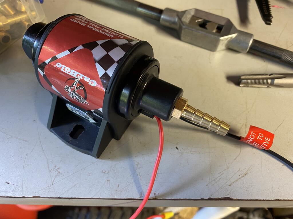

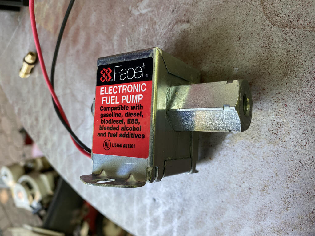

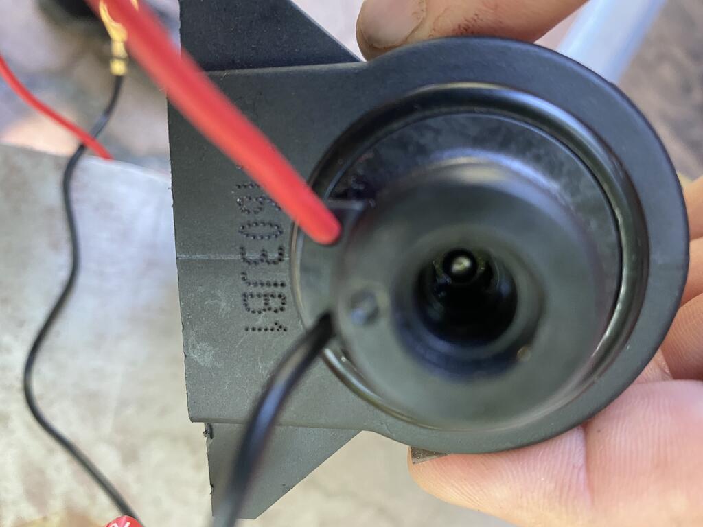

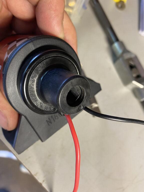

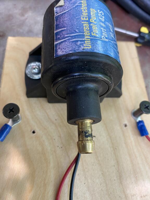

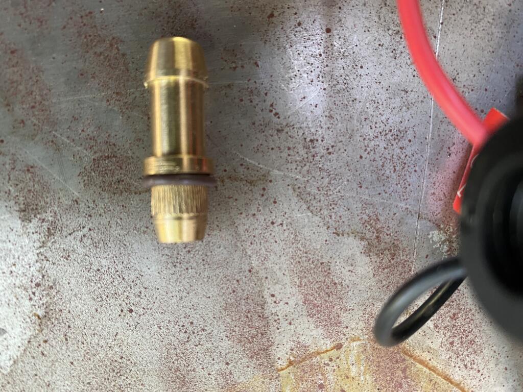

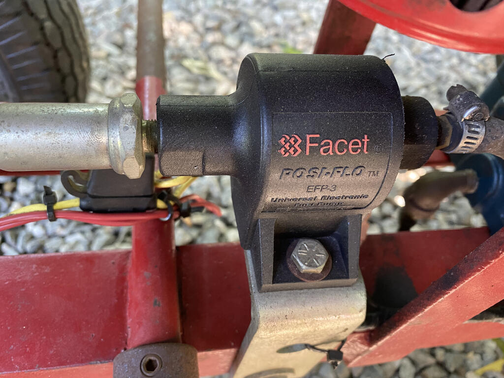

formariz 12,352 #23 Posted June 30, 2021 (edited) So following up on my complaining I correct my previous statement that pump’s body is unmarked. It is marked. It does however put out excessive pressure for my tractors. Changed carburetor to another one with float set within specs and within seconds fuel was flowing out of carburetor. Below are photos of a similar design Facett. The outlet fitting is threaded in to it as opposed to this one which is a vertical ridged brass fitting pressed into a plastic receptacle with an o ring seal. Considering that many times these pumps go in awkward places to get to and fuel lines need to be changed this is a disaster waiting to happen specially if it is used on a car. You have two totally different materials with different contraction and expansion properties connected together without a real positive mechanical connection. Such connection only has strength being pushed into pump and none being pulled out or sideways stress. The Facett is clearly a superior design taking all of that into account by using a threaded fitting on both ends which can also be changed to one such as a 90 for more installation flexibility. Amazing that when copying the design they decided to skip on probably the most important part. I have here another similar generic pump used to move kerosene that I just checked since it is also a pressed in fitting. Pump’s fitting has never been subjected to stress and yet when stressed by hand sideways it moves enough to create concern. A stuck on fuel line needing replacement in an award place most likely will remove it from the housing. Any twisting of a stuck fuel line on the fitting to loosen it can also cause fitting to also twist and strip housing. The other pump shown is what I use . I have four of them in use for years this thing is essentially physically indestructible. Interior workings so far in all of these years have proven 100% reliable. Edited June 30, 2021 by formariz 4 Share this post Link to post Share on other sites

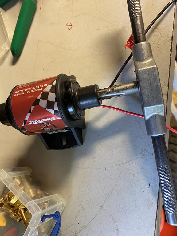

formariz 12,352 #24 Posted June 30, 2021 Since pump was toast anyway and not wanting to go through the aggravation of returning it for a $20.00 refund I decided to improve it by tapping a barbed fitting into it. Tested it and no leaks. It’s a stronger connection between the two material than it originally had. When twisting a stuck fuel line it will not strip. I will be using it as a transfer pump . 1 Share this post Link to post Share on other sites
