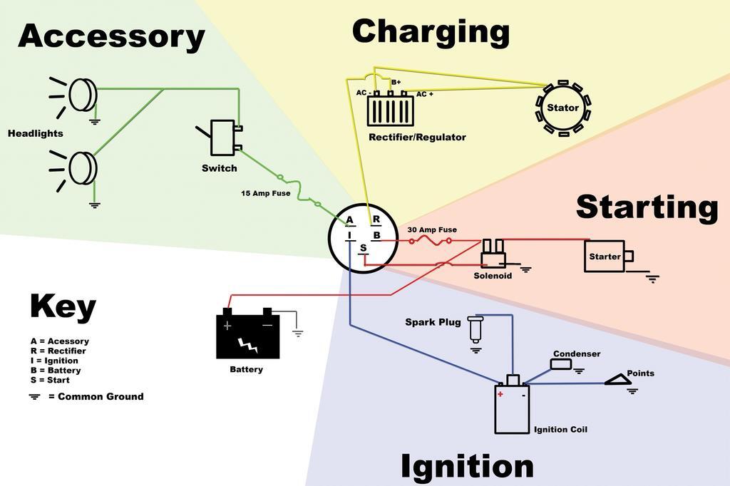

953 nut 56,741 #12 Posted June 7, 2021 Your Ignition coil needs to be internally resisted or it will shorten the life of your ignition points significantly. The drawing below uses the 103-990 switch and shows what components interact with each-other. 1 1 Share this post Link to post Share on other sites
Jrain 276 #13 Posted June 7, 2021 You guys are great thank you for all the input . I do believe that I did purchase the incorrect switch , So I ordered the correct switch that has S B R I A terminals Part # 103990, 111216 Lesco 050102 , Handy Don you are correct I had bought from Tractor Supply the M type switch , I had no prior knowledge there where so many different types for tractor key switches . 953 Nut that is the diagram I used and also found PDF manual for 1974 wheel Horse C120 witch is same model and year this tractor is to compare wiring diagrams . I will admit I am not a tractor guy and will be looking and asking here a lot . I should have the new switch in a couple of days ,I will report back and let you know . Again Big thank to all. 2 Share this post Link to post Share on other sites
