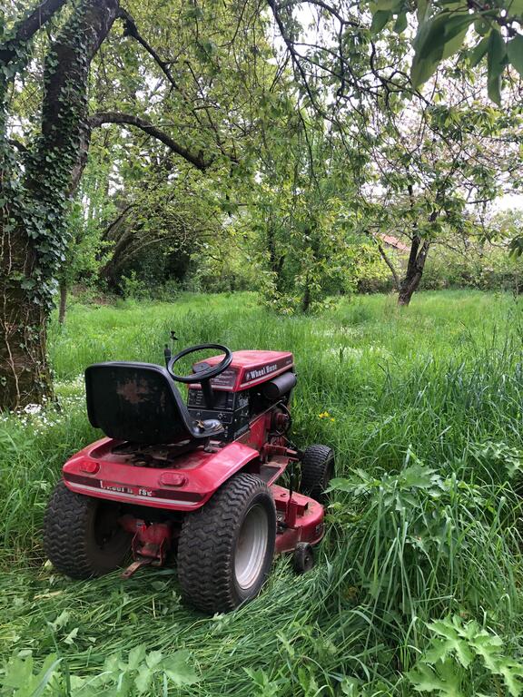

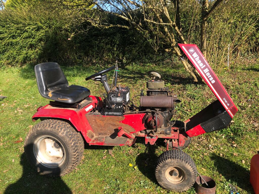

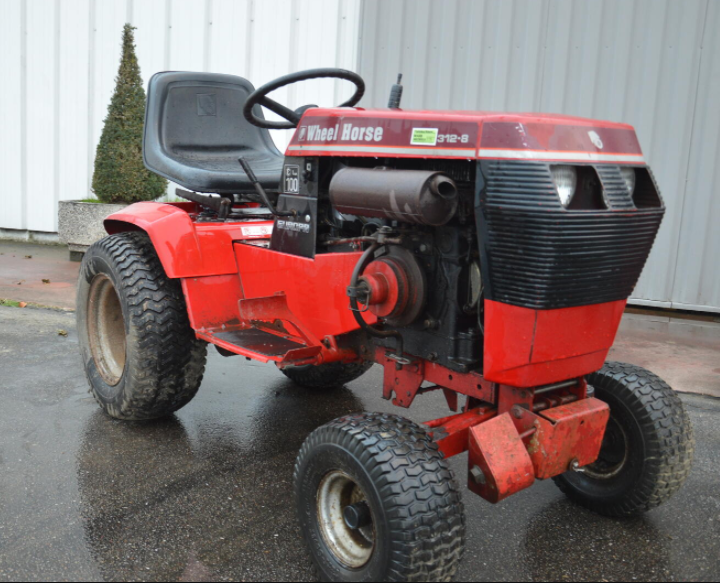

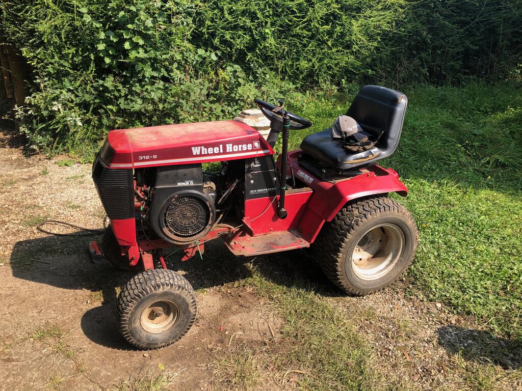

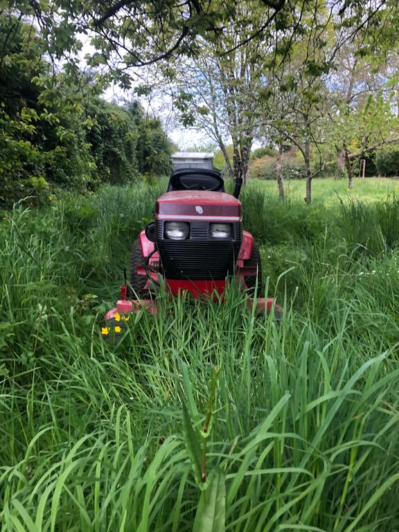

syncar 18 #11 Posted June 4, 2021 (edited) Thank you all for your welcome On 5/28/2021 at 4:56 PM, Gregor said: That happens a lot. What is the model number of your motor? It is a Kohler Magnum 12HP with mechanical fuel pump On 5/28/2021 at 5:03 PM, Maxwell-8 said: on Greetings from Belgium D'où venez-vous en France ? We have little running Wheel Horses here in Belgium too. Nobody realizes the value from these Kohler powered tractors. Pouvez-vous nous envoyer une photo de votre tracteur ? Bonjour cher voisin ! I am in Brittany, a bit far from Belgium une fois On 5/29/2021 at 1:33 AM, 953 nut said: Many of us have changed over to an electric fuel pump for greater reliability. I read a lot about it, but gave an aftermarket mechanical fuel pump a try (Kohler #4755911S) Unfortunately after a few days of work it loses prime and I had no time to put my hands on the machine once again Please enjoy the pictures attached, showing the poor condition of the tractor & back to work. Be reassured it is now in loving hands Other than the fuel pump, my concern is on the mower deck which is a 1997 42" rear discharge deck Toro #78350 (subject of an other topic) Edited June 4, 2021 by syncar 1 4 Share this post Link to post Share on other sites
Maxwell-8 4,370 #12 Posted June 4, 2021 Good worker tractor! That deck doesn't look to bad... With prime you mean spark? That is most likely a bad safety switch. Share this post Link to post Share on other sites

Tractorhead 9,215 #15 Posted June 4, 2021 Hi, i would check in follow Order: 1. open the Carb bowl and check, i there is some crud in - if yes, clean it. 2. get a clean and filled Fuelcanister with a Clear testline and check, if it will work than continusely a full canister long. If not, the problems can be in the Carb bowl valve. 3. Check the original fuel tank, If you remove the Fuelpump, check if it runs completely out with a good flow. if not maybe your Tank outlet is clogged. - clean the Fueltank. if all that works fine, the last issue will be the Fuelpump itself. if possible check the Fuelpump if it can be disassembled. if so, disassemble it and check the internal diaphragma for cracks, it is sometimes just litttle riped what is a cause of the Fail. Some of the Fuelpumps cant be disassembled. -> exchange. I did the Enginefuelpump rework on our Landlady‘s Mower, it had a suction fuelpump, after change the broken diaphragma with a thin rubberfoil it works again like a charme. Btw. Great Rig you have, great Worker but the Grass height i see on the Picts, can be a fight with the Elements for the Deck. Share this post Link to post Share on other sites
