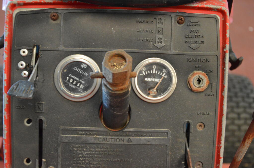

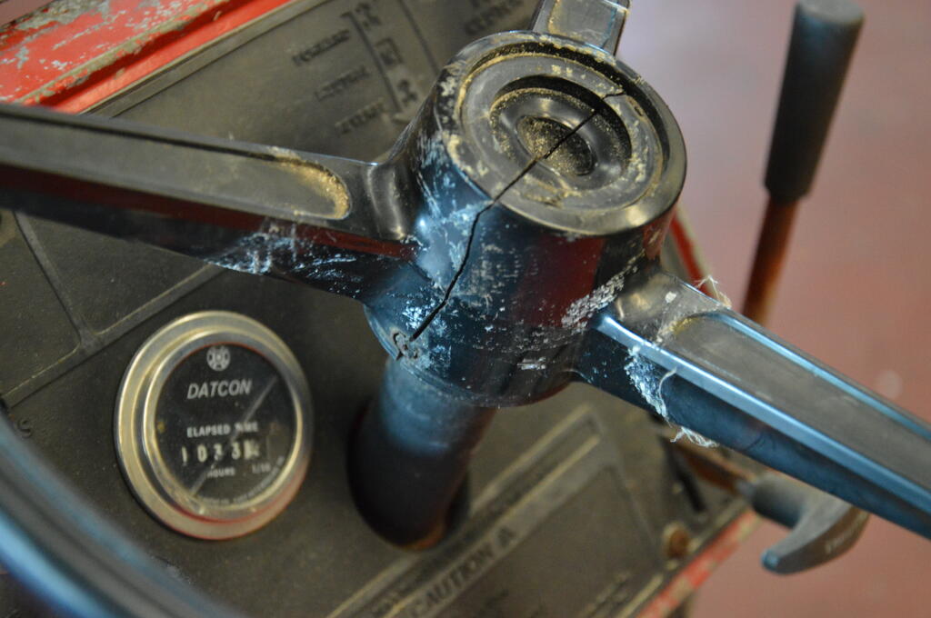

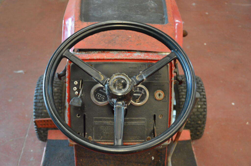

Behind all the deck tape I found the remains of a failed attempt to remove the steering wheel. Do not know why they want to remove it as there is minimal steering-play.
May try reuse this steering wheel or probably take one of the donor tractor. Do got to say those steering shafts are beefy compared to riding mowers/ lawn tractors.
  • Like 1
Damien Walker
Hmm yes! From my experience, steering wheel removal is extremely difficult and is best attempted on the bench with the column and dashboard assembly removed from the tractor (so you can support the wheel against the pin removing hammer blows). It may be possible to make a tool to press the pin out in situ, but I haven't achieved this yet. The three spoke C Series wheels are the best in my opinion, the later 'automotive' style appear to have a fixing boss made out of the finest cheese which wears/spreads open with use, making the wheel a sloppy fit.
There is often an additional problem after you have removed the pin.. the wheel can be seized onto the column. I had to remove the wheel centre cap, drill through the plastic in the centre of the wheel and press the shaft out in a hydraulic press. This also meant cutting the shaft to remove it from the dashboard so that it would fit into the press.
You are probably aware that materials to rebuild such damage are available but it would obviously be easier to simply buy another wheel.
  • Thanks 1

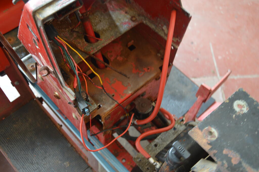

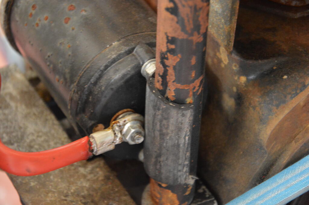

So I did a rewire on the C175, thicker wires, bigger solenoide, new ignition switch.
All connections are crimped and soldered, then shrinktubed. New starter use powerfull and gets that engine spinning fast.

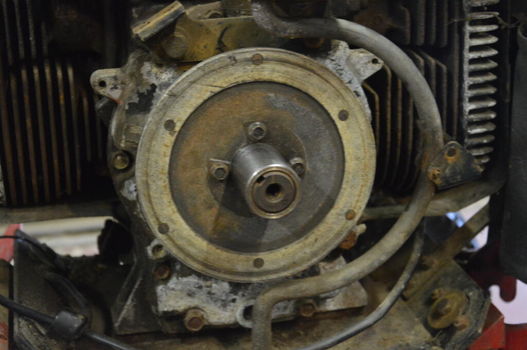

But I am not getting any power on on the charging cables, no power on the rectifier so the flywheel will have to come off.

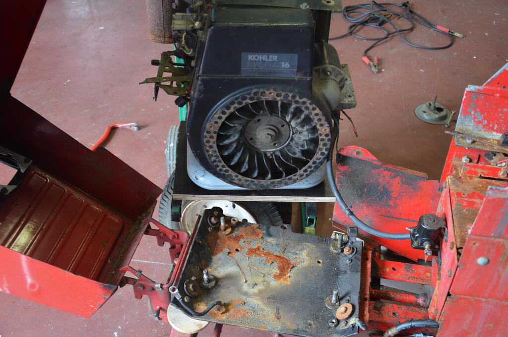

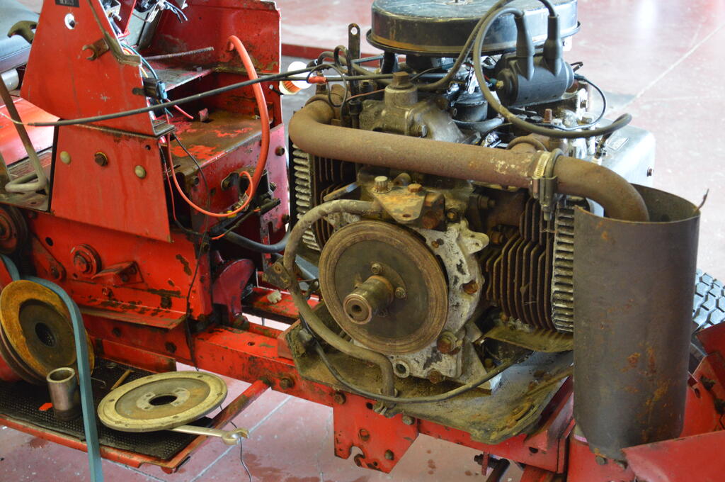

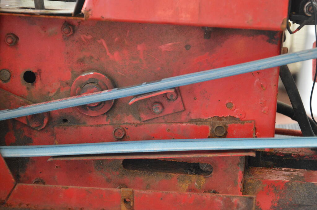

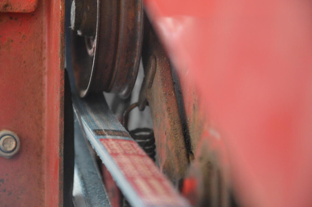

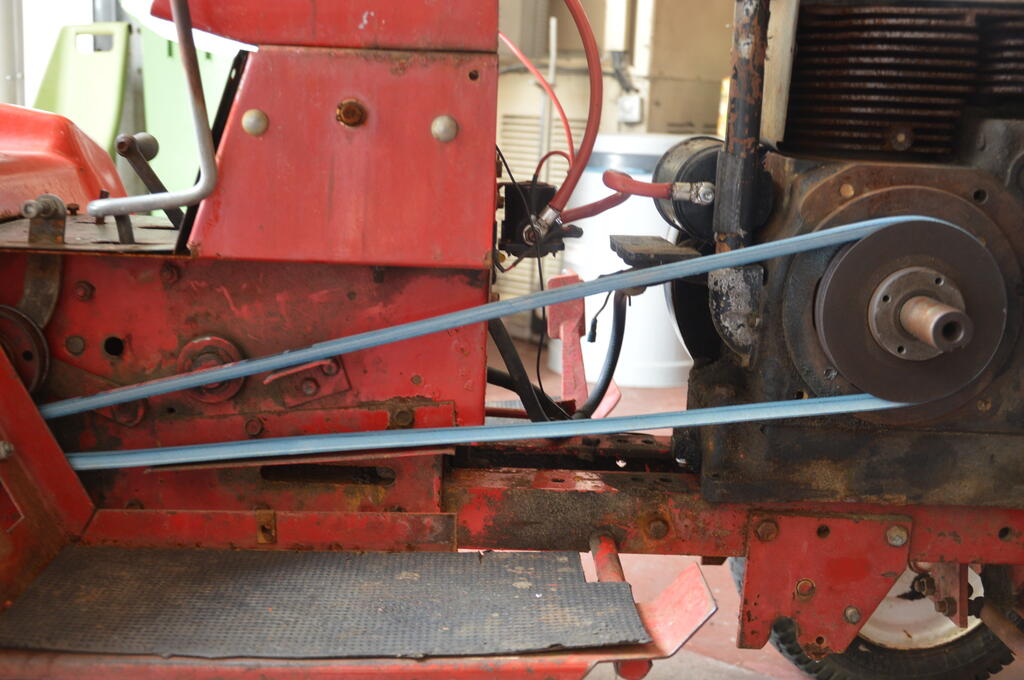

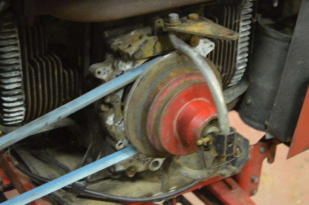

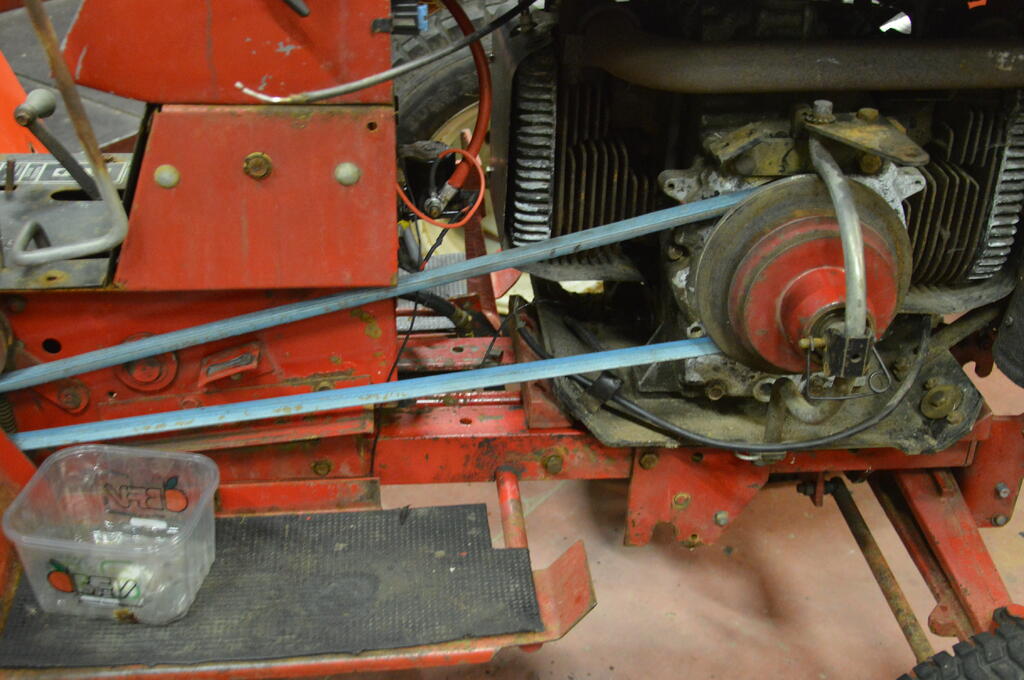

Got the correct belt in the mail today, but have to issues.
first up, I moved the engine of the shaker plate and this oilpan didn't had any treads nor holes in the bottom for the right engine to chassis bolts. She is only hooked up with 2 bolts now.
Second, the engine sits a hair to low looking at the belt path.
DSC_1208.JPG.184e6f692fc50831a17f76c6ae51db5e.JPGDSC_1209.JPG.02584e385e482a606128687aab1d6298.JPG
This may explain the belt slipping of the tensioner pulley

You could use some J bolts on the side that over hangs the frame.   ;)
  • Thanks 1
Handy Don
Onan's use a fixed (i.e. non-shaker) engine plate with separate bolts for engine and frame to solve the frame offset. That also adds a bit of vertical displacement.
  • Thanks 1
Gregor
I have my C-125 Automatic, and my unfinished C-175 Automatic in my garage. I can't speak for the Onan engine, but the 17HP Kohler, and shaker plate, has been removed from my C-175, and replaced with a B&S 18HP Twin, with a mounting plate bolted directly to the frame. My C-125 still has the shaker plate. The rubber mounts have been replaced with the machined aluminum mounts. The vertical difference between the bottom of the oil pan, and the tractor frame, is less than 1/2". As best I can measure it anyway.  The belt guard still fits fine, but on these tractors, the belt guard does not bolt to the motor itself.
  • Thanks 1
Handy Don
We are assuming that the engine is in the correct place fore-aft and the correct drive belt is installed, right?
If the belt is too long and the engine too far forward, the belt will look low.

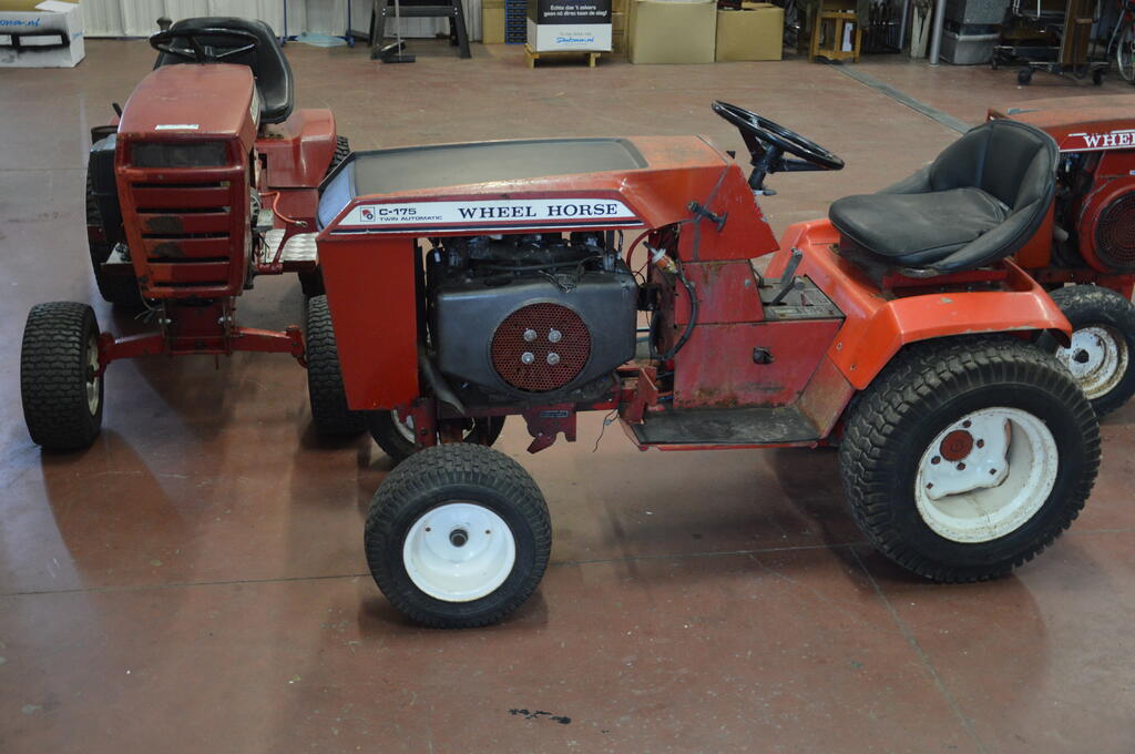

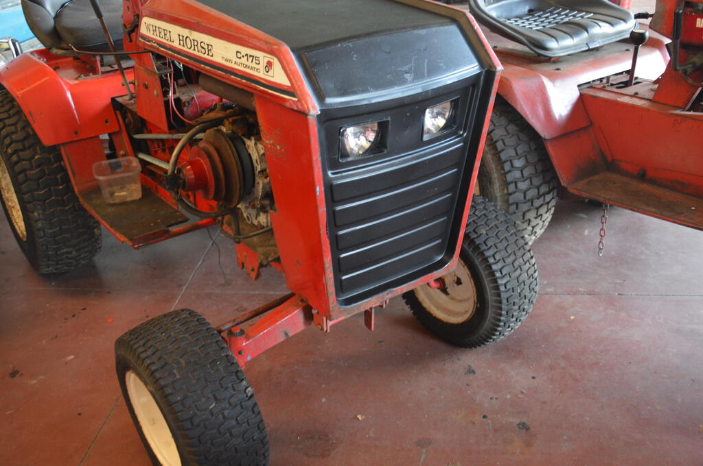

Maxwell-8

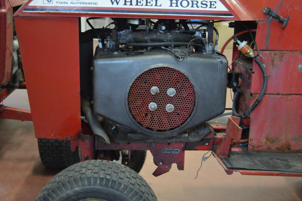

Out with the M16 and in with the kt16 which purrs like a kitten. it is a series 1 but doesn't burn nor leak a drop of oil.
The engine block is heavier then me, 70kg/155pounds, I am 60kg/160pound.My back didn't like that to much.
The engine bolted right in, the belt was an oem size, so fits perfect as well. :text-woo:
the engine looks like it has find his home!:greetings-clappingyellow:
  • Like 3
  • Excellent 2
Handy Don
Oh yeah, that's a good look. Glad it went smoothly.
BTW, start thinking about a hoist!
  • Thanks 1

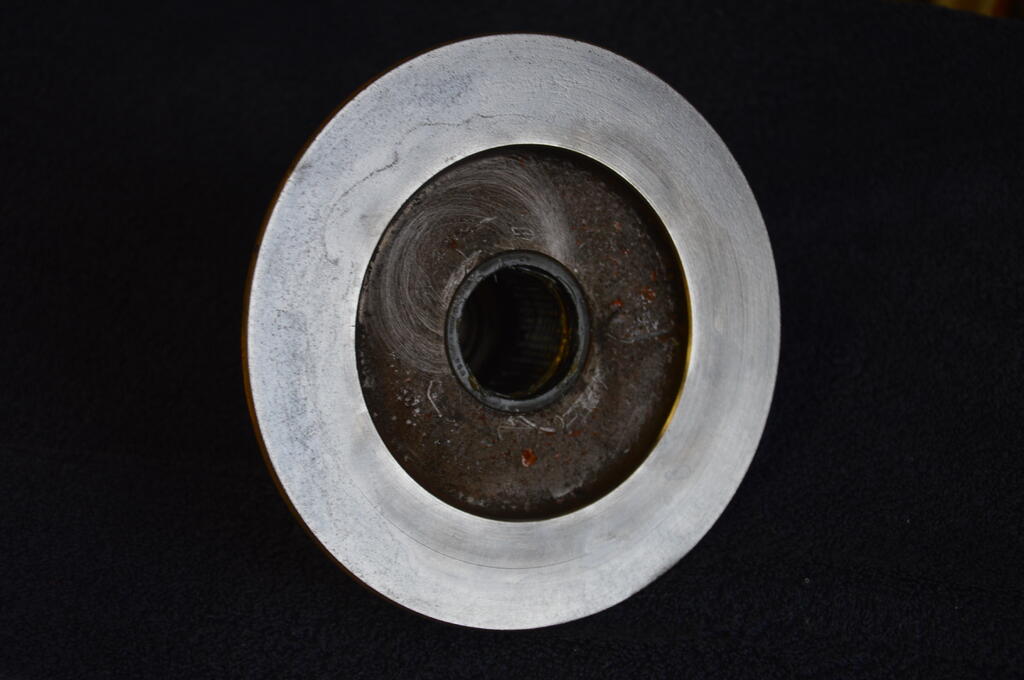

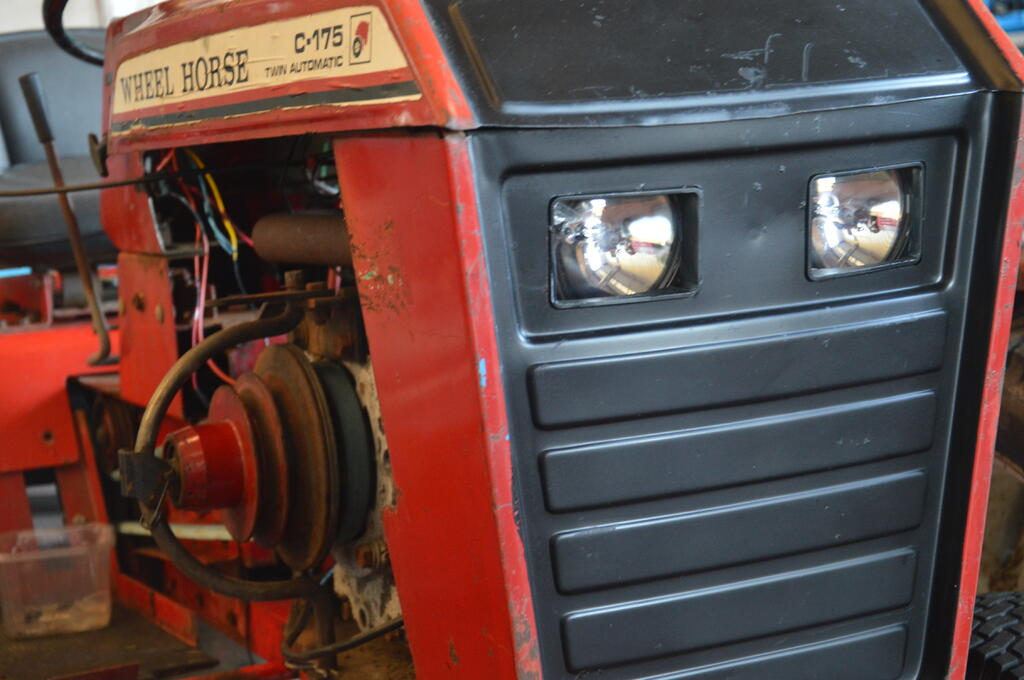

Finished off the engine mounting today, Cleaned the PTO, and replaced the pto back-plate whit one that still has clutch material on it
Only wiring an fuel to keep this machine from running and working! Already have a mow job for it.
The new belt was thight on there, and the Idle pulley just has to put some tension on it.DSC_0406.JPG.7ba4c7915c77a0dadf73f6dc844543a9.JPGDSC_0408.JPG.eff89657a7802563f6db51fd6f0c21e2.JPGDSC_0407.JPG.429fa799641fc5f54b2eb72d1b1a78c2.JPGDSC_0409.JPG.1a09e3b34debacb1f1c32f5c31fb2efe.JPGDSC_0410.JPG.8159b8ee81b8b5958f652745d2870ccb.JPG

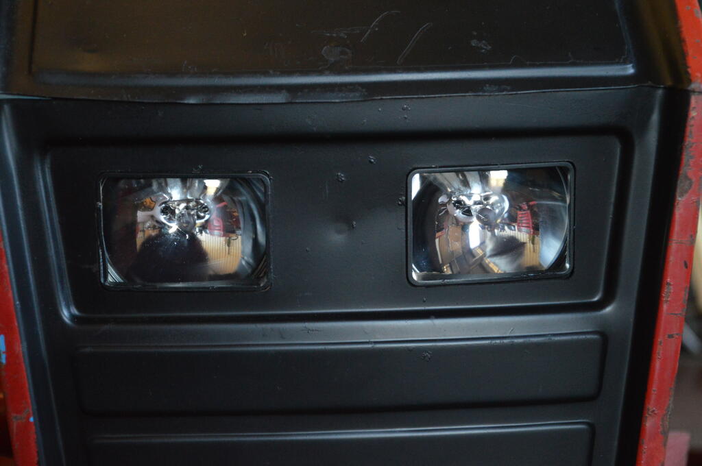

Maxwell-8
PAR36 lamps are getting hard to find, over here they were mostly used for disco lights, but since everything is converting to LED, for the dynamic colours and the limited 100hours burning time doesn't help it either. So these lamps are desappearing in the stores but also online. these where the only ones I could find. The glass is just plain no distorting, but I think they will look good on the C-175.
They just arrived from the country of @Tractorhead.... Germany!
12.8V 30W each
  • Like 4
Tractorhead
Nice lamps! looking cool with the plain glass.
  • Like 1
Maxwell-8
Oh boy, I like the look of them a lot!
Edited by Maxwell-8
  • Excellent 4
SylvanLakeWH
Looking great!
:handgestures-thumbupright:
  • Thanks 1

  On 6/14/2021 at 8:15 AM, Maxwell-8 said:
@Maxwell-8 I’m my Zc81 had a steering wheel broke just like that. I got the center steel piece off the tractor and sandblasted it clean. Cleaned the inside of the steering wheel halves and coated them with JB Weld epoxy.  Clamped it together and good as new. It’s been in use 3-4 years and you have to look hard to see it’s been repaired. Also, add some black spray can enamel paint to the epoxy as you mix it to color the JB Aeld epoxy black.
  • Like 1

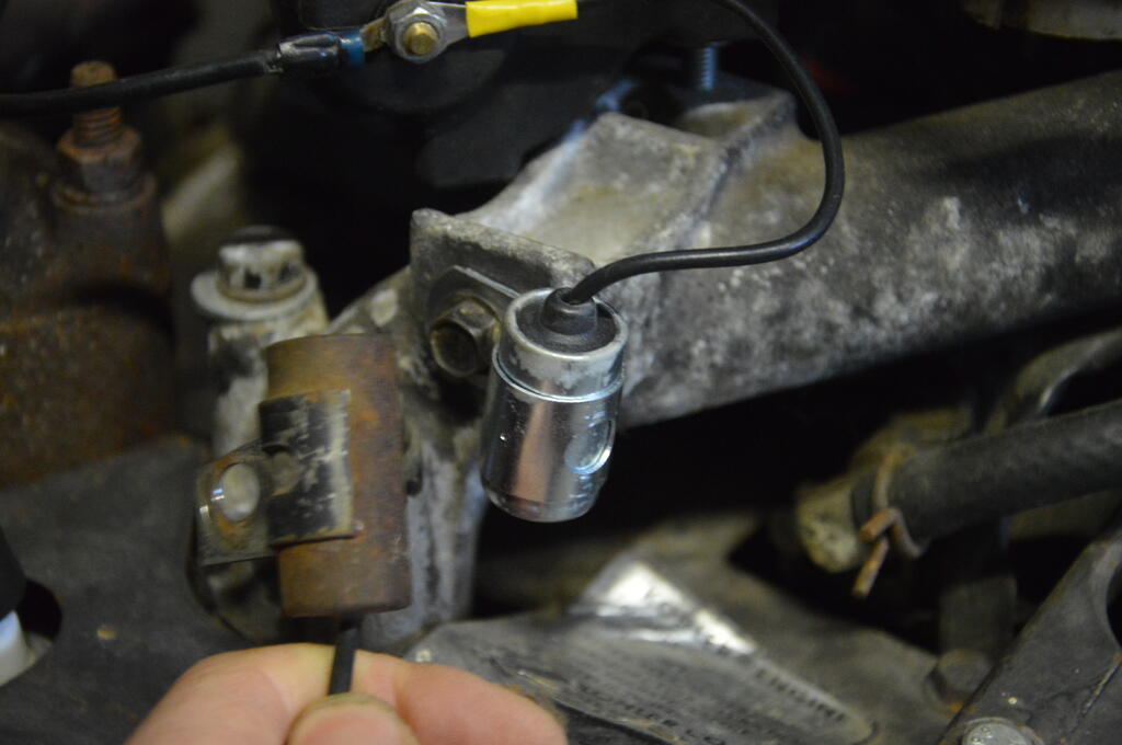

Didn't have spark, taught I had a bad coil. So @953 nut informed me it could be a bad condenser.(thanksss!:handgestures-thumbupright:) So I swapped on a NOS one.
Used a sparkplug I had laying around to test for spark. Still no spark... Until I touched the sparkplugstip :scared-shocked:
I got shocked... now she wants to fire but the starter is no turning over fast enough. Will have to try it with a new battery or I will be rebuilding the starter.

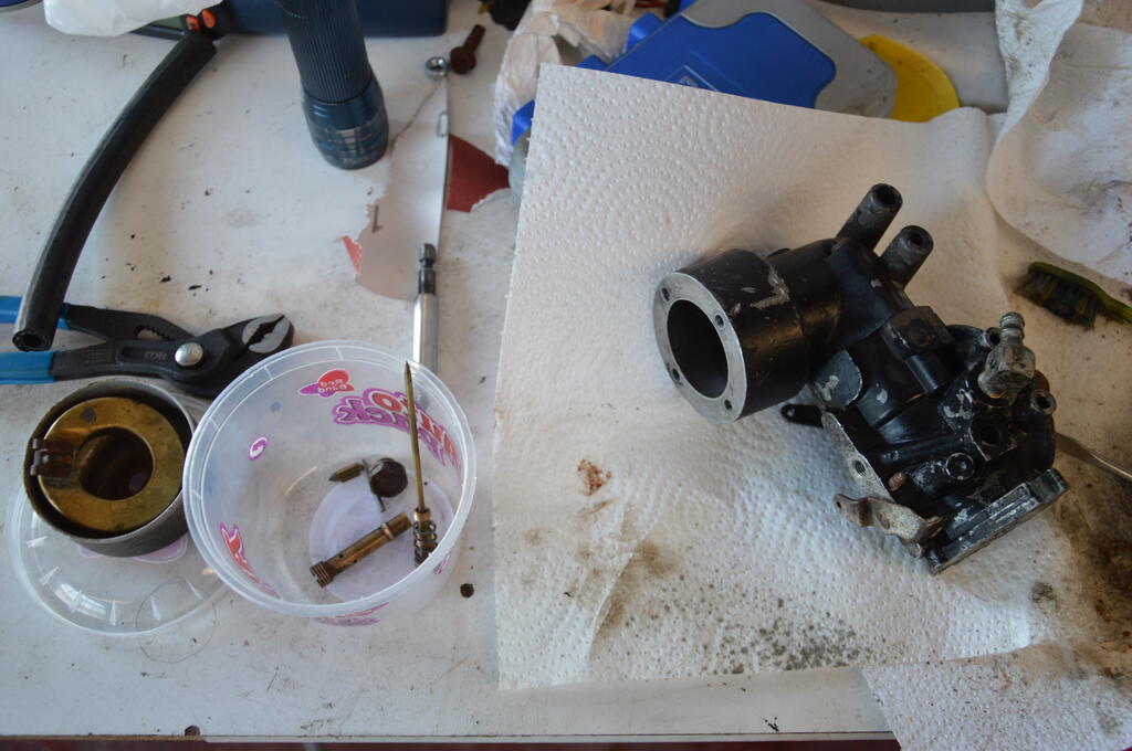

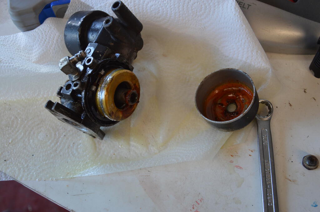

Didn't had spark because of a bad ignition switch that would cut spark if you turned the key to far in the cranking position.
Wasn't giving any fuel to the engine.
Dropped the bowl, which was full, but al the rest was pretty gunked up
Maxwell-8

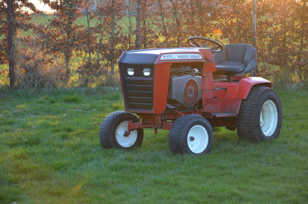

And guess what!
She finally runs with the correct type engine. Hydro is super strong and so is the engine. Bit of smoke on startup but it disappears immediately.
She has come a long way in 10 months.:D
