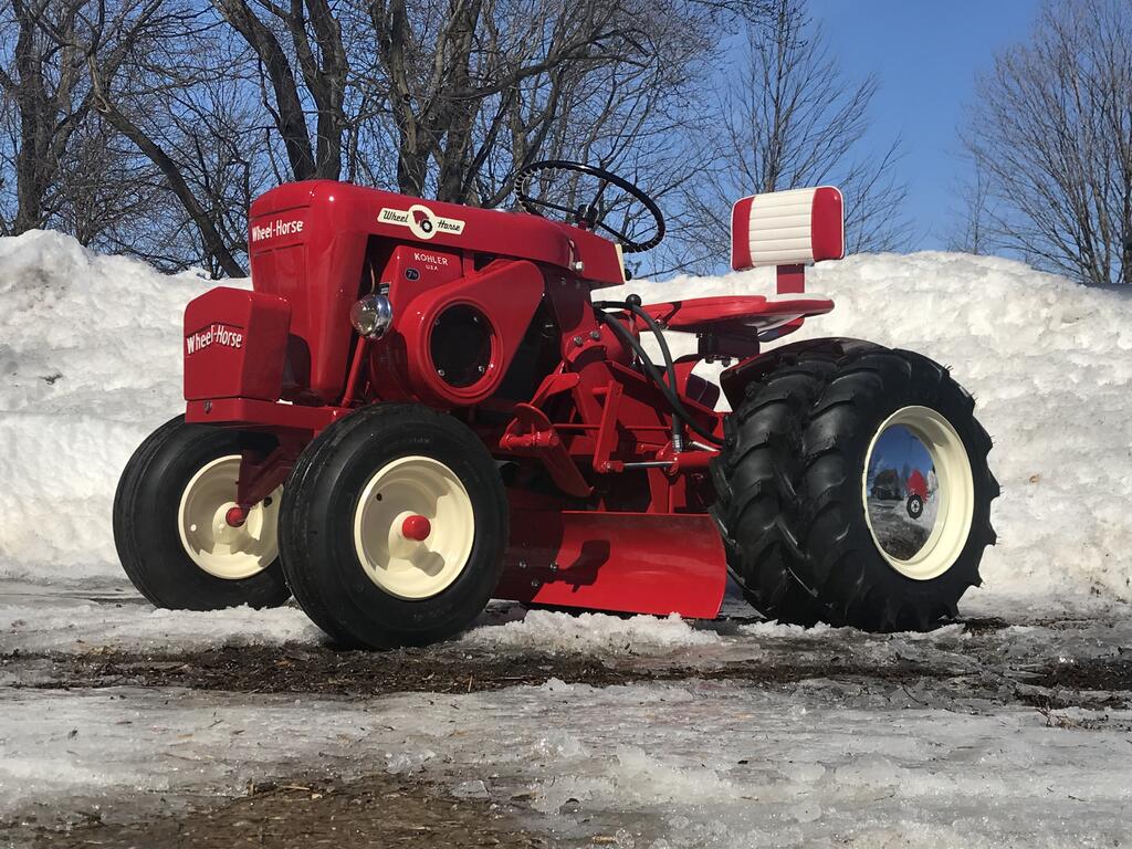

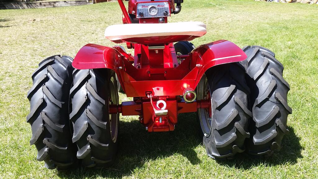

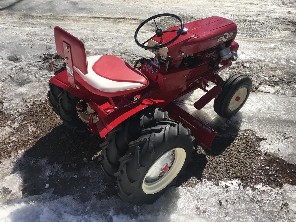

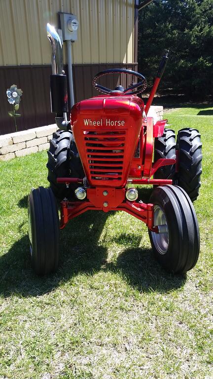

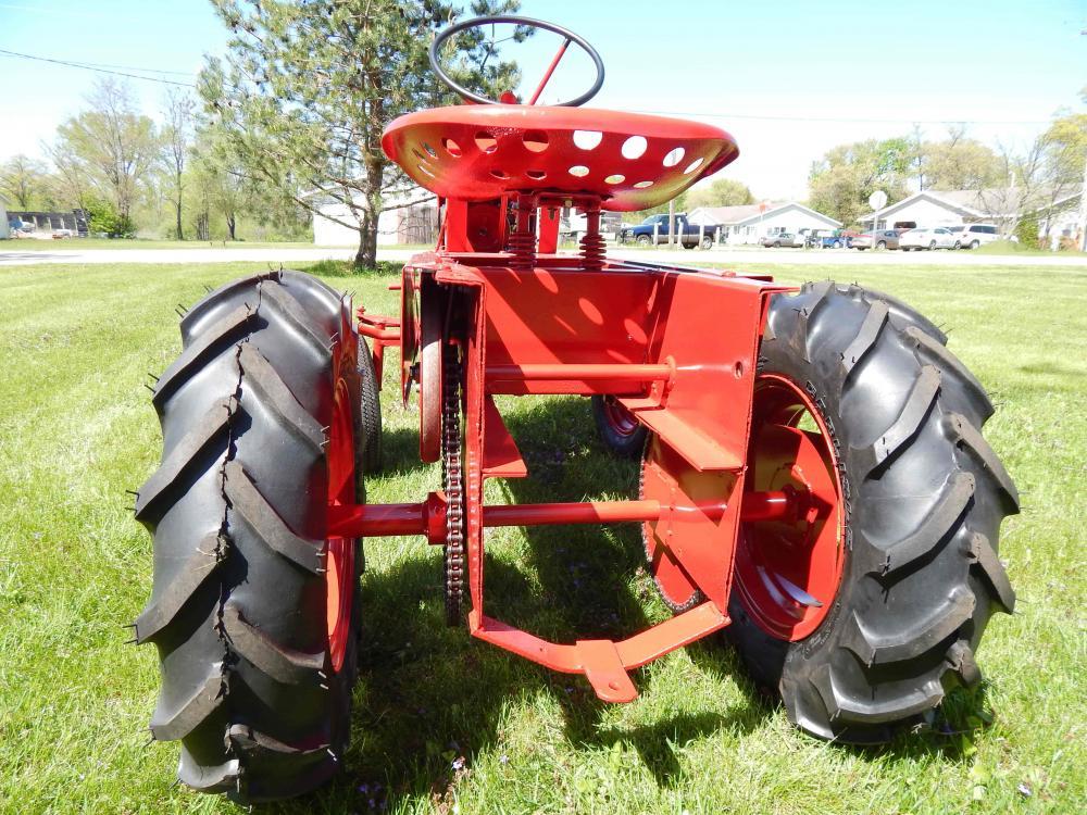

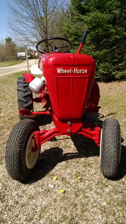

Achto 28,192 #5 Posted May 18, 2021 (edited) I finished my 701 about a month ago. I decided to go with 6-12 Firestone Regency's on the rear of my tractor and 4.80-8 Firestone Turf Guides on the front. I choose the Turf Guides for the front because they were close to the original tread pattern. Here is a pic of my recently restored 701. A link to M.E. Millers selection of garden tractor tires. https://www.millertire.com/categories/lawn-garden-tires/ Many of us run DeeStone tri ribs on the front. Yes they are imported but lets face it, a US name on the side does not mean that they were made here. The DeeStones look good and are reasonably priced. Available at many different vendor's Amazon, Ebay, etc. A pic of my 1076 with DeeStones on the front. Carlisle 6-12 ags are excellent as well. The bar treads are at a different angle than the FireStones. A pic of my McLean with Carlisle 6-12's on the rear. Edited May 25, 2021 by Achto 5 6 2 Share this post Link to post Share on other sites

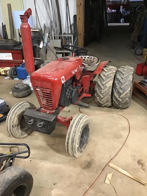

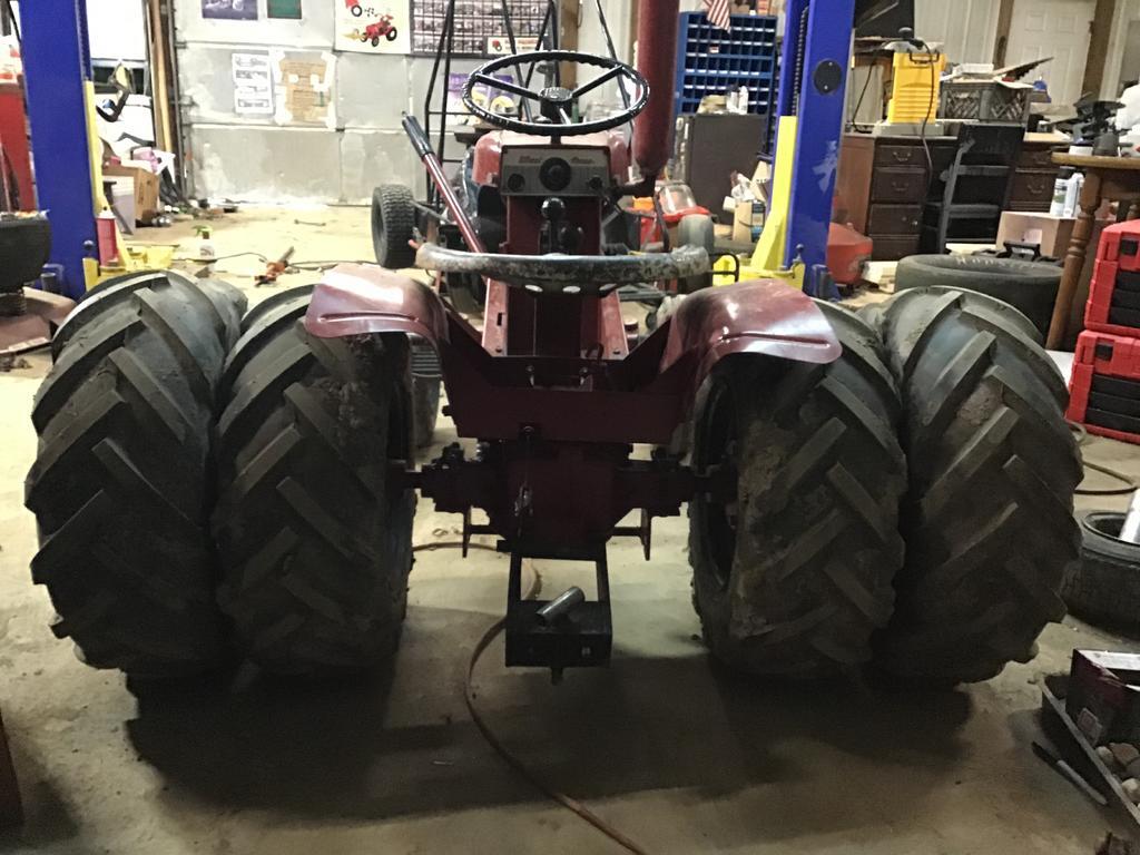

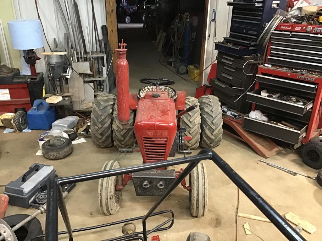

wheelhorseman 3,211 #7 Posted May 18, 2021 I used Carlisle 6x12s on mine and I made my duel adapters if you need some PM me I can make you some 3 4 Share this post Link to post Share on other sites
wheelhorseman 3,211 #8 Posted May 18, 2021 (edited) 8 minutes ago, Achto said: Where are the pics of the 702 with dual Carlisle on it??? Pictures? How about a video instead? 🤷♂️ Edited May 18, 2021 by wheelhorseman 2 6 1 Share this post Link to post Share on other sites

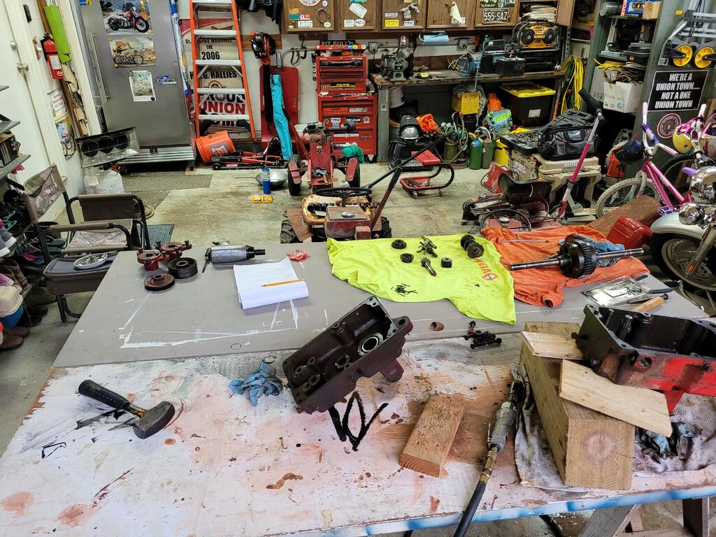

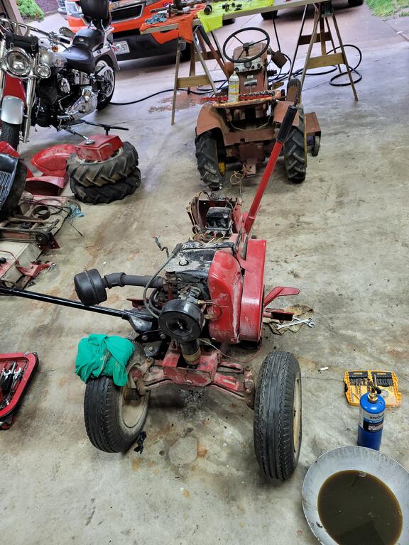

Shawn P 37 #9 Posted May 19, 2021 Not a whole lot to show other than a pile of parts accumulated. Oh and a 2nd 701 I found. Whoops. Thanks again guys for the pics and tips. Anything to help lessen the amount of time it takes scouring the web is extremely helpful. No budget here really. Just trying to get this thing back to where it will outlast my kids. 1 5 Share this post Link to post Share on other sites

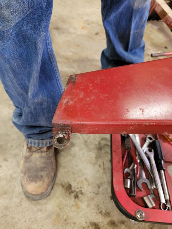

Shawn P 37 #22 Posted May 24, 2021 So I have a few questions about the drive belt guard on this thing. It's been repaired at least once and I'm not sure if it's missing some things. I've seen a few threads on this but I would like to be clear on a couple things. Is it supposed to have a small arm on the front at the bottom as I've seen some of the on some of them? Is that the clutch finger that the owners manual refers to in the clutch adjustment instructions or is there another piece missing? Any body out there be willing to make me two of these belt guards with all the correct parts? The one I have is janky and the 2nd tractor is missing completely. No paint needed as I will be painting the whole tractor at some point. 1 Share this post Link to post Share on other sites

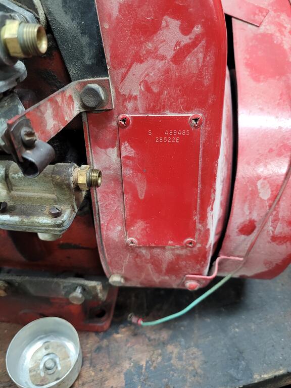

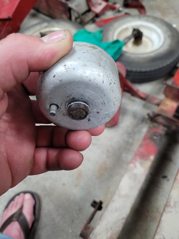

Shawn P 37 #23 Posted May 26, 2021 Anyone know how I register the serial numbers on these two tractors to the list on the forum. I have 54351 and 54232. Didn't see them on there so I would like to add them. Additionally does someone make the reproduction stickers for all of them that originally came on the 701 including the serial #? Also the engine ID tag shown in picture below was painted over. Anyone out there reproduce these? Lastly (lol I'm sure I'll come up with more questions) i have some fuel issues.. Is there a carburetor bowl available to replace the original with the springy drain button hole in it? One of the tractors had the hole plugged and the other has the drain still in it but it leaks terribly. I would like to replace the bowls to alleviate any further issues. One other thing I will be looking for are the fuel line compression connections for the copper line from the pump to the carb. Both tractors rubbers in these connections are dry rotted to hell. Share this post Link to post Share on other sites
oliver2-44 10,079 #24 Posted May 26, 2021 @gwest_ca can resister your serial numbers. Post a picture of the tractors and the serial numbers for his records. For decals go to the Vendor Section and Reproduction Graphics will fix you up. Terry @Vinylguy on here, he is the best! If you don't find a carb bowl on Flebay, you can plug that with JBWeld, it will hold! Share this post Link to post Share on other sites
