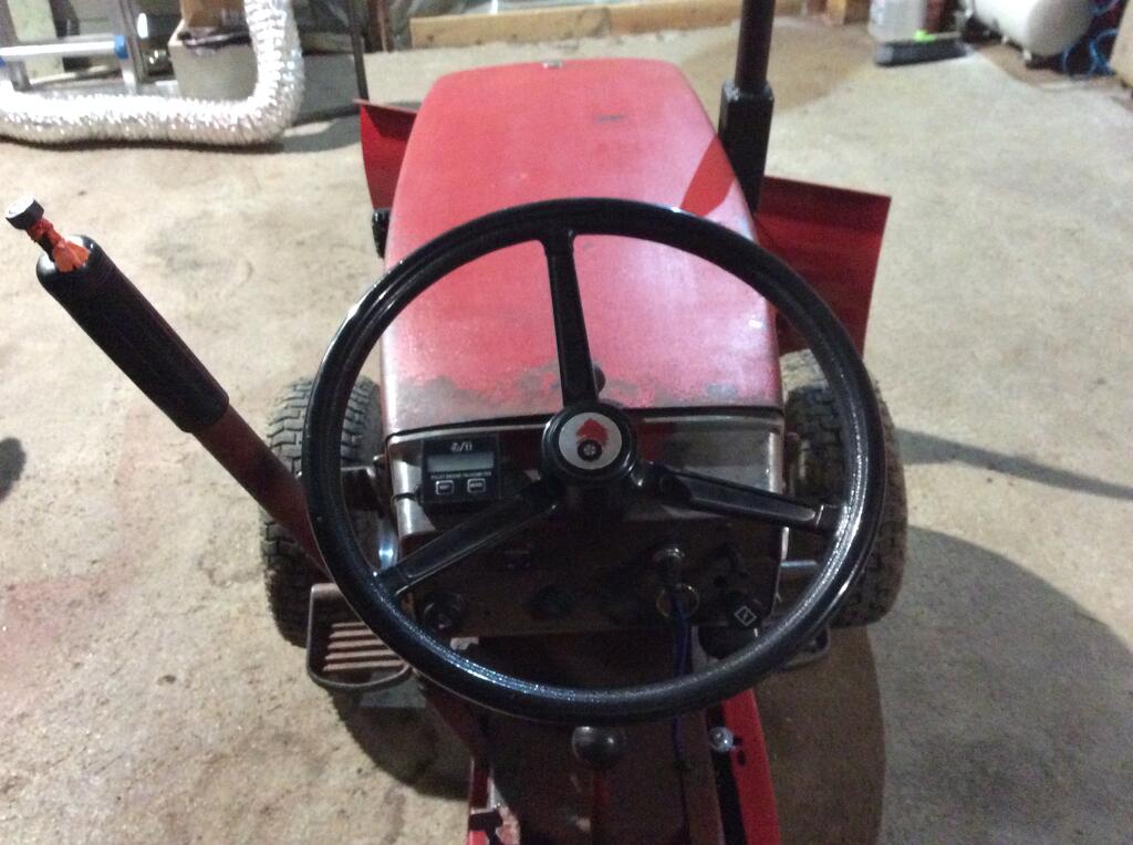

Tractorhead 9,093 #14 Posted May 18, 2021 (edited) I don‘t stick it because it‘s cool, i use it to compare the Engine RPM under different Loads. Even because the Predator and tillotson Engines that cheap, i like to know where are the Limits. i tied few modifications on mine and hope it will last a little. Idle RPM is at 1450 Full throttle is 3990, what can be easilly reached just by pulling the Trailer to the Dump. On mowing a grassheight of 18cm it drops down to 3750 RPM but cut‘s like a charme. the only dis is, it chews belts on this RPM‘s. For me it is simply a tool to see what happened on the Engine. Forgot to tell .. it is a simple battery powred Digital Tacho. it get‘s it pulses by a wire wound arround the spark cable. Updaterate 0,5 - 1 Hz Got it‘s own Battery integrated if Engine is off for more as 30sec. I goes to sleep mode. If Engine ignits it woke up and count. Servicelevel counter. Cylindresetting can be changed 1-2-3 cylindre 2 stroke or 4 stroke. Battery is replacable. cost 4$ at the Bay. Edited May 18, 2021 by Tractorhead Share this post Link to post Share on other sites

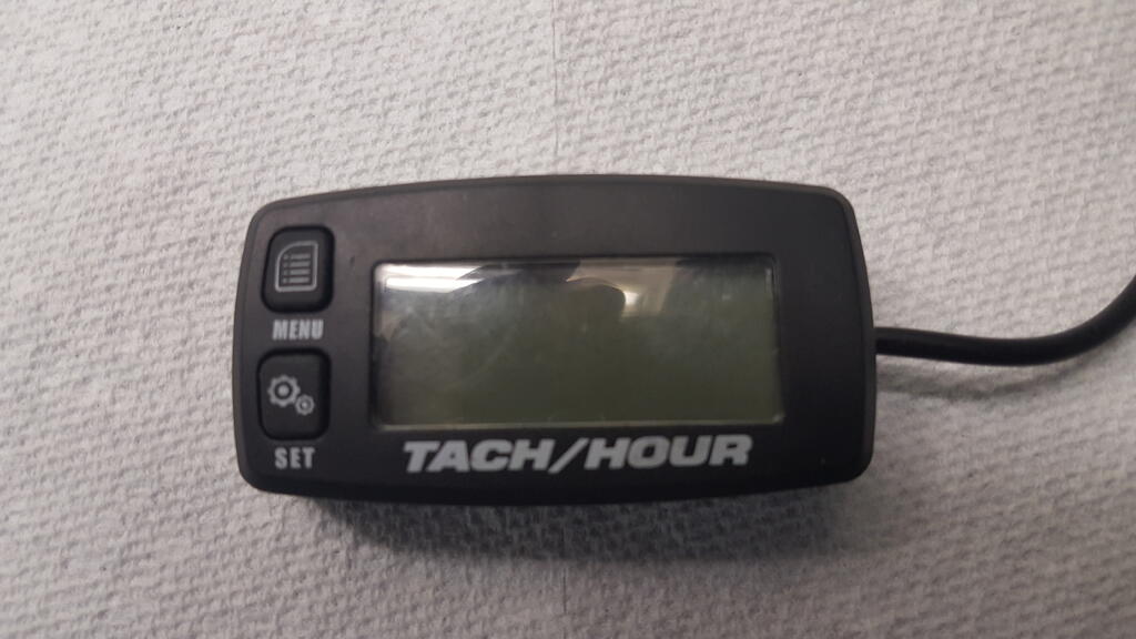

Tractorhead 9,093 #18 Posted May 18, 2021 (edited) 1 hour ago, Gregor said: Do you double the reading on your tach to get the correct number, or divide by 1/2. ? Or either? I no there is a Setupmenu if you press more as five sec. The menu key. than it blinks for 5 sec. a value after the 5 sec. Next value is shown. to choose one value wait until it is displayed, press the menu key until it blinks 2 times, than this value is choosen. Connection the spark wire isn‘t really connected into the system, it is just a kind of Antenna to recieve the signalstrenght better. originally it is stuck from down to top and back to down. I found that the blank wire can contact the Tractors Surface what makes dubious things because of vibrations. So even on blank metal a short can happen. ( maybe your problem?) So i reroute the original wire on it’s mountpoint from top to down to top than pass thru the Hood ( double insulated with heat shrink tube) and along the Throttle wire in front to the Sparkplug and turn it 5x arround the Sparkwire. The reading is accurate and after each start i see the same Values. Checked it against a contactless rpm gauge for Motorcycles i have also. The Value fits after right Setup depending if your engine has points or not, or if you have a magneto you must sometimes choose 2 stroke engine to get right values. Don’t hit the Reset button except on service, that will immediately reset all counters. to switch between displaying of service interval or rpm gauge and hours push short the menu key with a fingertip. To go in Setup menu hit and hold (press) the menu key longer than 3 sec. ( on mine i must press it longer than 5 sec.) than you are in the Setup menu identificated by a flashing cl1in the display. The Setup Menu it begins with cyl. Setting cl1 = 1 cylindre - 5 sec flash if no key is pressed it switches over to the next item cl2 = 2 cylindre - 5 sec flash. If no key is pressed it switches over to the next item cl3 = 3 cylindre - 5 sec flash. If no key is pressed it switches over to the next item st2 = 2 stroke engine - 5 sec flash. If no key is pressed it switches over to the next item st4 = 4 stroke engine - 5 sec flash. If no key is pressed it Jumps out of the Setup routine. reset to display display shows now rpm 0000 and hr 0 if a Value is choosen, the system goes automagically to next setting wait until all your points are marked, than press and hold the menukey for at least again 6-7 sec display switch back to main with the choosen settings. setuproutine is done successfully - It needs a little time for the first setup, but it rocks. Edit- ah i found the Pict of my Tacho / RPM gauge ( left side of the Steering wheel) Edited May 18, 2021 by Tractorhead 3 Share this post Link to post Share on other sites
Skipper 1,789 #19 Posted May 18, 2021 (edited) Ok, so for permanent mount, the easy solution is the type you have seen with the wire to twist around the spark wire. I have a tractor with that, and it doubles as an hour meter and service interval reminder. Little black thing from china. works fine, and it's on target with the rpm's. That's the easiest solution. The "put a sticker on and shine the laser" type are good, but I have newer seen one for permanent use. only the hand held type. They might be out there though. Then there is a ton of types that uses a tacho signal. Something from a old school single cylinder bike might work out of box, but not sure about it. Otherwise, if you want precise, there is the type where you mount a hall sensor at the flywheel, to give the signal, and it needs a magnet to pass it on each revolution. some drill or mill a slot, and set a magnet in the slot with epoxy or chemical metal. But remember, this signal is 100% correct, but still there is room for error in the gauge. And generally, the cheaper the gauge, the more room for error So, if you do not want to mess much with it, the easy route is the "wrap a wire" type. Just make sure it fits your engine (number of cylinders and 2/4 stroke) Edited May 18, 2021 by Skipper 2 Share this post Link to post Share on other sites

Skipper 1,789 #23 Posted May 18, 2021 (edited) Yes, that's why they are programmable. You tell it how many cylinders, and 2 or 4 stroke, and then it works. You may have to mess around with a bit though. I can only say that the ones I have seen works fine. If that goes for all, I do not know. There's a ton of them right here, and i assume just as many on ebay or amazon: https://www.aliexpress.com/wholesale?catId=0&initiative_id=SB_20210518132535&SearchText=hour+meter+tacho Edited May 18, 2021 by Skipper 1 Share this post Link to post Share on other sites
