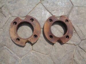

Hello, are these rear wheel weights for WH and if so what's models would they be suitable for? They are roughly 25lbs each and have 53726 cast into them. I have a Suburban.  Thanks

Don't they fit on every 12 inch rear wheel?
Yes they do, with the large center hole they can be used as inside wheel weights and not interfere with the hubs.

Ah, so they go on the inside (tractor)side of the rim.

I should have mentioned that these can put inserted inside of the rear wheels. What I really wanted to know is if these were genuine WH weights or generic ones? Thanks

No, not the WH brand of weights, but commonly used on Wheel Horses.

I am not sure who made them, but I wish that I had a ton of them.

@Red Headed Horse those are front wheel weights for the older Farmall Cubs. They work great inside or outside on the rear of a horse. They pop up on flea bay all the time.

Thanks for all your replies; much appreciated.  I thought they were generic but do look great.  Cheers
