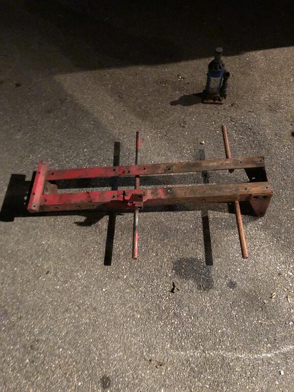

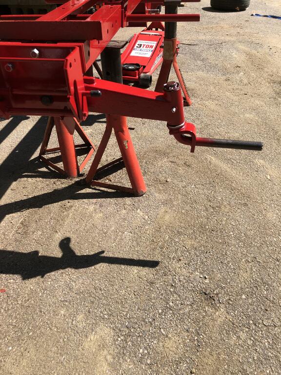

WheelhorseBob 1,549 #1 Posted May 16, 2021 (edited) Hi guys, I have a habit of starting a small project that turns into a rather large project. Anyway I going to start a proper restoration thread now. Here is the start. The only thing I’m sure about is the rebuilt eight speed from last winter and this frame with the electric lift bracket. I’ll post all updates here. Wish me luck! Edited May 16, 2021 by WheelhorseBob 8 Share this post Link to post Share on other sites

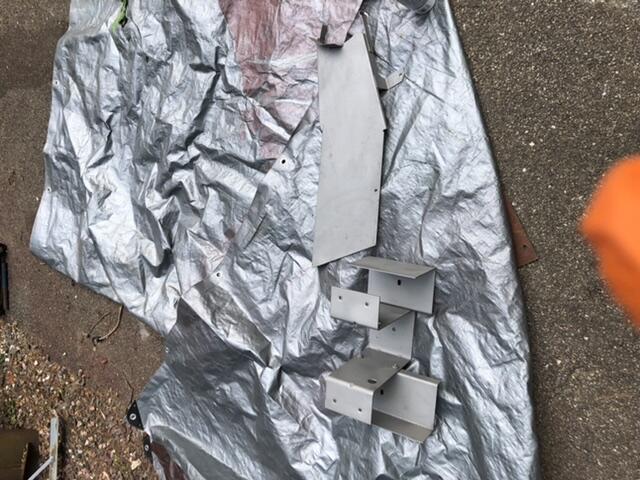

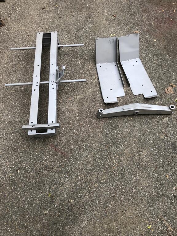

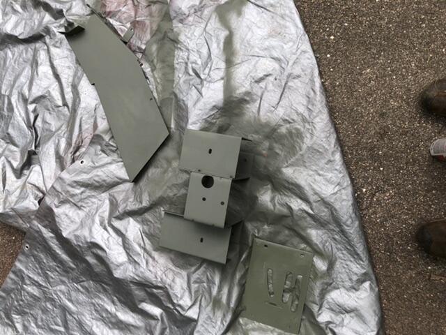

WheelhorseBob 1,549 #5 Posted May 16, 2021 First update. Clean sandblasted parts! Bunch more getting blasted tomorrow. Progress may be slow, I’ve got a bunch of yard projects in the works! 4 Share this post Link to post Share on other sites
oliver2-44 10,074 #6 Posted May 17, 2021 Looks good, what type of blast equipment do you have. 1 Share this post Link to post Share on other sites
WheelhorseBob 1,549 #7 Posted May 17, 2021 I have a cabinet blaster at work. It is loaded with either black beauty or silica sand. For larger parts I have a guy down the road who is reasonably priced. Frame headed there today. 1 Share this post Link to post Share on other sites

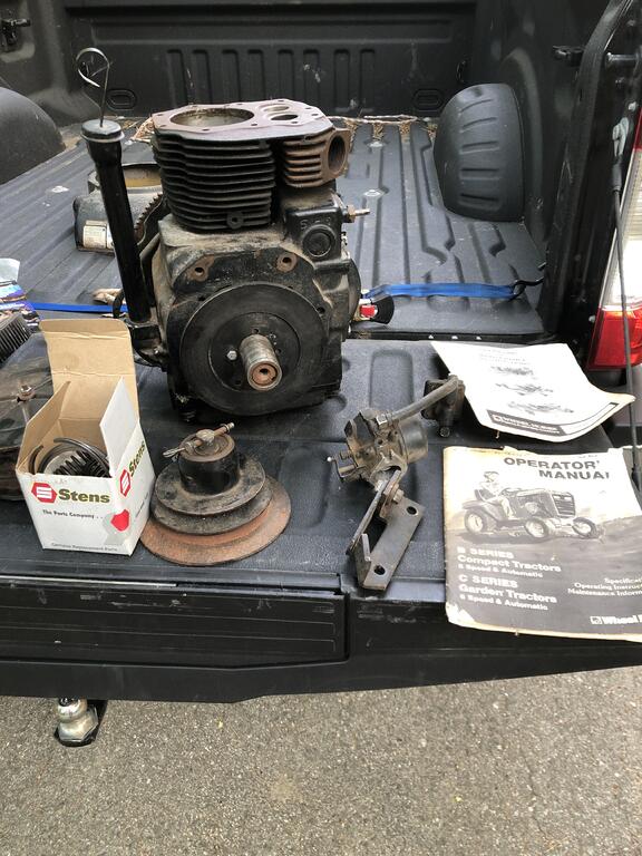

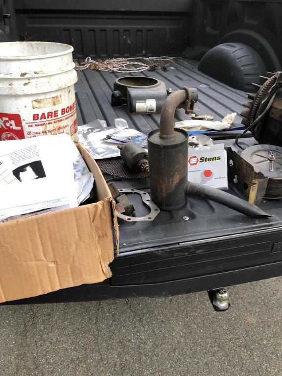

WheelhorseBob 1,549 #9 Posted May 20, 2021 More parts sandblasted. And another twist to this project! I bought a disassembled Wheel horse K341. Gonna be interesting seeing what this is about. The gent sold it for his brother who is elderly now and still cuts his lawn with a 1980 c145. Story is he sold a C165 along time ago to a friend who only wanted the chassis. He kept the k341 and had planned to put a new piston and rings, valves etc. to keep as a spare. He took it apart but never got around to it. Any way this is like unraveling a mystery! I found broken rod in the box along with an invoice for a new crank. It came with new piston rings and gaskets. I think 80 bucks was fair. Anyway I now have thre options for this build. K301, k342 and Briggs 16 twin. Decisions! 3 Share this post Link to post Share on other sites
ebinmaine 69,707 #10 Posted May 21, 2021 1 hour ago, WheelhorseBob said: Decisions Boy. My K341 C160 is a pretty wicked thumper. But I've been a fan of older Briggs and Stratton engines for a while... If I knew the twin ran good I'd lean a little that way. 1 Share this post Link to post Share on other sites
WheelhorseBob 1,549 #11 Posted May 21, 2021 39 minutes ago, ebinmaine said: Boy. My K341 C160 is a pretty wicked thumper. But I've been a fan of older Briggs and Stratton engines for a while... If I knew the twin ran good I'd lean a little that way. I really like the Briggs twins myself however I really like the big Kohler thumpers too. If I go with the Kohler Eric I’ll keep you in mind for the Briggs. On another not I was digging through all the litterateur and it looks like this motor got a new crank in 09 amongst other things. The cylinder has zero scoring so I’m starting to believe the story that the old gent was going to go through it and make it new for a spare. I was told it ran fine when Che disassembled it. 1 1 Share this post Link to post Share on other sites
ebinmaine 69,707 #12 Posted May 21, 2021 8 hours ago, WheelhorseBob said: If I go with the Kohler Eric I’ll keep you in mind for the Briggs Well Sir that would be very much appreciated. Excellent score on that K341!! 1 Share this post Link to post Share on other sites

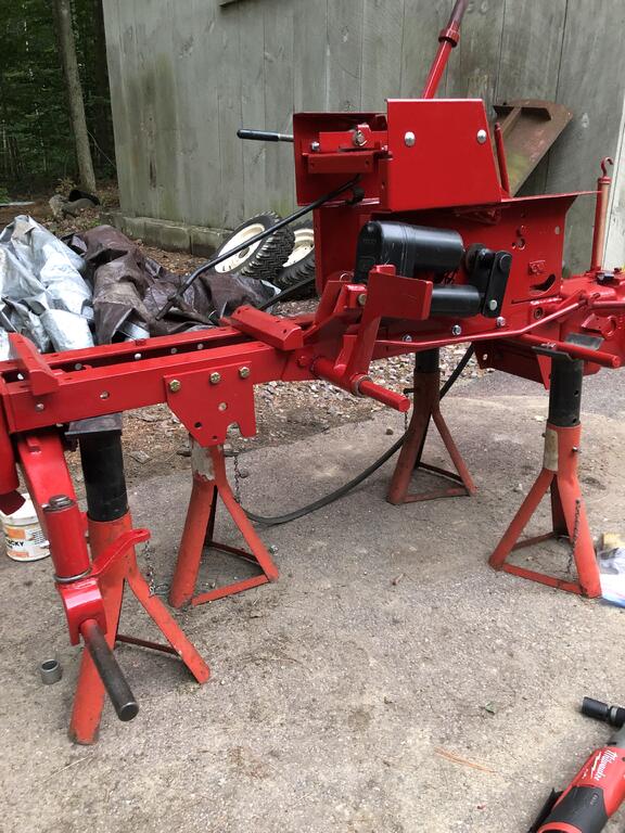

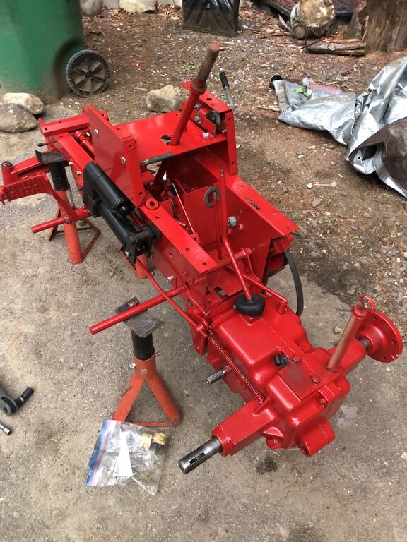

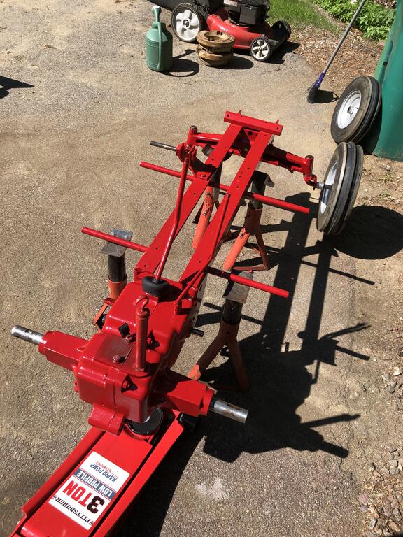

WheelhorseBob 1,549 #13 Posted June 20, 2021 (edited) Update, got the frame painted and the rebuilt 8 pinion rear end reunited with it. I decided to go with the standard axle I removed from my 416 last year. I have a set of NOS HD 3/4 inch front spindles but I never realized they are longer in the axle length. They won’t work with the front tires I chose so back to standard spindles. I really enjoy puttering around with these little tractors! Edited June 20, 2021 by WheelhorseBob 3 3 Share this post Link to post Share on other sites

WH1618speed 535 #15 Posted July 2, 2021 (edited) Those front spindles are the heavy duty ones that were with a kit that was for a loader or if someone just wanted to beef up their spindles. They also put those standard on the 418-C Edited July 2, 2021 by WH1618speed 2 Share this post Link to post Share on other sites
WheelhorseBob 1,549 #16 Posted July 2, 2021 (edited) 3 hours ago, WH1618speed said: Those front spindles are the heavy duty ones that were with a kit that was for a loader or if someone just wanted to beef up their spindles. They also put those standard on the 418-C Does anyone know what front rims the HD spindles take? Also did the upgrade include bearings between the axle and spindles ala 520? I’m thinking it must have as the upright portion of the spindle is longer too. I’d like to use them if I could scrounge up the pieces. Edited July 2, 2021 by WheelhorseBob 1 Share this post Link to post Share on other sites
Handy Don 13,080 #17 Posted July 2, 2021 I suspect that the HD spindle kit might well have had thrust bearings. I seem to recall seeing one advertised and it also, if I remember correctly, included wheels with tapered roller bearings instead of ball bearings (stronger laterally). It was a pricey upgrade. I can tell you that between the reduction steering and the thrust bearings, it is much easier to steer my heavy 520 than my 310. You'll be happy if you can find them. 1 1 Share this post Link to post Share on other sites
WheelhorseBob 1,549 #18 Posted July 6, 2021 Update, a little progress. On an exciting note the K341 should be back from the machine shop this week. It will be a C161-8! Oh and I had to remove the eight speed and completely disassemble. You live and learn, I didn’t get the hi-lo selector groove aligned with the hi-lo fork. It was obvious when I put the lever on. Big thanks to Vinsrj and Dino on YouTube for the help. I can now completely disassemble and 8-speed and put it back in about an hour and a half. More to come. 4 Share this post Link to post Share on other sites

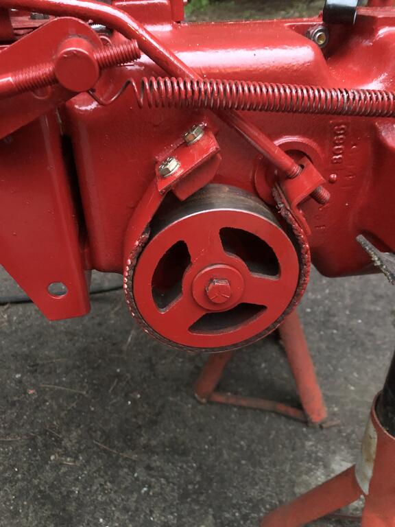

WheelhorseBob 1,549 #20 Posted July 13, 2021 Brakes back together. The lining was separated from the band so I cleaned the surfaces and gorilla glued it back. Not sure how that will work but it’s what I had on hand. 2 Share this post Link to post Share on other sites
ebinmaine 69,707 #21 Posted July 13, 2021 29 minutes ago, WheelhorseBob said: sure how that will work Likely fine. If it doesn't hold it would be a good idea to replace the lining and use clear silicone. 2 Share this post Link to post Share on other sites
rjg854 11,708 #22 Posted July 13, 2021 I've used Gorilla glue and it worked fine Still doing it's job 1 1 Share this post Link to post Share on other sites

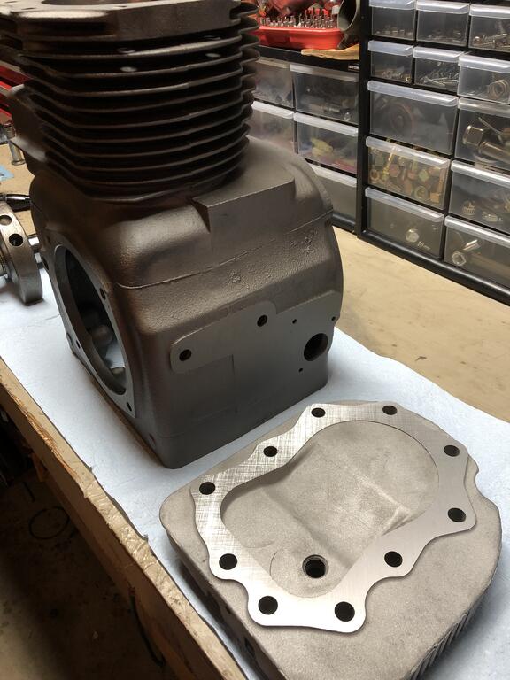

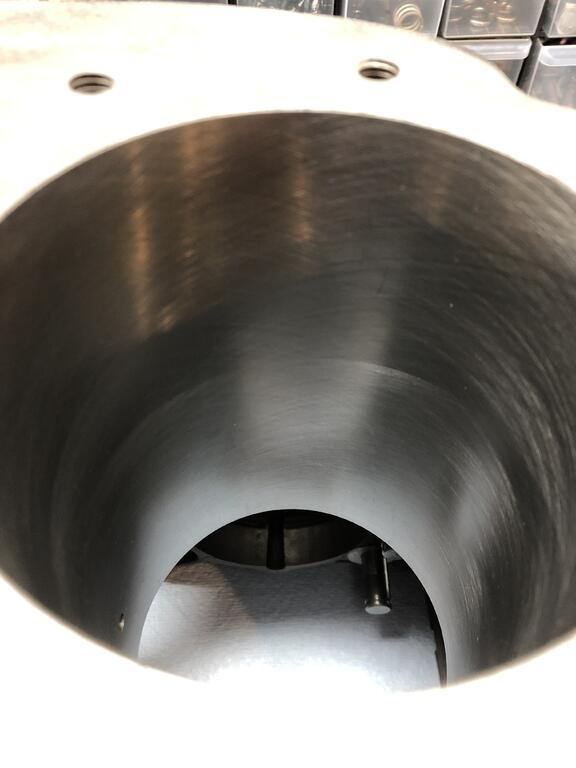

WheelhorseBob 1,549 #23 Posted July 14, 2021 Finally got the K341 back and boy is it pretty! Bored 20, valves ground and head trued. Hot tanked and bead lasted to boot. Who doesn’t love perfect, clean engine parts! Let the build begin. 2 6 1 Share this post Link to post Share on other sites
ebinmaine 69,707 #24 Posted July 14, 2021 Woowoo!! 2 Share this post Link to post Share on other sites
Bill D 2,050 #25 Posted July 14, 2021 Parts look great! Are you going to install one of David Kirk's balance plates on the crank? Or send it to @Greentoredto have the crank balanced? Whatever you do, leave out the balance gears. 1 1 Share this post Link to post Share on other sites
