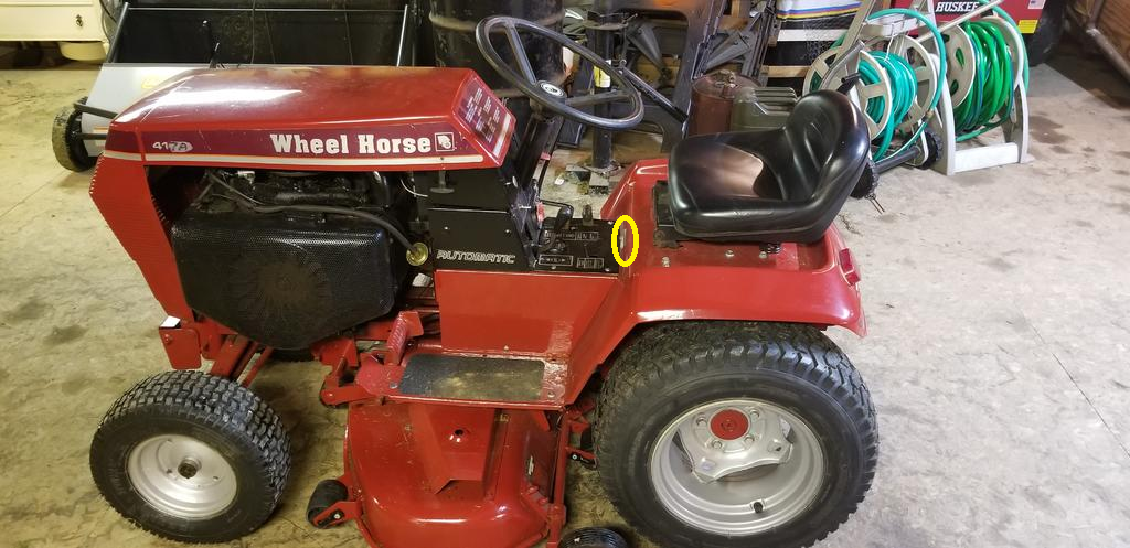

gwest_ca-(File Mod) 11,187 #4 Posted May 14, 2021 Not necessarily for a no-start problem but will reveal other important features about your tractor. The tractor data decal may be in front of the seat or on the left side of the seat on the rear fender pan. When you post the engine numbers include the serial number. Garry 1 Share this post Link to post Share on other sites

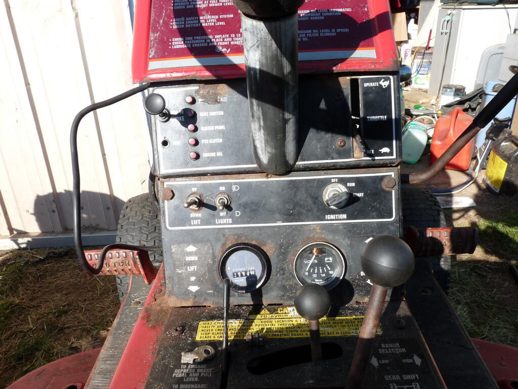

Jonnyrocket132 38 #10 Posted May 14, 2021 25 minutes ago, gwest_ca said: Welcome to the forum. Do you have the tractor model and serial number? Do you have a row of idiot lights on the dash? No - 1985, Yes - 1986 Needed to get the correct wiring diagram. Garry yes I do but I don't think they work Share this post Link to post Share on other sites

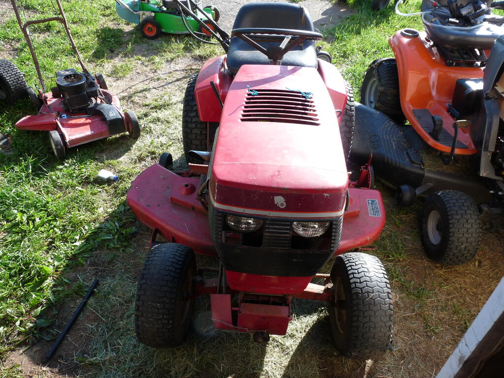

Jonnyrocket132 38 #13 Posted May 14, 2021 here are some photos 1 Share this post Link to post Share on other sites
gwest_ca-(File Mod) 11,187 #14 Posted May 14, 2021 Get the battery charged up with the negative cable disconnected from the battery. Connect a voltmeter between the negative battery cable and the negative battery post. If a short exists it will give you a voltage reading. Hooked up this way it will not create a heavy discharge on the battery. Disconnect different items until the short is eliminated. There is a short battery cable between the tractor frame and the engine. If it fails the starter won't work and perhaps the battery is not discharged. Your tractor is most likely a 1986 model 417-A Twin Automatic model 31-17KE02 with it's original engine. Kohler made your engine in 1985. 1 Share this post Link to post Share on other sites

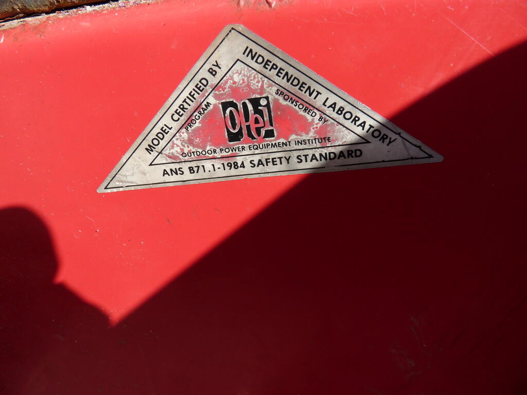

Bill D 2,056 #17 Posted May 14, 2021 Definitely a 1986 model due the louvers punched into the hood and the serial number of the engine. Start looking for melted wiring. You have a direct short somewhere. Bill Share this post Link to post Share on other sites

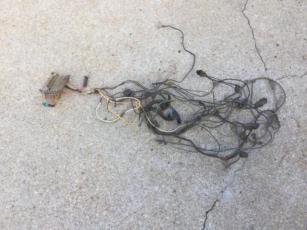

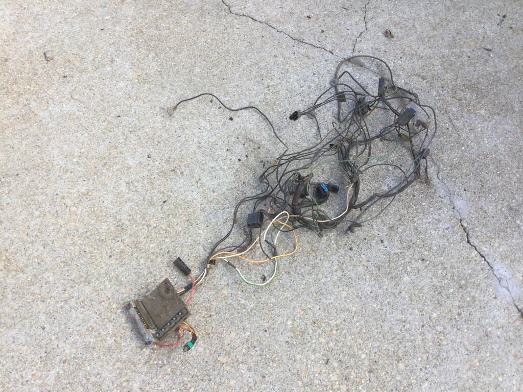

Jonnyrocket132 38 #19 Posted May 15, 2021 update I got it to run but the wiring was done by someone who obviously didn't know what they were doing so I had to rewire the whole thing 6 Share this post Link to post Share on other sites

richmondred01 2,286 #25 Posted May 22, 2021 If your wiring harness is messed up PM me. I have a complete 417-8 wiring harness. Share this post Link to post Share on other sites
