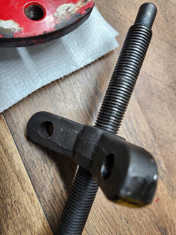

I decided to give the left side a shot since the right still won't budge. I thought I won the battle with the left side but it came to a halt after about 1/2". I attacked it again yesterday and gave it everything my impact wrench could give it. It very slowly started moving again so I kept the trigger pulled. It was extremely tough all the way but it finally came of. The parts off the 3 jaw puller I bought specifically for this task aren't the highest quality. Menards special. The threads took some abuse.

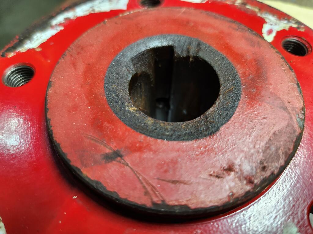

Here's something that seems odd to me. A chunk of the hub broke off at the outer edge. You can see I didn't cause it since it's clear it's been that way a while. But the hub will definitely be fine. Here's the odd part.
There's a concave taper around the axle hole. I've never seen one like that and the right side doesn't have it. Ever seen hugs like this?

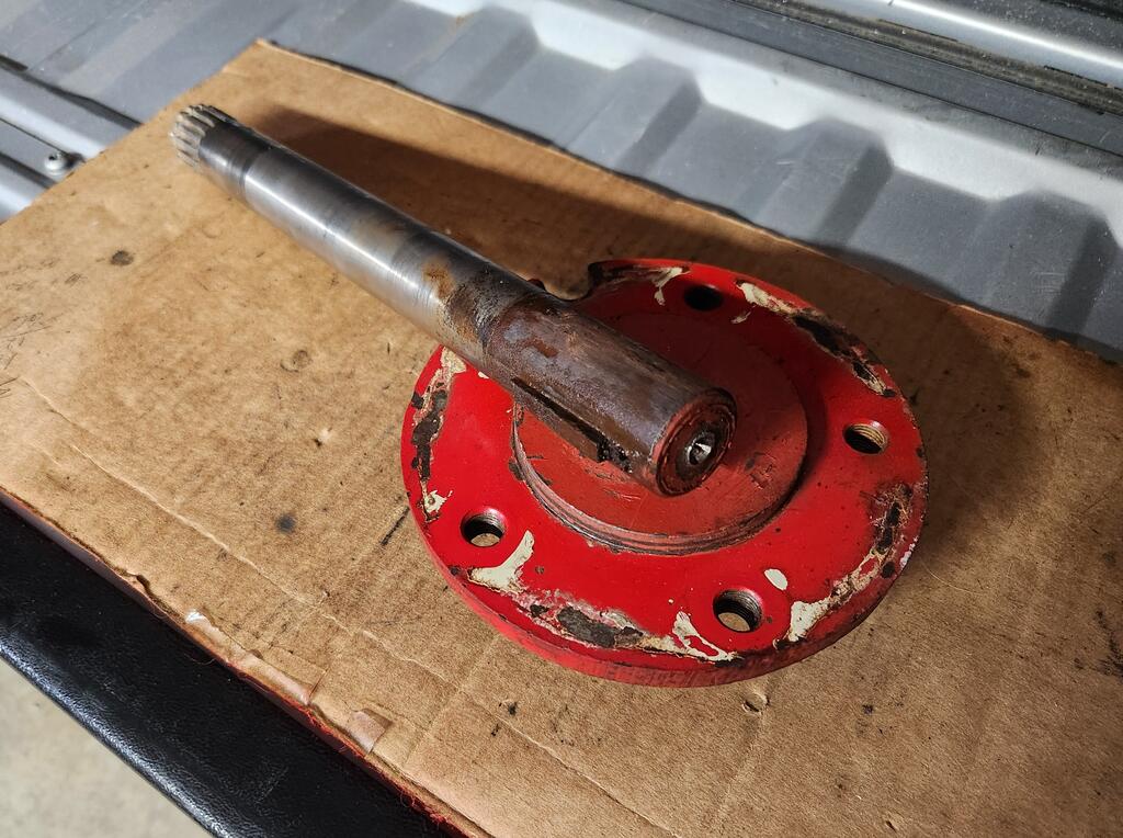

I wanted to try moving the hub in the opposite direction just to see what happens. I bore a 1-1/4" hole partially through a 4"x6" so I could stand the axle up as well as protect the splines. I cut a short piece (about 2") of 1-1/2" galvanized pipe and threaded it into a pipe cap. I set it on the hub and had at it with a sledgehammer. It didn't even begin to budge. Hoping to find a press locally I went to a small shop in town that has a :wh: sign. This was the 3rd attempt to go there and nobody was there all three times. Knowing that some NAPA's have a shop I went to a local one. Even if they didn't have a press I could get the headlight pigtails and some straight 40w oil and tap into some NAPA knowhow to see if they knew who had a press in town. They suggested trying a few places and one of them was The Pit Stop just down the road. They had a press, I handed them the axle/hub and a few minutes later he handed me this. :banana-dance::greetings-clapyellow::banana-dance:
Now I can finish the transmission and if the extended forecast holds true get a coat of paint on it sometime between Christmas and New Years.:)

Holee Cow that one was welded on! :wacko:
Glad you were able to remove it without breaking anything!
