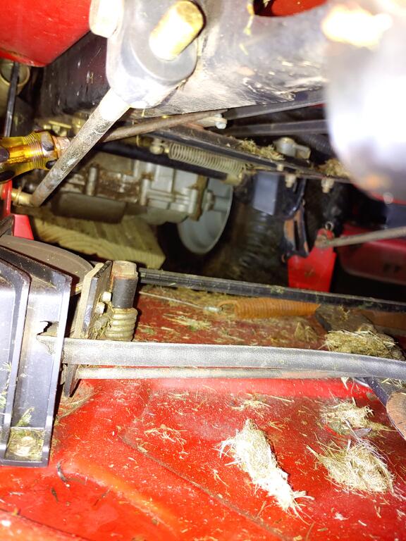

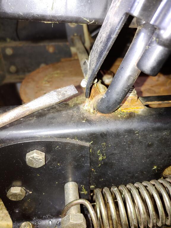

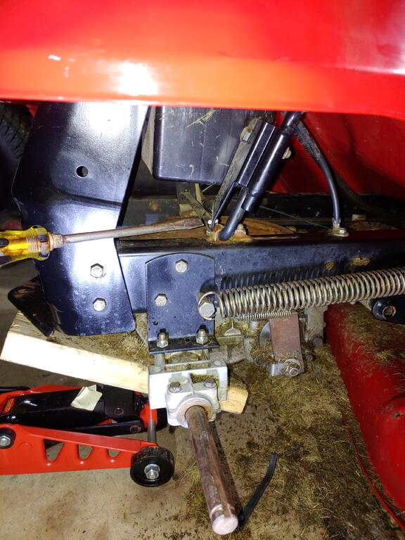

Bowieeeeeeeeee 1 #1 Posted May 11, 2021 I have a 13-38xl that the parking brake is not engaging. The pedal is fine and it will lock but the tractor still moves freely and it does not stop immediately when I press the clutch. The only thing I could find was this snapped cable. The photos show both ends of it. Look at the tip of the screwdriver for location. So here are my questions. What is the cable, would it cause my issue and does anyone have a part number? Also I'm new to this forum so if I posted this wrong I apologize. Thanks in advance for the help. Share this post Link to post Share on other sites
