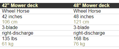

Brockport Bill 1,824 #1 Posted May 10, 2021 does anyone know from experience how much a typical 42 inch or 48 inch mower deck weighs? Hard to put on a scale - want to know for shipping purposes calculations? Perhaps its listed somewhere in WH documents.... or people know from shipping one previously?? thanks !!!! Share this post Link to post Share on other sites
Maxwell-8 4,366 #2 Posted May 10, 2021 (edited) This should be the answer you're looking for. Tractor data has some nice info Those decks are some heavy boys for sure. Edited May 10, 2021 by Maxwell-8 3 Share this post Link to post Share on other sites

Brockport Bill 1,824 #6 Posted May 10, 2021 Maxwell --- wow - impressed -- thanks for reference to Tractordata.com -- should have thought of that resource ---- actually does not have the weight for that specific model deck listed ...... but i called 1-888 for Toro and very helpful staffer looked it up for me -- 1 Share this post Link to post Share on other sites

Maxwell-8 4,366 #10 Posted May 10, 2021 4 hours ago, Brockport Bill said: Maxwell --- wow - impressed -- thanks for reference to Tractordata.com -- should have thought of that resource ---- actually does not have the weight for that specific model deck listed ...... but i called 1-888 for Toro and very helpful staffer looked it up for me -- no problem, sometimes a model isn't complet, but can be found with other models of that series. A tip for Quoting people is using the @ @Brockport Bill Share this post Link to post Share on other sites
