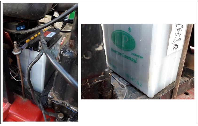

Mark1983 9 #1 Posted May 10, 2021 Hello horse riders, I hope this topic will contribute to this forum. I haven't posted much on this forum but when I have 'a problem to solve' I share so that other people can learn from it (or just for entertainment purposes of course ). Now my battery is flat/bad and I want to buy a new one. Attached is a picture of my current battery. This 'new one' was already there when I bought the tractor. I think the original batteries are no longer on the market? Is there any information available on what batteries are the orginal ones? On my 211-5 (1986) and perhaps other horses? The current battery is 12V and 14 AH. But it may be on the weak side.. Perhaps a 18Ah is better? At a website I also see an 55 Ah !?.. Any suggestions? *By the way, i find it hard to search the forum, there are just to many search results. So if this topic is a duplicate my apologies. Perhaps there is a way to further or better streamline the information on this forum? (this off course is also a compliment because of the amount of info on this forum....) Best regards, 4 Share this post Link to post Share on other sites
Achto 32,351 #2 Posted May 10, 2021 I am not real familiar with vertical shaft models, but I would think that it should take a common lawn tractor battery. The battery you have now looks more like a motorcycle or ATV battery. 2 Share this post Link to post Share on other sites
Maxwell-8 4,371 #3 Posted May 10, 2021 3 hours ago, Mark1983 said: he current battery is 12V and 14 AH. But it may be on the weak side.. Perhaps a 18Ah is better? At a website I also see an 55 Ah !?.. You have quite some space left in there, probably you need a U1. i buy the U1-R because there are cheaper, but they are taller, don't know if it will fit in you mower. A battery the will fit in there is probably going to be around 14-22Ah capacity (a "real" 55Ah battery is gone be to big). If you need a battery that will start faster, you have to look at the (Cold) cranking amps CCA. 230-350CCA, the higher the number the easier it will be for the battery to run the starter-motor at full speed. 1 Share this post Link to post Share on other sites

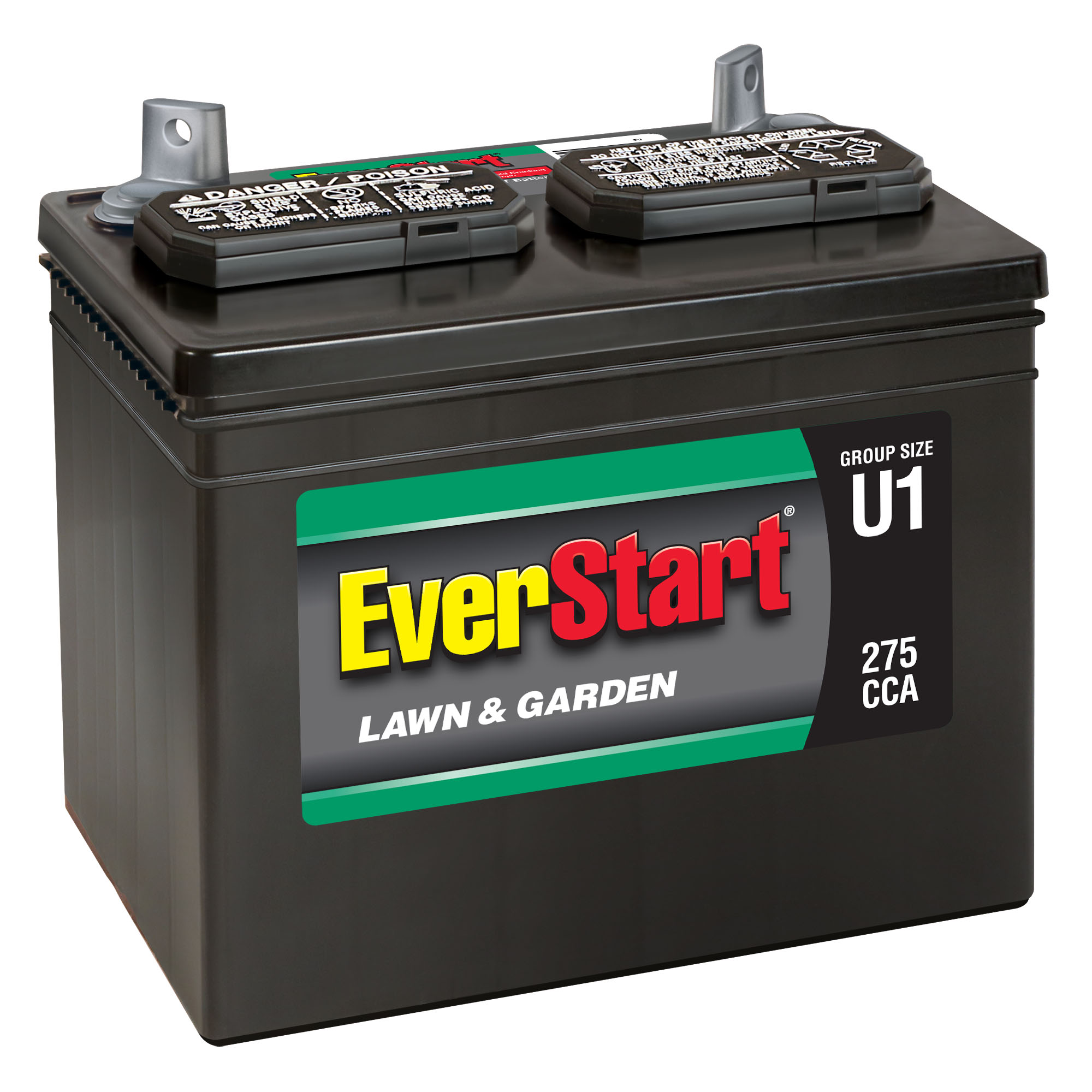

pacer 3,180 #4 Posted May 10, 2021 This is the typical type/style battery -(group size U1) most of us use here in the states (the one in your tractor appears to be same size/type) We generally go by the 'CCA' rating (cold cranking amps) The 275 CCA on this one seems plenty. I personally use this particular battery in all my horses - up to and including the big 'D' series. It is sold here in the huge Wal Mart stores for about $30 with trade in/core charge 2 Share this post Link to post Share on other sites
