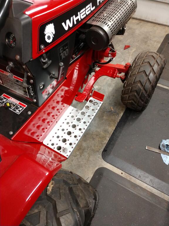

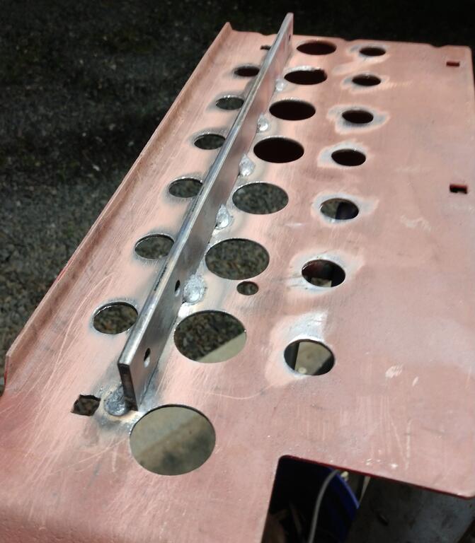

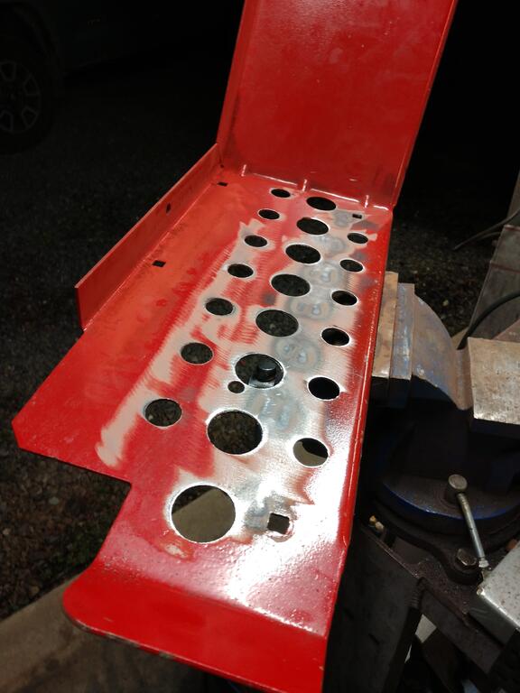

kpinnc
Seems I never fully complete anything. I'm always going back and tweaking stuff.
The footrests of all things on this tractor stumped me. I found some great aluminum tread plate for them, but knew they would hold all kinds of dirt. Drilling the footrests to match would be a chore, plus they'd be weakened considerably.
So today I finally finished the left side. Drilled a heckuvalot of holes, and welded a 1 x 1/8 steel reinforcement to make up for all the holes. Tuned out pretty good. Probably do the right side tomorrow...
Edited by kpinnc
  • Excellent 8

Looks excellent.

Pullstart
Cool tread!  I bet a couple dimple dies on the holes in the step would strengthen it significantly too!
  • Like 3

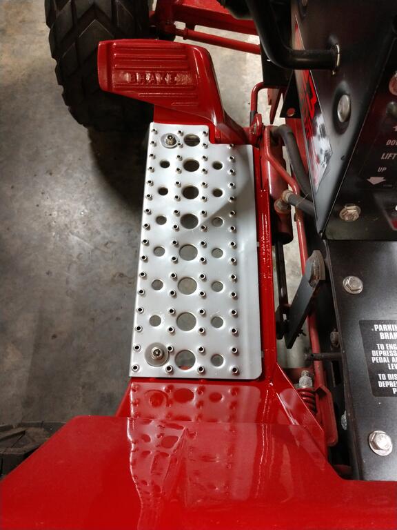

kpinnc
Right side done. Crazy how stiff these are with the reinforcement underneath. No flex whatsoever.
  • Like 3
  • Excellent 3
