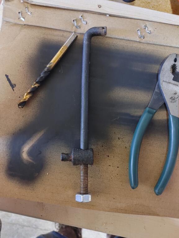

So I got this put on, but now when I lower myower deck the front wheels don't touch the ground? Any help?  I have a 318

I have the nut all the way at the bottom of the rod. Hope that isn't too short.  Don't see any rust on mower deck ,but it was somewhat restored so maybe it's hidden behind paint.
pfrederi
Adjust the length so the front of the deck is slightly lower than the rear. With a blade pointed front to rear the front of the blade should be about 1/8" lower than the rear.
Bak106
So then the front roller wheels won't touch ground like on my old Deere?
roadapples
No, only if the ground is really unlevel..
