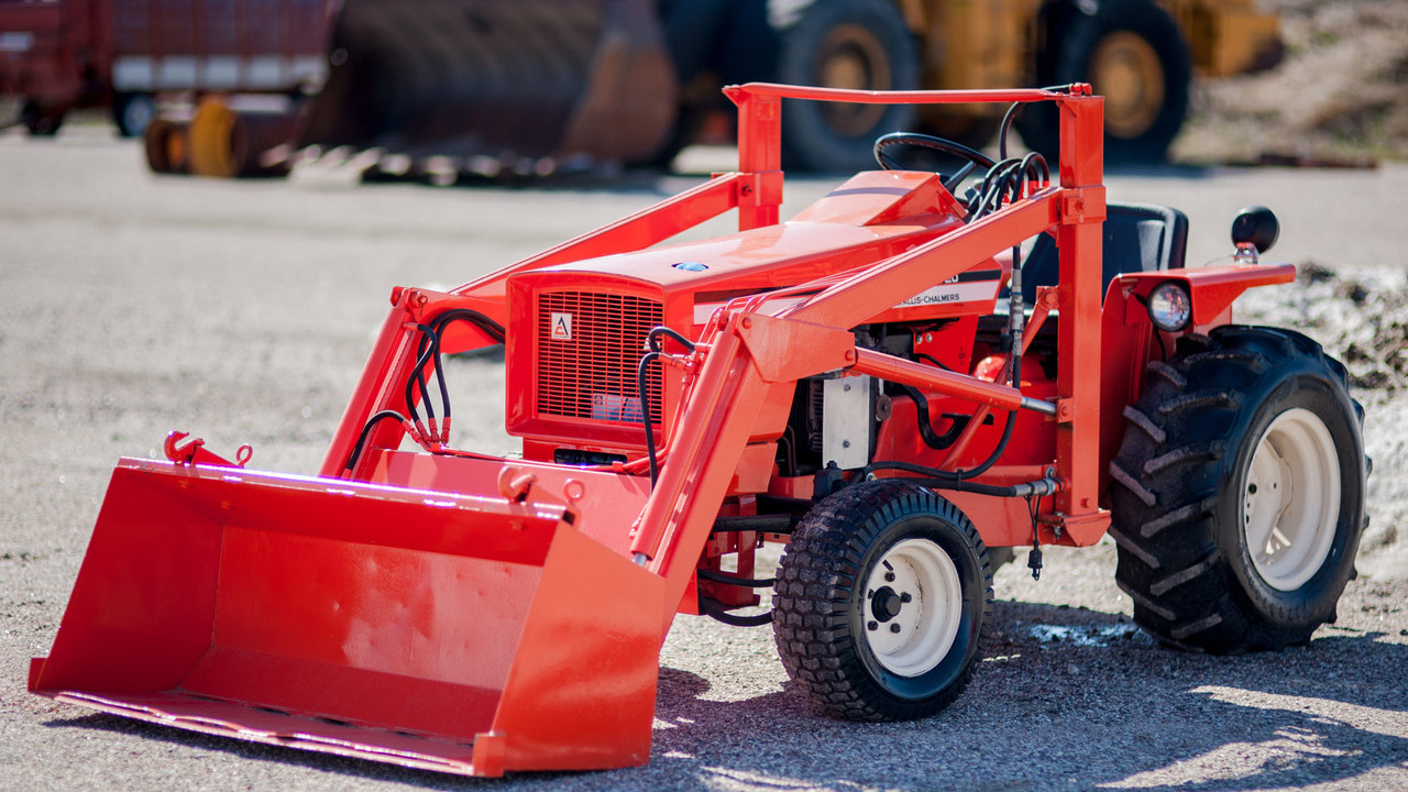

bc.gold 3,403 #1 Posted April 29, 2021 (edited) Anyone know a part number for the drive belts used on the Alis Chalmers 720 and Simplicity 9020. figured it would be a good time to replace them before the tractor is completely buttoned up. I believe the PO or his mechanic has installed the incorrect belts. Edited April 29, 2021 by bc.gold Share this post Link to post Share on other sites
