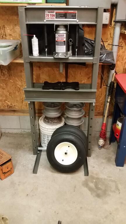

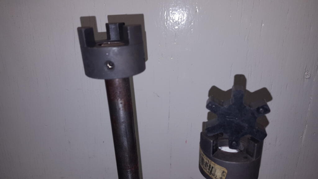

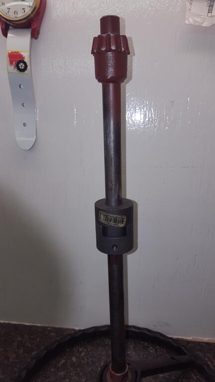

Gregor 4,847 #1 Posted April 28, 2021 I soaked this wheel for 3 days, and had a bearing puller on it for 3 days, it didn't budge. I have other wheels, but this is a 2 spoke wheel, and I wanted to save it if I could. When I was working on my C-141, I had the same problem, but there was no way to put a puller on that wheel. I subsequently ended up breaking it. At that time someone (I don't remember who) suggested cutting the shaft and then putting it back together again. That's what I did this time. I don't know what you call these do-hickeys, but I got one. I drilled a small divet at each of the 4 set screw points, to give it a little extra bite, since there is no key way in the shaft. Once everything is back on, I can slide the shaft in, and join it. The stop at the bottom, and the collar at the top of the shaft, I'm thinking will hold it together. If not, plan B. 3 Share this post Link to post Share on other sites
WHX?? 50,603 #2 Posted April 28, 2021 That's called a lovejoy coupling. Usually use in power transmission applications where some "give" or flex shock loading is desired. Also sometimes forgiving for slight misalignment. Should be ok for what you are doing with it but might introduce a bit of wheel slop down the road. Couldn't take the wheel to a H press? 1 Share this post Link to post Share on other sites
Gregor 4,847 #3 Posted April 28, 2021 8 minutes ago, WHX24 said: Couldn't take the wheel to a H press? Maybe somewhere, but if you drive to the middle of nowhere, then go another 20 miles, that's where I live. 3 Share this post Link to post Share on other sites
WHX?? 50,603 #4 Posted April 28, 2021 4 minutes ago, Gregor said: drive to the middle of nowhere, then go another 20 miles, that's where I live. YYYep... I hear ya.... same boat here. Probably why half my disposable income goes to tools! 2 1 Share this post Link to post Share on other sites

Ed Kennell 40,354 #8 Posted April 29, 2021 15 minutes ago, WHX24 said: @Ed KennellI think used some nifty couplings once. Yeah, I have cut several shafts and rejoined them with rigid shaft couplings. I would not recommend a Lovejoy or any flexible coupling. This shaft is only supported by a bearing at each end and requires a rigid shaft in between. A flexible coupling would be used to connect two shafts that are supported by two bearings each. I am concerned this arrangement will cause excess wear in the lower bearing block and possibly binding due to misalignment. 3/4" rigid shaft couplings can be bought for $10-$15 dollars. I typically weld to the lower half and bolt thru the upper half for easy disassembly. 6 1 Share this post Link to post Share on other sites
Gregor 4,847 #9 Posted April 29, 2021 One rigid shaft coupling ordered from McMaster Carr. 2 Share this post Link to post Share on other sites
