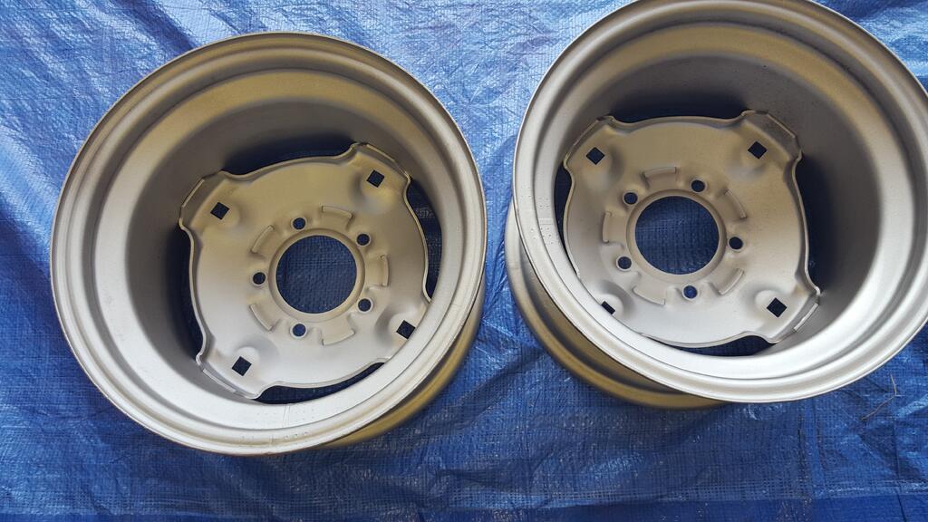

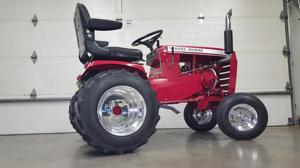

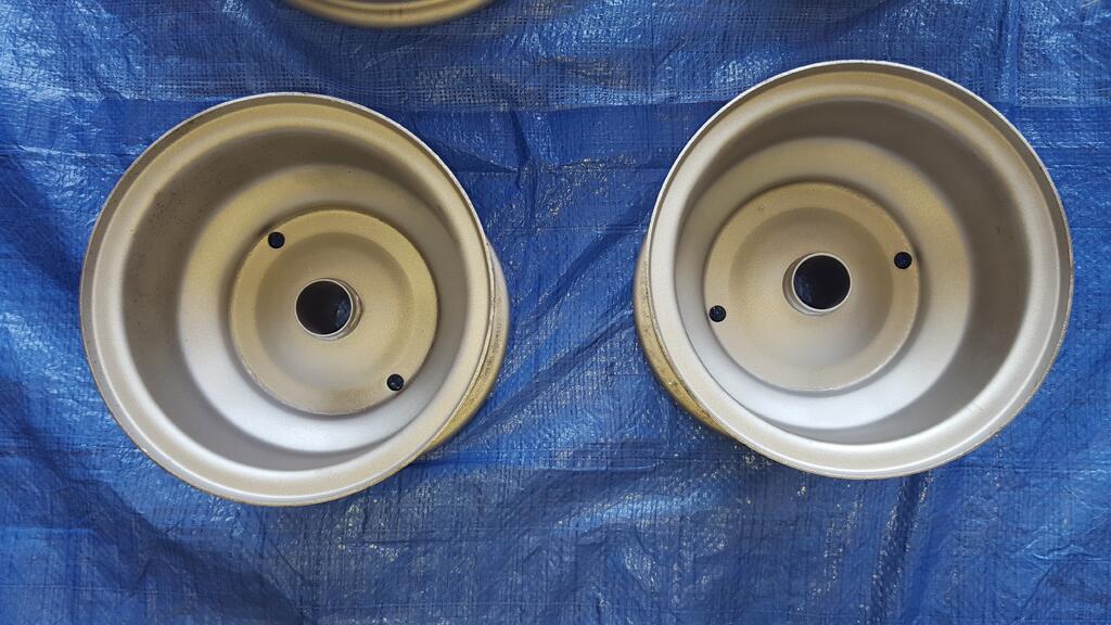

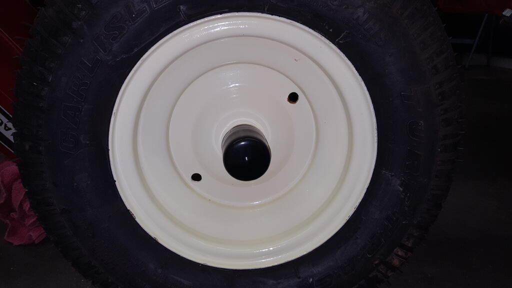

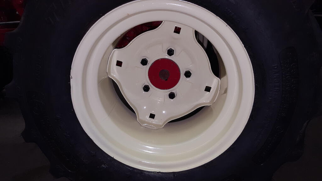

I had my wheels media blasted and painted them myself. The cost was $80, but I had several other pieces done at the same time. My shop has a minimum charge of $80. so I took other things along with. I am assuming the major cost in your $300 estimate is the powder coating. Just have them blasted and paint them your self. Trying to sand wheels, and make them look good, is near impossible.
