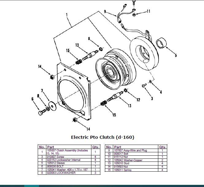

Has anyone replace the manual PTO on a D200 with an Electric PTO?  If so, have you any advice or parts list?
pfrederi
Onan powered D-160 used an electric PTO   Why do you want to replace your manual PTO.  Electric PTOs engage rather harshly putting stress on various things.
Curious about this too.... The D's manual PTO is about bullet proof....
Oh yeah... that is a fact.
I have 2 machines with electric PTO's... I will never 'willingly' convert a machine to electric. VERY hard on engine components... high stress.
Most people don't know/understand that the more load you apply to an engine, the harder the bottom end is working. That's how things wear and break.
I'm not saying that electric PTO's hurt engines... I'm just saying that if you have an older engine and you can keep the manual PTO under any circumstance... do so.
