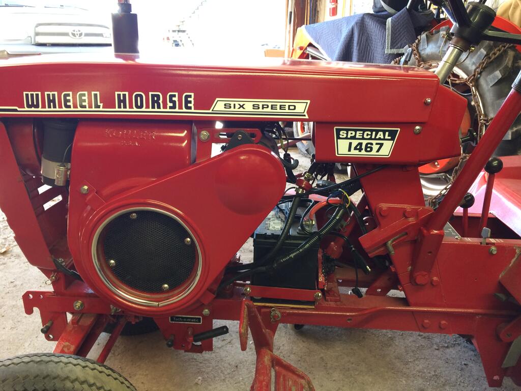

danweikert21 166 #1 Posted April 23, 2021 Hi guys im looking at a 857 to buy wich has a 8hp kohler with a starter generator I've been wanting one for a long time my raider 10 has a k301 12 hp im wondering if I can take the starter generator off the 8 horse and put it on the 12 horse thanks guys Share this post Link to post Share on other sites
squonk 44,859 #2 Posted April 23, 2021 Pretty sure you can as far as the starter/genny itself. The mounting brackets are probably different being from a big block to a small block 1 Share this post Link to post Share on other sites
953 nut 62,971 #3 Posted April 23, 2021 Presuming the Raider's K-301 has a starter/generator the S/G from the 857 will work fine. Mike @squonk types faster than I do. 1 Share this post Link to post Share on other sites
danweikert21 166 #4 Posted April 23, 2021 My k301 does not have a starter generator just a normal starter is unfortunately Share this post Link to post Share on other sites
squonk 44,859 #5 Posted April 23, 2021 Not only brackets but you would also need the flywheel pulley, grass screen, belt cover and shroud from a big block starter gen engine. This engine was a regular starter engine converted like you want 2 Share this post Link to post Share on other sites
953 nut 62,971 #6 Posted April 23, 2021 That would be a lot more involved. You would need - - - - - - - - - - - - - - @squonk did it again! 2 Share this post Link to post Share on other sites
pfrederi 19,241 #7 Posted April 23, 2021 If you you get the shroud from a S/G big block you will have to remove the ring gear from your flywheel. 1 Share this post Link to post Share on other sites
pfrederi 19,241 #8 Posted April 23, 2021 (edited) You can reuse your existing shroud but you will probably have to remove part or all of the Bendix Bump out to clear your battery. Edit: Just realized you are using it on a Long frame you should not have to modify you existing shroud... Edited April 23, 2021 by pfrederi Share this post Link to post Share on other sites
