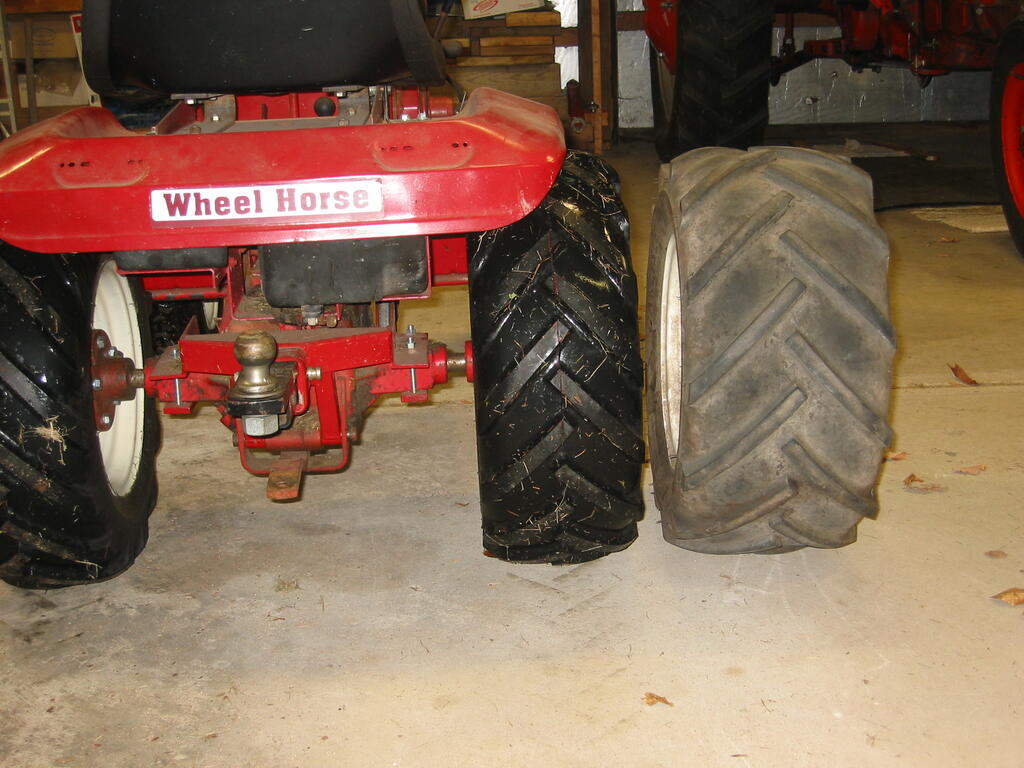

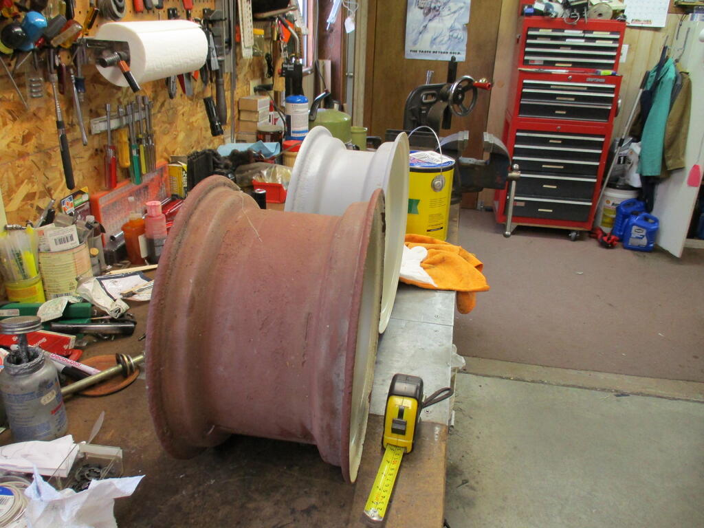

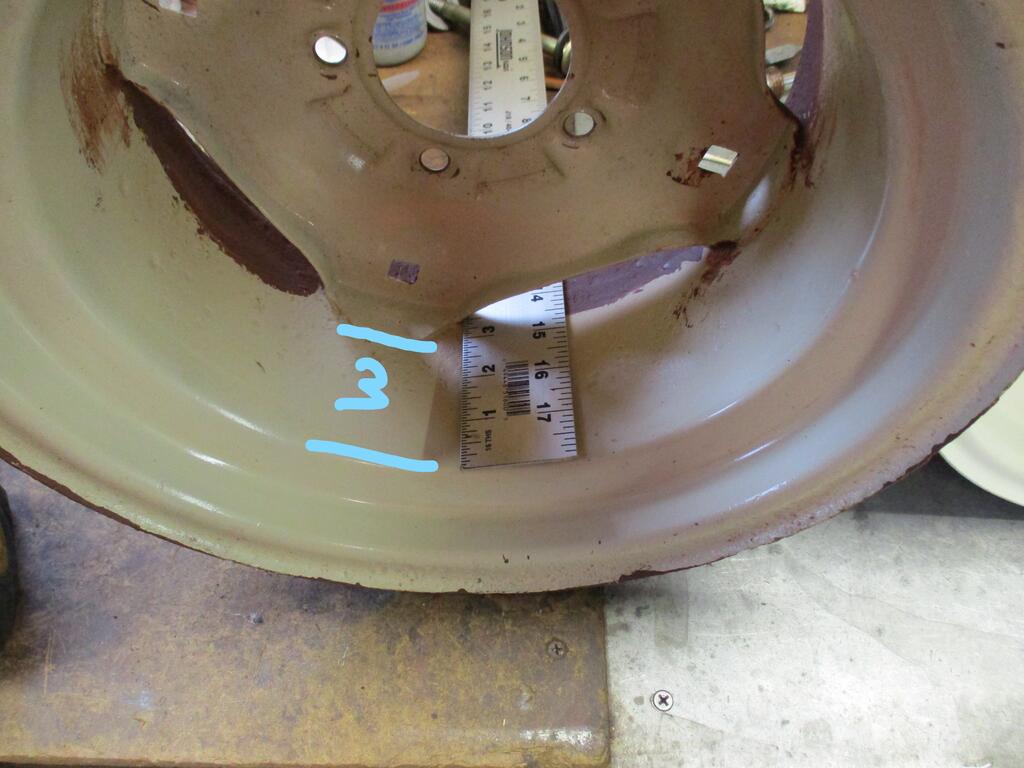

pfrederi 18,334 #7 Posted April 22, 2021 Before you go out and buy any tires make sure you measure your rims. My 310-8 with the 22 7.5 had 5 inch rims....8.50 or 950 are going to look really bulgy on such narrow rims.... Check the distance from the center hub flange to the start of the drop center. if it is about 3" you have the 7" rims if it is about 1" you have 5" rims. (Both assuming 1-3/8" backset.) As far as chains if you have 1-3/8" backset you should be OK Last picture shows clearances with 10.50 12 Ags (Deestone on 7" Carlilse on 8.5") 2 1 Share this post Link to post Share on other sites
