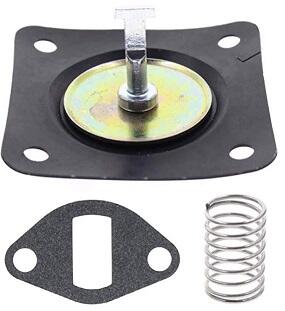

theoldwizard2 2 #2 Posted April 17, 2021 (edited) Opinions on this aftermarket diaphragm from Amazon ? The old one had a cork gasket inside the pump. Edited April 18, 2021 by theoldwizard2 Share this post Link to post Share on other sites
oliver2-44 10,023 #3 Posted April 17, 2021 That rubber one looks like most of the original ones I’ve seen. Good luck with it Share this post Link to post Share on other sites
wallfish 17,143 #4 Posted April 17, 2021 (edited) 1 hour ago, theoldwizard2 said: Opinions on this aftermarket diaphragm from Amazon ? The old one had a cork gasket inside the pump. Is the old diaphragm cracked or have a hole in it? The material they used for them is fairly thick so it's very durable. Since those pumps are mechanically driven instead of just pulse driven from the crankcase pressure, it should work even if it's stiff. The most common failure on those type of fuel pumps would be the check valves not sealing and allowing flow in both directions. I don't think the check valves can be serviced in those plastic pumps but I never had one of those apart either. If you can blow air backwards through the pump, the check valves are not sealing so the fuel would just be moving back and forth in the fuel line and not moving towards the carb. Or at least less of it would be getting to the carb depending upon how much or how little they are sealing Edited April 17, 2021 by wallfish 3 Share this post Link to post Share on other sites
theoldwizard2 2 #5 Posted April 17, 2021 No obvious hole but the metal plate actually has some rust on it. I just replaced all of the fuel lines because they were dry rotted so I figured the fuel pump diaphragm could use it also. 2 Share this post Link to post Share on other sites

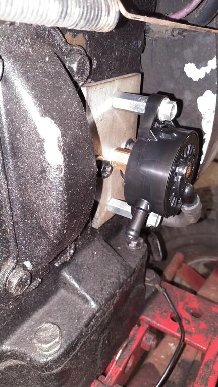

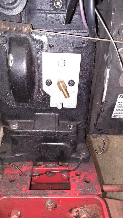

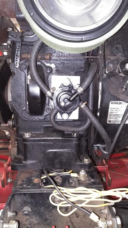

Bill D 2,043 #6 Posted April 18, 2021 I made a metal plate and went this route. Works well. Cheaper than an OEM pump, and less likely to let gas in to the crankcase like the cheap pumps. The pump in the picture is for a Kawasaki, however I prefer the Briggs 808656 pump. Bill Share this post Link to post Share on other sites
theoldwizard2 2 #7 Posted April 18, 2021 8 hours ago, Bill D said: I made a metal plate and went this route. Works well. Cheaper than an OEM pump, and less likely to let gas in to the crankcase like the cheap pumps. The pump in the picture is for a Kawasaki, however I prefer the Briggs 808656 pump. Bill Good idea ! Where did you tap the pulse line into ? The Briggs pump (I am pretty sure) is made by Mikuni. Inexpensive and readily available. Plus it has its own "breather" (no 4th line). Share this post Link to post Share on other sites

Bill D 2,043 #10 Posted April 19, 2021 (edited) Here's a picture without the pump that should help. Bill Edited April 19, 2021 by Bill D 1 Share this post Link to post Share on other sites
