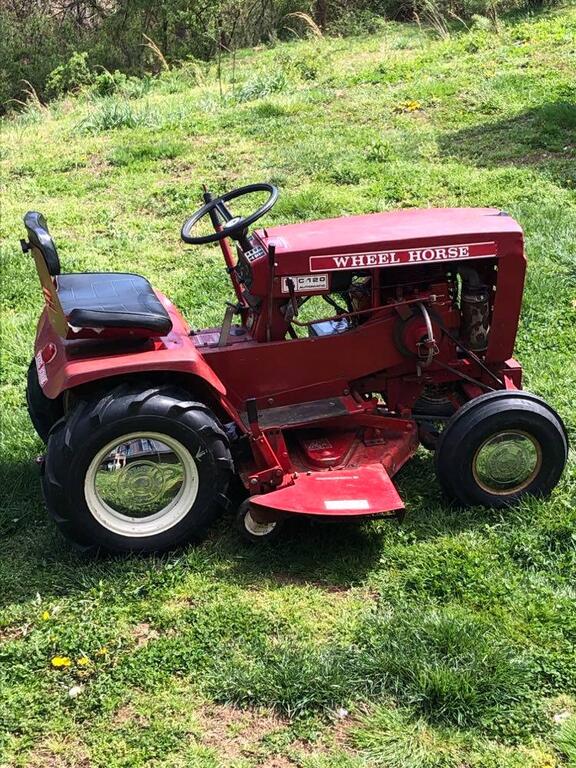

cat man 137 #1 Posted April 16, 2021 well what all do i need to take off to put a new drive belt on a c-120 automatic ? can i get to it by taking off the cover between my legs or is it the side cover on the right side ?thanks 1 Share this post Link to post Share on other sites
pfrederi 18,206 #2 Posted April 16, 2021 Foot plate and side cover 4 1 Share this post Link to post Share on other sites
ebinmaine 69,838 #3 Posted April 16, 2021 While you're in there take a poke around and see how the linkage is feel. Closely check that flat idler pulley. 2 1 Share this post Link to post Share on other sites
cat man 137 #4 Posted April 16, 2021 ok thanks all i figured it be behind the foot and side plate Share this post Link to post Share on other sites
squonk 41,983 #5 Posted April 16, 2021 Whilst checking that idler check the linkage it is attached to including the bushings the linkage pivot rod passes thru the tractor body. 1 Share this post Link to post Share on other sites
cat man 137 #6 Posted April 16, 2021 yes everything is in tacked i found a rat nest i tried to find a pic of how it feeds back in there ? Share this post Link to post Share on other sites
Ed Kennell 39,855 #7 Posted April 17, 2021 Is it on? 1 1 Share this post Link to post Share on other sites
cat man 137 #8 Posted April 17, 2021 yes its in both pulleys 1 Share this post Link to post Share on other sites
