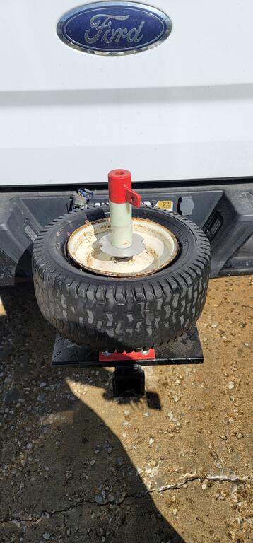

haydendavid380 759 #13 Posted April 16, 2021 23 minutes ago, ebinmaine said: @haydendavid380 A few years back now Trina picked up one of those Harbor Freight manual tire changers. That is not just a tire changer. It is a Life changer. A game changer. Best piece of advice I can give with one of those is to make sure that it is MOUNTED SECURELY TO A FLOOR. Not a pallet like some of the sillies online. She paid about $40 or so for it and it paid for itself, three times over, on the very first day. I have one mounted to 2" square tube I throw in my trucks hitch. I still don't like monkeying with them. 1 Share this post Link to post Share on other sites
