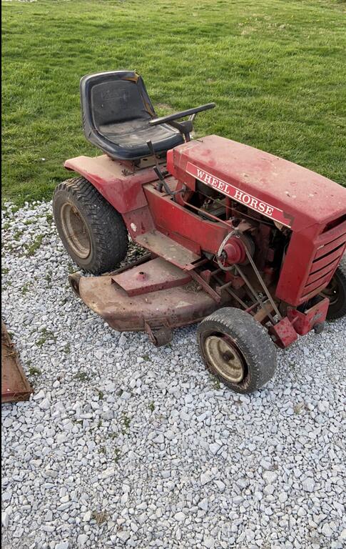

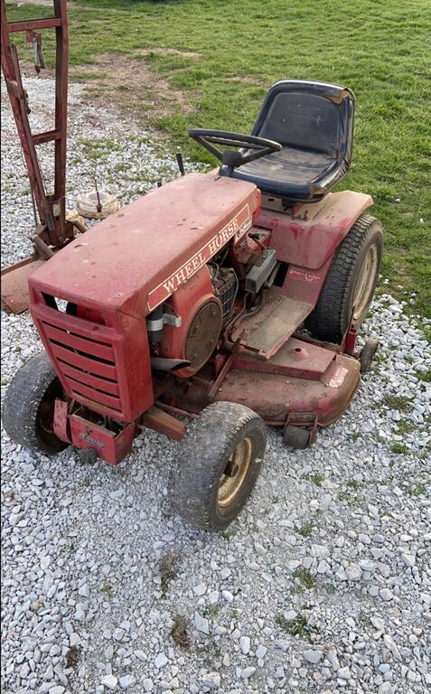

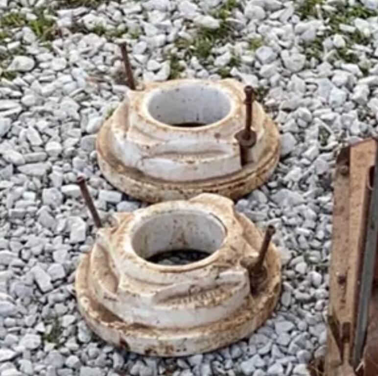

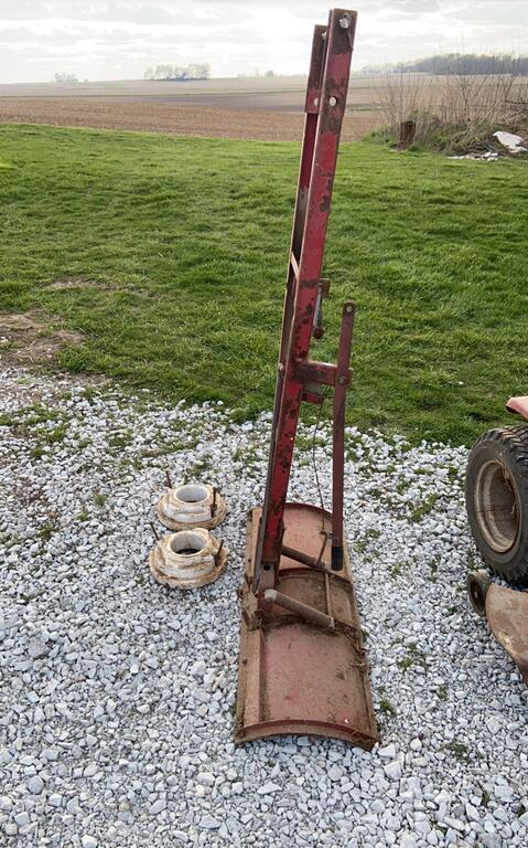

haydendavid380 759 #1 Posted April 15, 2021 (edited) I've been scouring every classified, Craigslist, and marketplace post looking for a C-160 hydro with a lift. Found a fresh ad this morning for a screaming deal on one. Sent the guy a message...it was already pending 😫 Well that guy never showed up, and I sent the guy the money immediately! Seems like it's well worth $400 😁 Looks like I'm going to need a pedal, headlights, a seat, and tires. You guys see anything else? I've got a fancy new seat, a brake pedal, and a pair of Firestone tri-ribs on the way. Side question, anyone recognize those wheel weights? received_234193891601616.mp4 Edited April 16, 2021 by haydendavid380 1 4 2 Share this post Link to post Share on other sites
ebinmaine 69,996 #2 Posted April 16, 2021 So what you did there is buy wheelweights and a plow. You got a 76 or 77 C160 for nearly free. Well done. 5 Share this post Link to post Share on other sites
roadapples 6,983 #3 Posted April 16, 2021 41 minutes ago, ebinmaine said: You got a 76 or 77 C160 for nearly free. Battery is in lower location. 74, 75? Share this post Link to post Share on other sites
ebinmaine 69,996 #4 Posted April 16, 2021 1 minute ago, roadapples said: Battery is in lower location. 74, 75? Battery was there up to 77. No hood ornament - if original - is 76 or 77. 78 + is Cxx1 series. Battery is up top from then on. 2 1 Share this post Link to post Share on other sites
haydendavid380 759 #5 Posted April 16, 2021 59 minutes ago, ebinmaine said: So what you did there is buy wheelweights and a plow. You got a 76 or 77 C160 for nearly free. Well done. Are there any signs that point to the size of the plow? I already have a couple 42"s. Hoping to luck out and get a bigger one Share this post Link to post Share on other sites
evanloock 225 #6 Posted April 16, 2021 Definitely 76 or 77 with the remains of the plastic cover over the hydraulic lift valve. Share this post Link to post Share on other sites
haydendavid380 759 #7 Posted April 16, 2021 For the life of me I can't find any manufacturer that used that cross pattern on the back on their weights. I've also never seen white plastic weights. Here's hoping they're iron 1 Share this post Link to post Share on other sites
Pullstart 63,833 #8 Posted April 16, 2021 2 hours ago, haydendavid380 said: anyone recognize those wheel weights? Yes, thank you! I’ve been wondering where I left them! 8 Share this post Link to post Share on other sites

ebinmaine 69,996 #11 Posted April 16, 2021 6 hours ago, haydendavid380 said: Here's hoping they're iron Odds are they're cast iron. Might be an aftermarket set? Look like they're in the 45 to 55 lbs range. 7 hours ago, haydendavid380 said: Are there any signs that point to the size of the plow? I already have a couple 42"s. Hoping to luck out and get a bigger one Most 70s plows I've seen were 42". You could do a @wallfish style mega plow like I've got from him. A 42. With added sections on both sides. Measures 61" wide. You'll need all the weights and chains you can get. That 16 will have the push. my Cinnamon Horse C160 does well. 1 Share this post Link to post Share on other sites
Pollack Pete 2,273 #12 Posted April 16, 2021 Looks like the C-160 automatic that I have in one of my sea containers.I haven't looked at mine in a couple years.Yours gives me the incentive to maybe check mine out.Yours looks like just a good cleaning and general maintanance and it will be good to go.Have fun with your new toy. Share this post Link to post Share on other sites
haydendavid380 759 #13 Posted April 16, 2021 25 minutes ago, Pollack Pete said: .Yours looks like just a good cleaning and general maintanance and it will be good to go. That's the first thing I thought. It was in a barn and it pretty dirty, but the paint looks pretty good. I too think it'll clean up well. As far as the maintenance, I have a wix 51410 that's supposed to be here tomorrow to change the hydro fluid. Everything else I'll wait and see how it looks Saturday. Share this post Link to post Share on other sites
rjg854 11,762 #14 Posted April 16, 2021 Seems as though someone bypassed the clutch safety switch, if you can start it without depressing the clutch. Make sure to go over the wiring pretty well if it looks like it's original. Maybe something else has been messed with. After all it is 45 years old. 2 Share this post Link to post Share on other sites
haydendavid380 759 #15 Posted April 16, 2021 3 minutes ago, rjg854 said: Seems as though someone bypassed the clutch safety switch, if you can start it without depressing the clutch. Make sure to go over the wiring pretty well if it looks like it's original. Maybe something else has been messed with. After all it is 45 years old. Do they still have a clutch safety switch if they don't have a clutch? Share this post Link to post Share on other sites
rjg854 11,762 #16 Posted April 16, 2021 It's on that left petal, it supposed to put the transmission in neutral. 1 Share this post Link to post Share on other sites

gwest_ca-(File Mod) 11,195 #20 Posted April 16, 2021 The ID plate is just above the lift valve. Post what's on it and will link you to manuals. Garry Share this post Link to post Share on other sites
squonk 42,056 #21 Posted April 16, 2021 13 hours ago, ebinmaine said: Battery was there up to 77. No hood ornament - if original - is 76 or 77. 78 + is Cxx1 series. Battery is up top from then on. My all original 76 C-160 has the hood ornament and flip up fender. 2 things it's not supposed to have . you can't go by the ornament. 2 Share this post Link to post Share on other sites
squonk 42,056 #22 Posted April 16, 2021 3 hours ago, haydendavid380 said: Do they still have a clutch safety switch if they don't have a clutch? Most clutch switches that old are stuck in from rust so the tractor thinks the pedal is depressed and starts. Since your's was missing the pedal I'd say the switch is gone. I don't see it in your video Share this post Link to post Share on other sites
