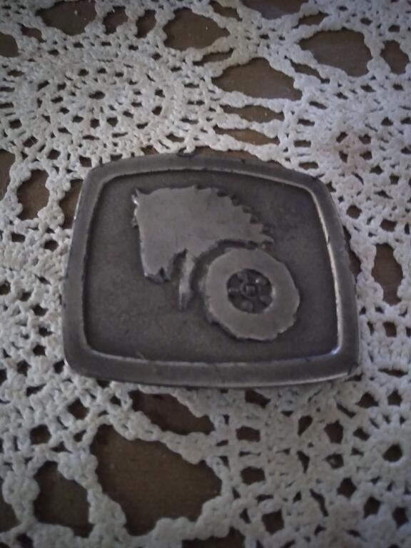

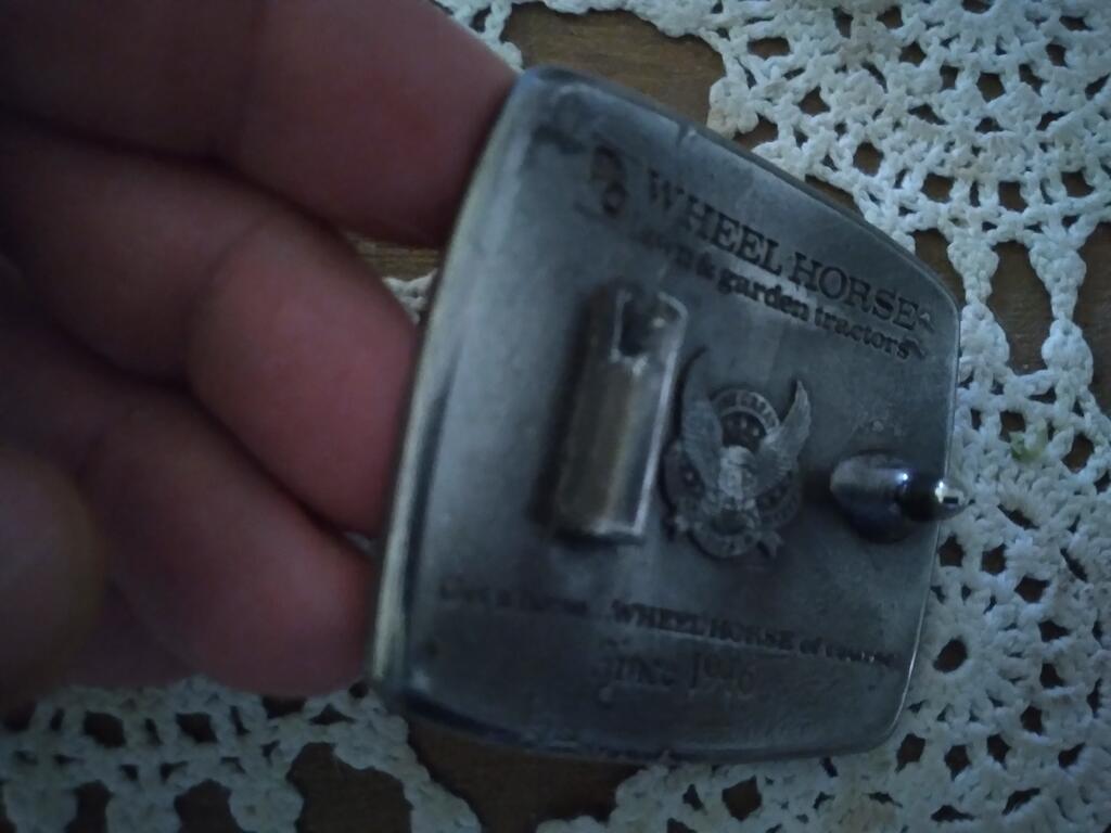

Picked up this Wheel Horse belt buckle but it is need of repair. Anyone have any experience in repairing pot metal? Piece broke off in the back. Missing the ring that you use to attach it to the belt. Be a shame not to make it serviceable again.

The hole dosnt go all the way through.

I would definitely go with JB weld quick metal.
Heating that metal up is way too risky and I would avoid at all costs.
Personally I would cut off the damaged piece, make a tube from a piece of round brass, bend and fit a wire loop and JB weld it in place.
Mick
D_Mac
Thats just what I was thinking.
