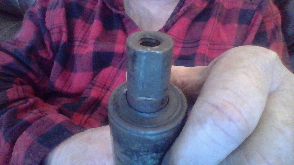

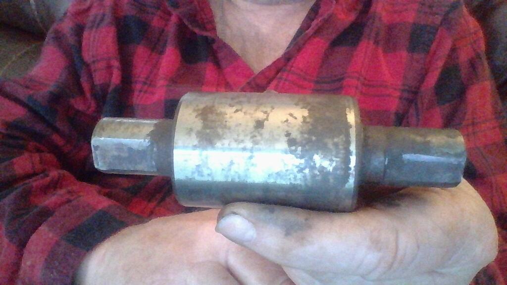

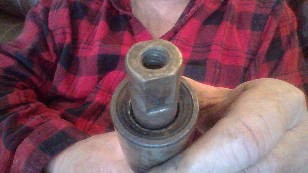

i had 1 spindle that was loose is there 2 bearings in this one on each end i need to press out or do i need to replace this whole part thanks

Generally, you can press the old bearings out and replace them.  Hammer and punch will usually work.  You will want to make sure the shaft is not worn.  If there are seals there, replace them too.
Don't forget the grease when you are putting it back together.
Good luck and have fun.

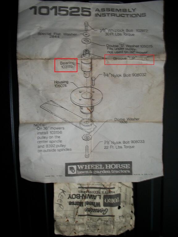

That looks like the 103119 bearing that is no longer available from Toro but Stens and other suppliers still have it.
https://www.rcpw.com/search/?quest=103119
Click on the fuzzy picture in this link for more info

These old decks need to be inspected pretty often - after all they are getting OLD! That bearing should be a common one, when you knock one out wipe the plastic cover and there should be a # there, then just go to the bay and put that # in search.

That is a on-piece replacement part / bearing and is OEM # 103119.  You'll find them on Ebay at around $30 each....or less in sets of 2 or 3.  NOTE... be sure you install a new one correctly...there is a top and bottom and has to be done right.
