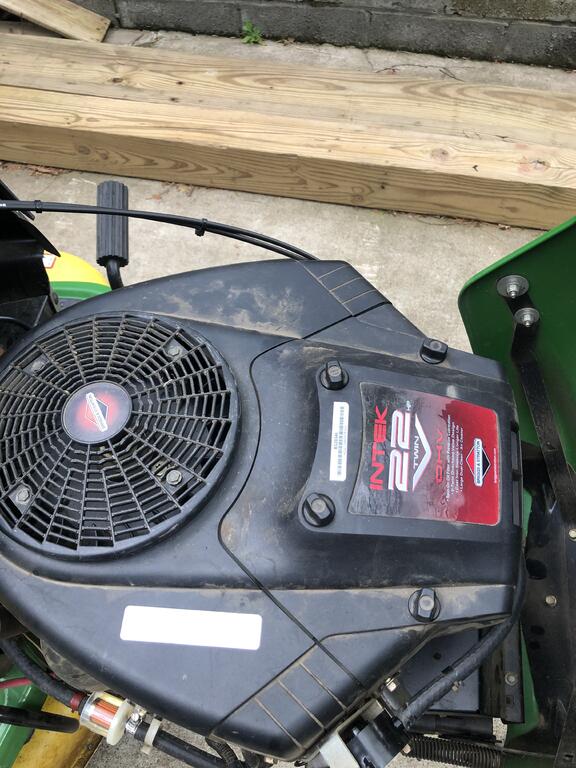

Anyone familiar with the Intek 22 hp
Briggs motor. It hesitates to crank when starting but does start eventually. Is this a valve adjustment on these motors? If so what are the adjustments supposed to be on this motor?

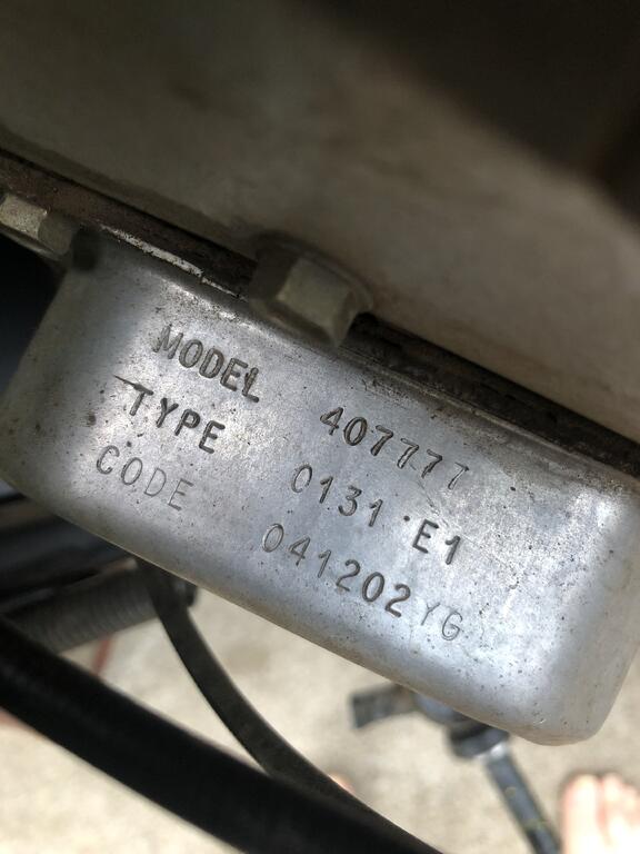

Post the model and code numbers. We may have a manual.
Some the valve adjustment is critical for the compression release to work.

The B&S manual you need is 273521 and we do not have it. Sorry

Yes, these do have adjustable rockers.
And they need adjusting about every 2-400 hours.. or else this happens.
Done quite a few myself.

Yeah, went through this on the snapper 11 Intek. The compression was strong enough to barely allow a pull start. It's a beast! Forget the starter. Simple valve adjustment.
The Tuul Crib
The tractor has 450 hrs on it so i guess
its time for a valve adjustment. Its a real
smooth running motor with not a bit
of smoke. Customer wants another year
out of it and thinking way more than that.
