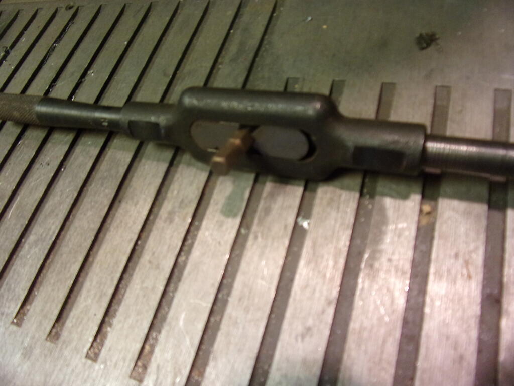

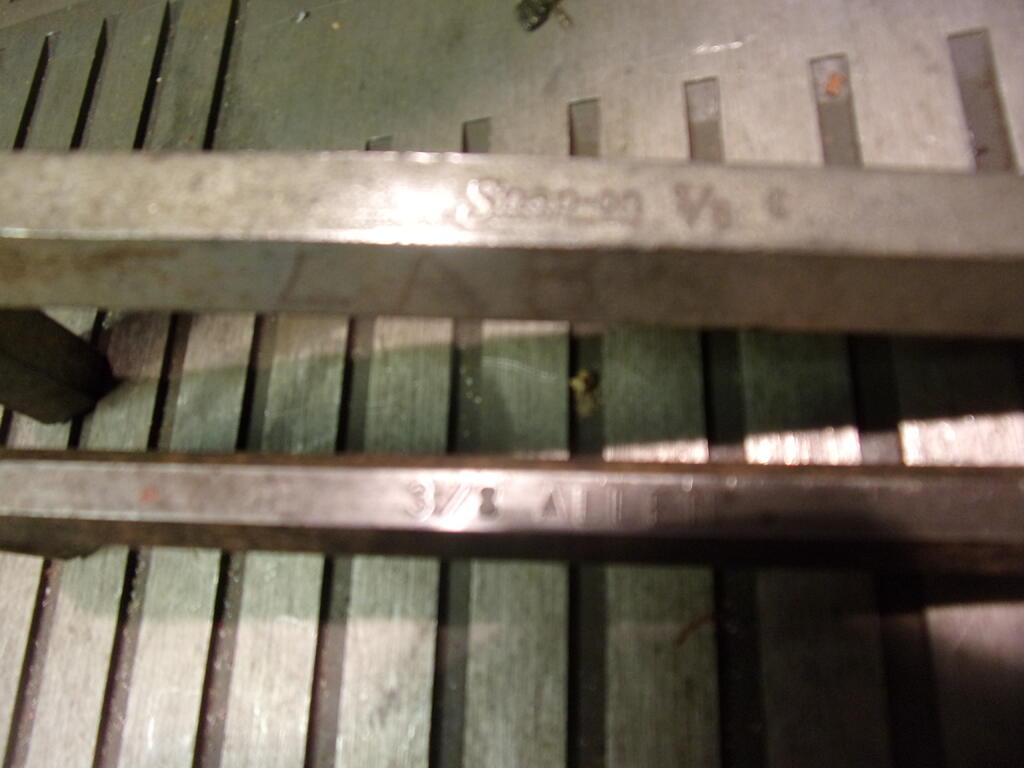

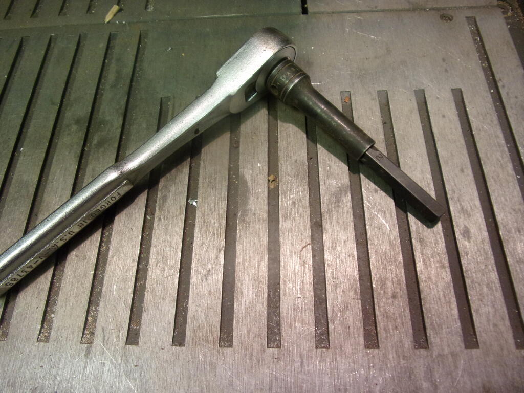

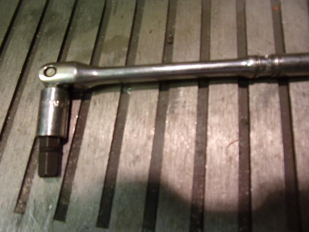

Ed Kennell 39,735 #25 Posted April 6, 2021 Not knowing what tools are available, here are some ideas. The long arm allen wrenches are probably the strongest if they are made by Snap On, Allen, or my favorite, Unbrako. You can add any length pipe handle with out fear of breaking the wrench. I always grind a flat on the ends to get sharp edges and maximum engagement in the bolt or plug head. I have also had uccess using a tap wrench to remove stubborn screws like the philips head screws in the Kohler flywheel screens. Of course a quality high strength rit in an impact socket and a breaker bar or rachet will work. Just a few more ideas. The key is to prevent damaging the socket head making it necessarry to drill it out. Clean the socket head free of dirt Use a quality bit Sharpen the bit Tap the bit in to get full engagement Keep the bit square as you apply torque. 2 Share this post Link to post Share on other sites
