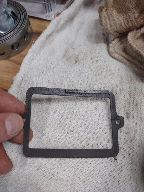

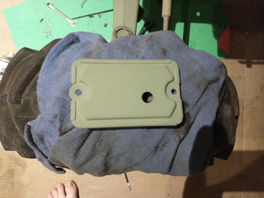

ebinmaine 75,747 #117 Posted August 8, 2021 I took the carb and breather off the Tecumseh 10 this afternoon. I was planning on cleaning up and rebuilding the carb but I have the wrong parts kit. New parts ordered. I'll get it soaking for a few days anyway. The breather was leaking like a sieve out the bottom. Any idea why?? Look at the compression marks in the gasket at the top right corner. On the engine that was the bottom right. Some bright pile of sunshine PO actually left 1/4 of the old gasket in place the last time this was apart. The whole bottom of the breather was seeping oil. 3 Share this post Link to post Share on other sites
Handy Don 15,176 #118 Posted August 9, 2021 (edited) 4 hours ago, ebinmaine said: bright pile of sunshine LOL! That's a new one for me, thanks. My long passed father-on-law was always mindful of his language. He would have called this PO a "chucklehead". Edited August 9, 2021 by Handy Don 3 Share this post Link to post Share on other sites

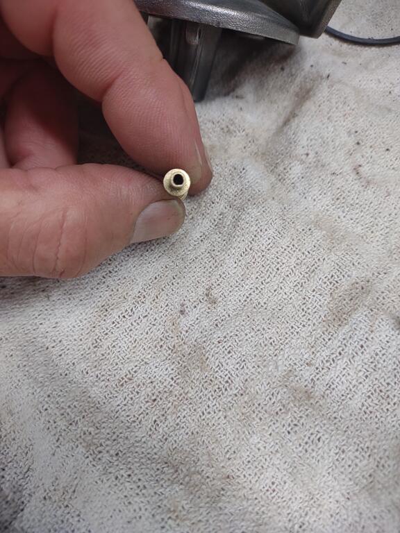

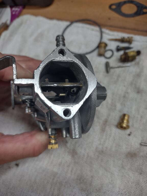

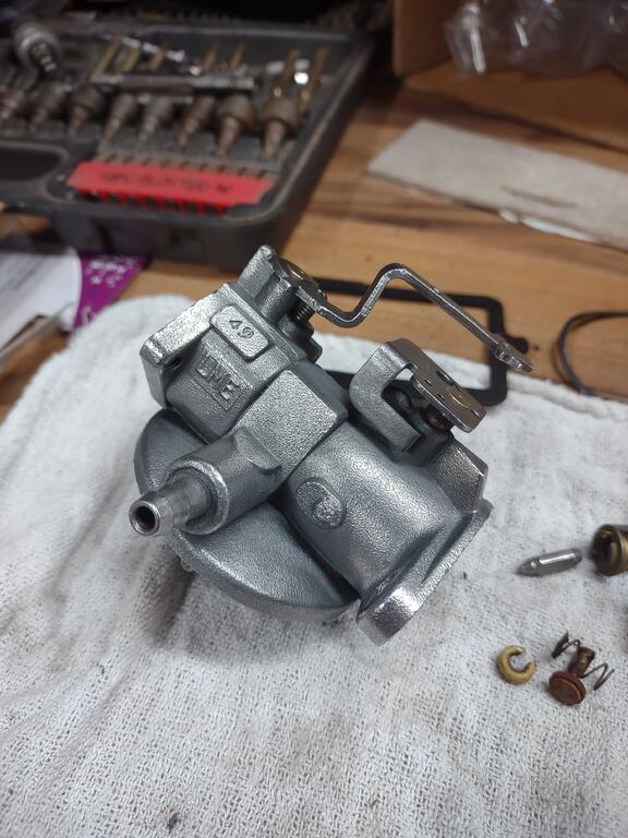

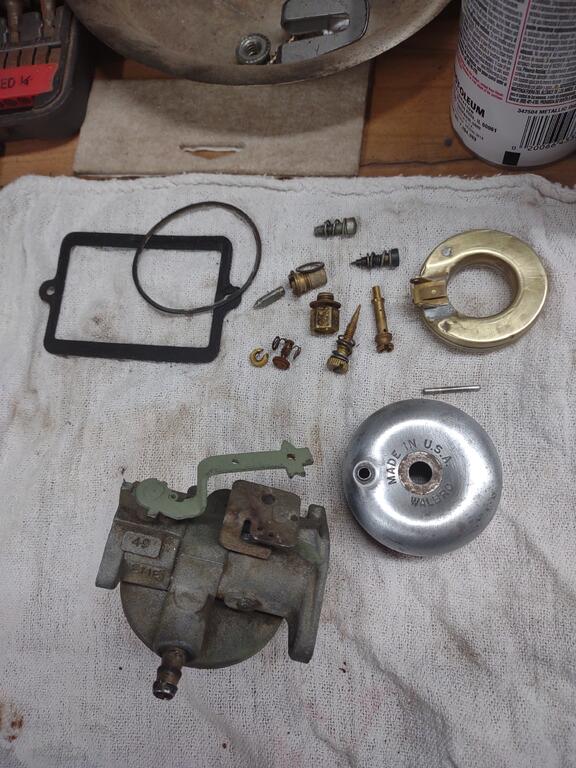

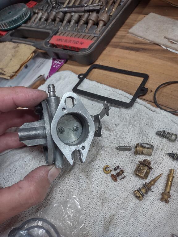

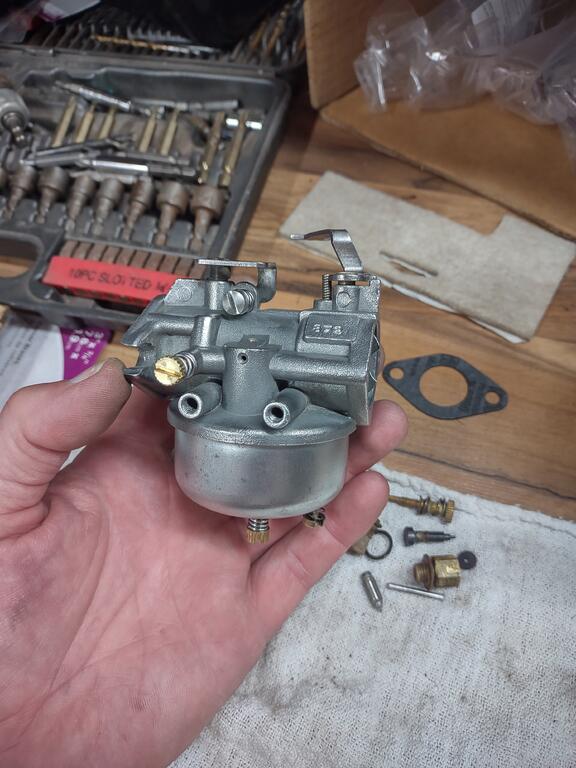

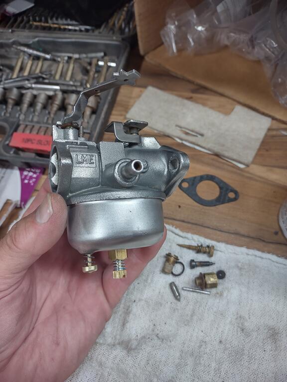

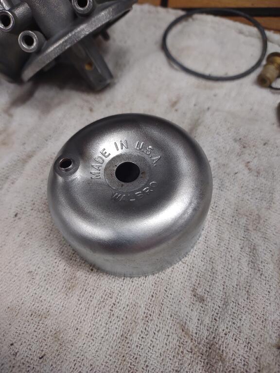

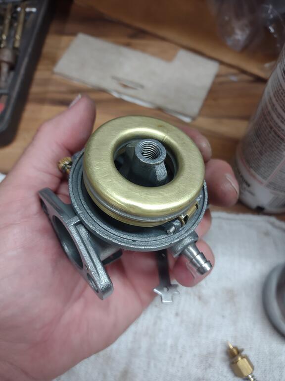

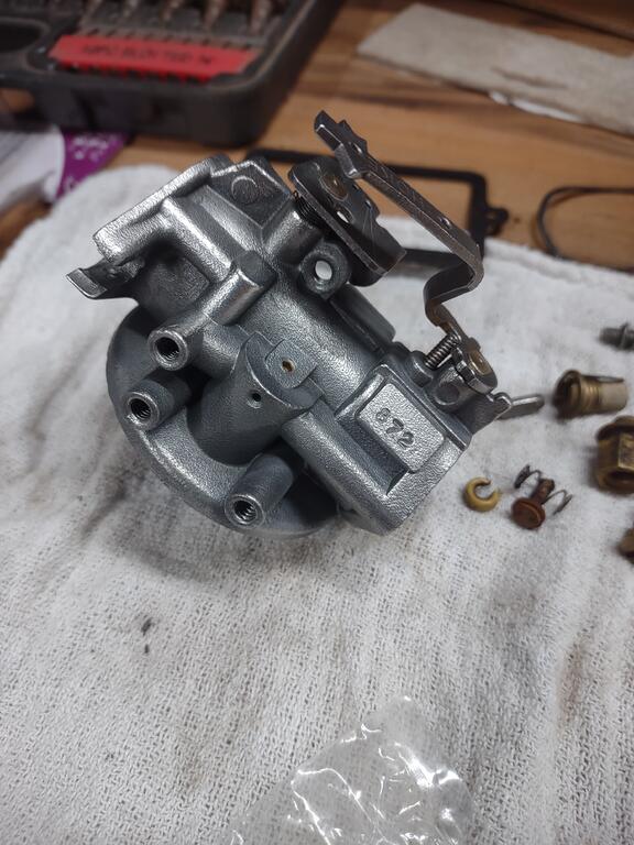

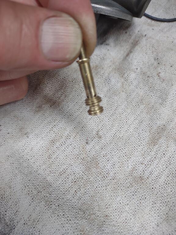

ebinmaine 75,747 #119 Posted September 2, 2021 Trina and I spent some time working on the Military Tribute Tractor "Millie" this evening. I cleaned up the breather in 'n out. She painted it and also the front of the engine where the oil was dribbling and messed the paint all up. I took a bit of time to clean out / clean up the carburetor. Starting with a good hand wire brushing. Followed by a VERY careful touching on the 6" bench grinder with a gentle steel brush. Then lay a piece of new 320 grit paper on the flat of the workbench. Swipe swipe spin. Repeat repeat repeat etc. Nice clean straight gasket mount surface. Clean and wire brush the bowl. Wire brush the small parts the get reused. Here's a comparison for before and after. The main needle gets the same treatment with the 6" wire brush. I found it odd that the end hole isn't round... Here you can see where the main needle sticks up through into the carburetor bore. All polished and reassembled! 4 6 Share this post Link to post Share on other sites

Lee1977 7,456 #121 Posted September 2, 2021 I hope you have the hose from the valve cover to the air breather. Don't have to pull in much dust before you have to clean the carb. again. 1 Share this post Link to post Share on other sites
ebinmaine 75,747 #122 Posted September 2, 2021 2 minutes ago, Lee1977 said: I hope you have the hose from the valve cover to the air breather. Don't have to pull in much dust before you have to clean the carb. again. Good point. This engine didn't even have an air cleaner when I got it but I think I have the whole thing with the hose on a parts engine. Share this post Link to post Share on other sites
WHX?? 53,326 #123 Posted September 2, 2021 Nice carb work EB... you ain't carefull you be our vintage carb guru! Little but that second pic someone may want to go see their podriatist ... I see a a bunion, a corn and a in grown waitin to happen...... thems painful. Nice to see the webbed toes too ..... here I thought I was the only one.... I'll not go ther with pics just now.... picked up a bit of fungus from sloshing around in JC cruzers in ankle deep water at the last show. 2 Share this post Link to post Share on other sites
8ntruck 8,332 #124 Posted September 2, 2021 Bench grinder mounted 6" brush on the main jet? Man, a little slip there, and the brush would flip that little main jet into oblivion. 1 Share this post Link to post Share on other sites
ebinmaine 75,747 #125 Posted September 2, 2021 5 hours ago, 8ntruck said: Bench grinder mounted 6" brush on the main jet? Man, a little slip there, and the brush would flip that little main jet into oblivion. Adventurous. My middle name. I have a brush wheel that's not too aggressive. And a very careful practiced way of handling things on that machine. I do still occasionally fling an item to "Cantfinditville". 2 Share this post Link to post Share on other sites
