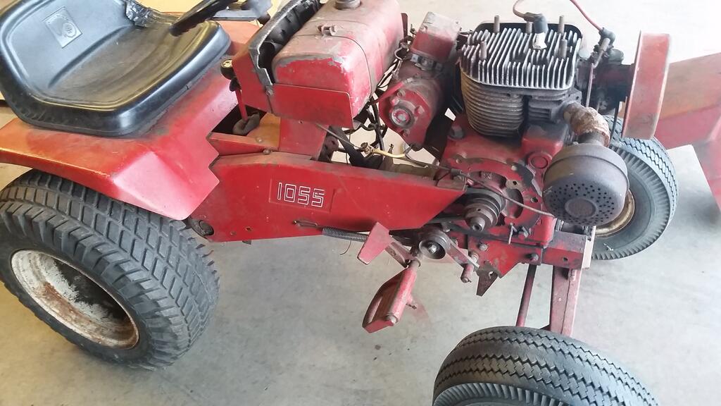

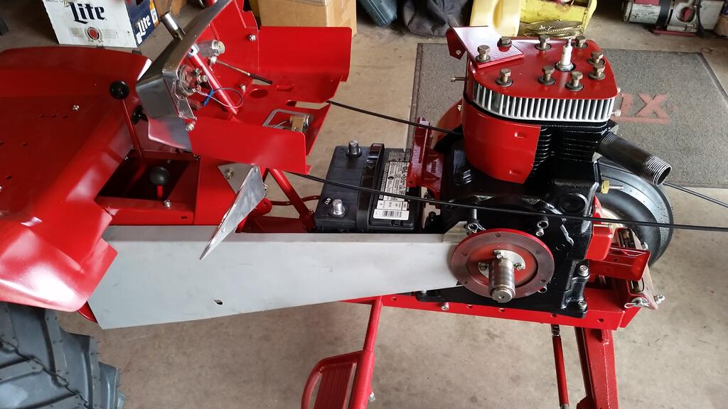

krystolo 504 #1 Posted April 2, 2021 Checking over Rosie tonight and I see that the engine attachments don’t quite match up. Suspect a swap at some point in her life. Opinions? Share this post Link to post Share on other sites

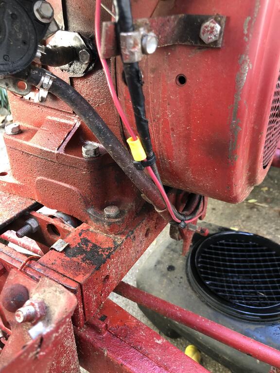

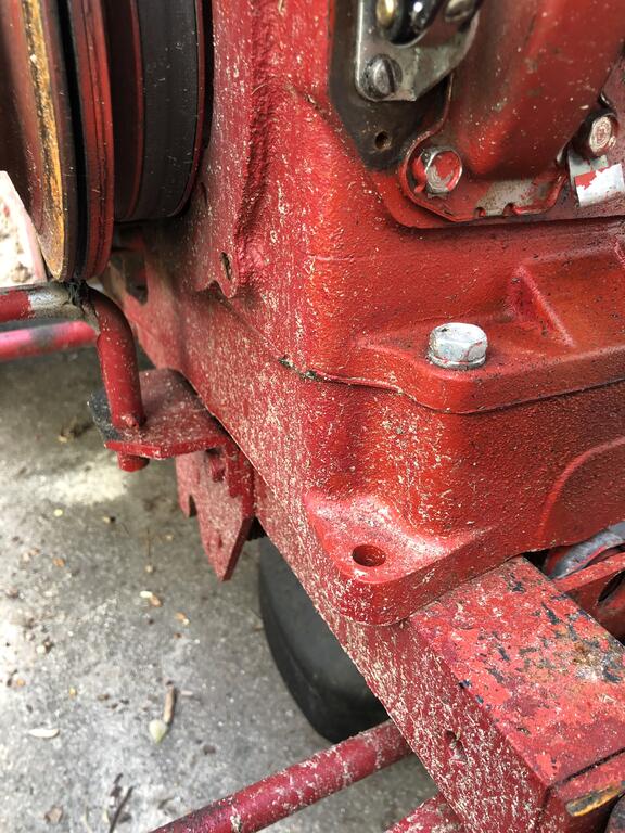

cschannuth 3,817 #4 Posted April 2, 2021 There should be a J bolt through there holding it down to the frame. 1 1 Share this post Link to post Share on other sites
krystolo 504 #5 Posted April 2, 2021 11 minutes ago, cschannuth said: There should be a J bolt through there holding it down to the frame. Should there be J bolts all around, or just on one side? Here’s the other side. Share this post Link to post Share on other sites

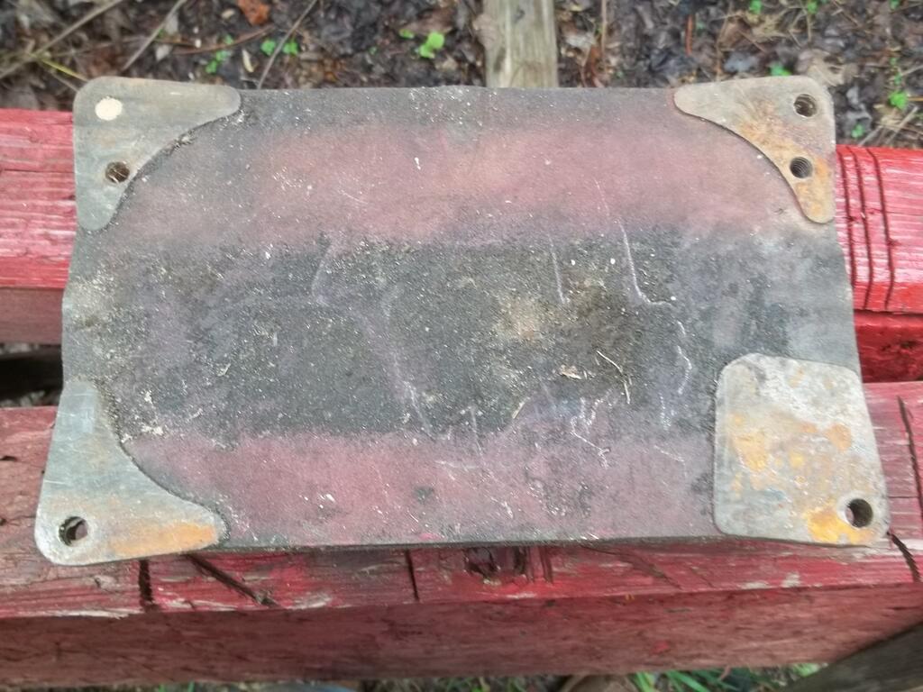

Ed Kennell 39,855 #6 Posted April 2, 2021 There should be two bolts inside the right frame rail into two tapped holes in the pan. 2 7 1 Share this post Link to post Share on other sites
cschannuth 3,817 #7 Posted April 2, 2021 1 hour ago, krystolo said: Should there be J bolts all around, or just on one side? Here’s the other side. On my charger 12 they used two J bolts on the side that overhangs the frame and two regular bolts on the other side. I didn’t even think about the fact that they would put a bolt up through the bottom of the frame into a threaded hole in the bottom of the engine but that makes sense. 4 Share this post Link to post Share on other sites
ebinmaine 69,838 #8 Posted April 2, 2021 2 hours ago, Ed Kennell said: There should be two bolts inside the right frame rail into two tapped holes in the pan. 2 Share this post Link to post Share on other sites
OldWorkHorse 3,049 #9 Posted April 2, 2021 (edited) 9 hours ago, ebinmaine said: Learned that the hard way! Always thought just 2 bolts held the engines on my horses... till I tried winching a engine off after removing the 2 bolts you can see and the frame still lifting with the motor! That's how I found the 2 hidden bolts! Edited April 2, 2021 by OldWorkHorse 3 2 Share this post Link to post Share on other sites

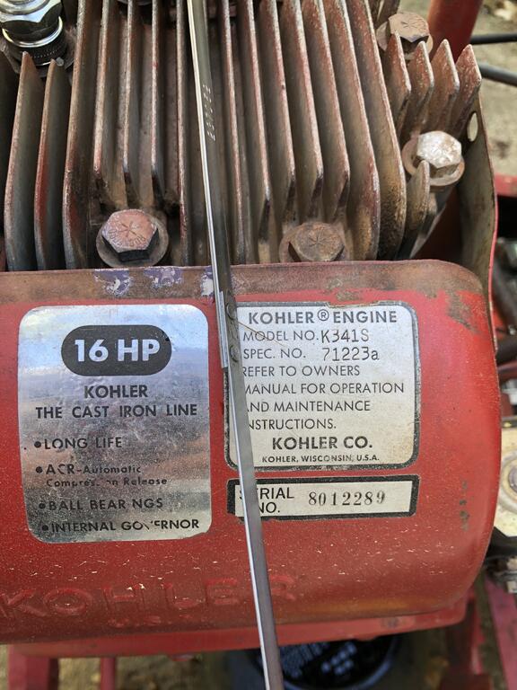

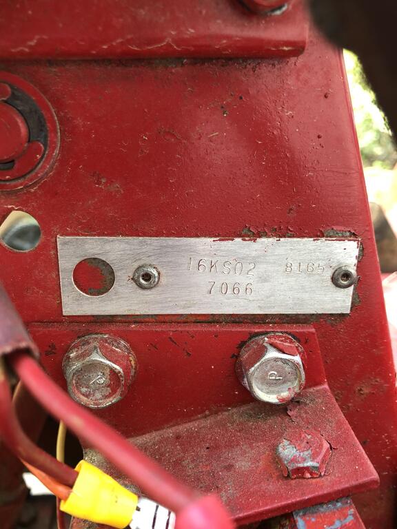

gwest_ca-(File Mod) 11,187 #10 Posted April 2, 2021 The engine has the correct spec number and Kohler built it in 1977. The tractor was scheduled to be built 008165 - Build date 1977 7066 March 07 Monday Garry 2 1 1 Share this post Link to post Share on other sites
Tuneup 1,433 #11 Posted April 2, 2021 I didn't notice that offset with the '77 120 until I went to reinstall the engine and scratched my head for a while. It doesn't fit any other way. Call it a big block and be happy with it 1 1 Share this post Link to post Share on other sites
953 nut 56,838 #12 Posted April 2, 2021 8 hours ago, Ed Kennell said: There should be two bolts inside the right frame rail into two tapped holes in the pan. This is what the oil pan looks like from below. 9 1 1 Share this post Link to post Share on other sites
The Tuul Crib 7,338 #13 Posted April 2, 2021 10 minutes ago, 953 nut said: This is what the oil pan looks like from below. 2 Share this post Link to post Share on other sites
The Tuul Crib 7,338 #14 Posted April 2, 2021 I did the same thing when I got my first horse. It looked a little odd because I thought once It wasnt bolted down. I have even drilled holes now in oil pans and threaded the holes just for this purpose. Share this post Link to post Share on other sites
krystolo 504 #15 Posted April 2, 2021 2 hours ago, Tuneup said: I didn't notice that offset with the '77 120 until I went to reinstall the engine and scratched my head for a while. It doesn't fit any other way. Call it a big block and be happy with it HAHA! I just thought it was odd that it looks like it doesn't belong there. I'm thrilled with her! Just love her to pieces. Well, hopefully not to pieces. LOL 1 2 1 Share this post Link to post Share on other sites

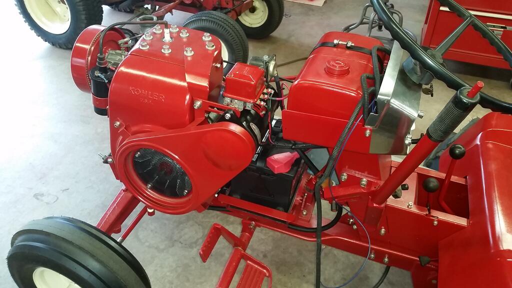

Mikey the Monkey 697 #21 Posted April 2, 2021 (edited) @krystoloLooks like maybe you should put in a want ad for the top engine tin to help with keeping the head cool. Unless you just temporarily removed it. Edited April 2, 2021 by Mikey the Monkey 3 1 Share this post Link to post Share on other sites
krystolo 504 #22 Posted April 2, 2021 (edited) 20 minutes ago, Mikey the Monkey said: @krystoloLooks like maybe you should put in a want ad for the top engine tin to help with keeping the head cool. Unless you just temporarily removed it. Dumb question... what is that? ohhh! Is see! A little cap over the fins. So that helps keep it cool? Edited April 2, 2021 by krystolo 1 Share this post Link to post Share on other sites
ebinmaine 69,838 #23 Posted April 2, 2021 15 hours ago, krystolo said: 6 minutes ago, krystolo said: Dumb question... what is that? ohhh! Is see! A little cap over the fins. So that helps keep it cool? The whole top of the engine in the picture just above this should be covered with a piece of sheet metal If you don't have one on there it would be a great idea to procure one ASAP from either one of our members or a to z in Pennsylvania 1 Share this post Link to post Share on other sites
The Tuul Crib 7,338 #24 Posted April 2, 2021 48 minutes ago, stevasaurus said: This Case is solved. Wow she looks like one of the munsters! 1 1 Share this post Link to post Share on other sites

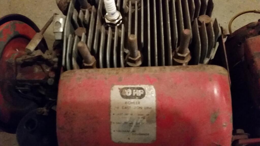

WHX?? 49,969 #25 Posted April 2, 2021 (edited) Some one swapped the head out. It should have what we call a high boss head meaning where the head bolts are then even with the top of the fins. So the head tin goes like this. Last pics is a low boss head with all sorts of PO goofyness goin on. Edited April 2, 2021 by WHX24 1 Share this post Link to post Share on other sites
