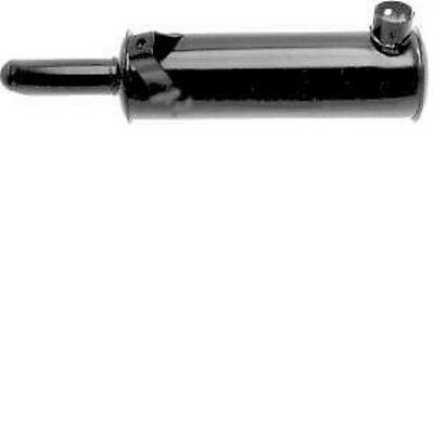

Some use this cub cadet muffler available on amazon/ebay for around $50

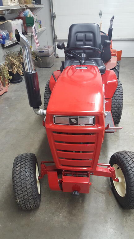

A member on here Jimmy Kemp makes/sell these very nice heavy duty stacks for roughly $100-$120

That Cub muffler is really a good deal not only for the price under $50, but it is VERY adaptable and can be made to fit many (most??) of the horses with minimal effort, plus it has good "tone"

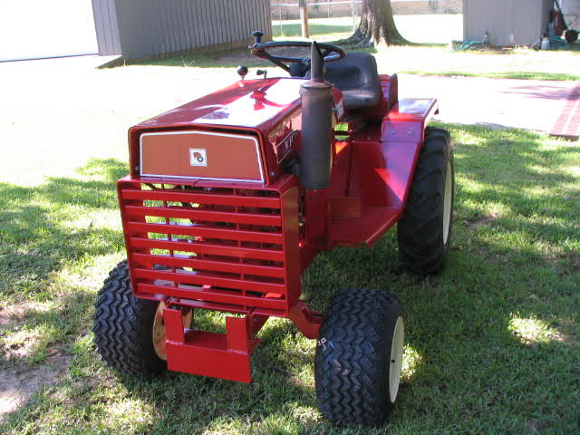

Here it is adapted to a K341 on a D160

On my own Cinnamon Horse c-160 I have one of the above mentioned Jim mufflers but with a very tall outlet. Like it quite a lot.
