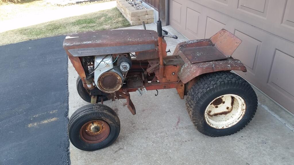

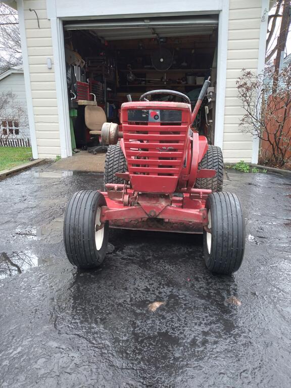

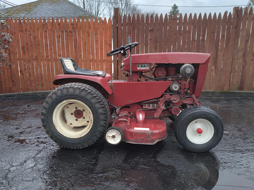

Ok, So I bought this tonight... Now what??
squonk
That's because it doesn't run and who knows if the trans is any good. I think that belt is 1/2" x either 28 or 29"

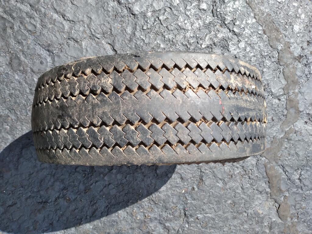

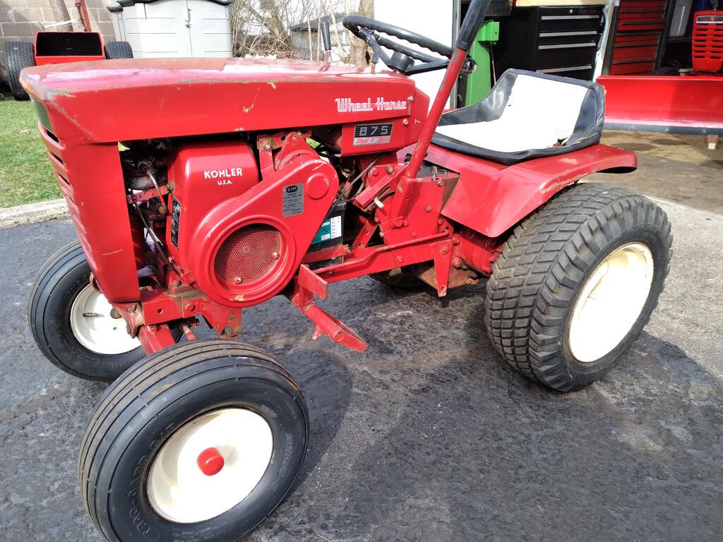

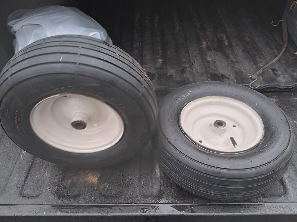

Ok so my plans for bringing it over to a friends house fell through this morning. I did pick up the tires and got them mounted on the rims. Figured I would put some paint on them since they were off. Not my best work but better then before. I had to get 16 x 6.5 - 8 for it. Kinda wide. Tires I took off were 16 x 5.5 - 8. Was told that size was no longer made. Waiting on a steering wheel from @76c12091520h. Be a lot easier to move around. Price just went up !
  • Like 5
WHX??
Can never go by the tire size that were on it. Who knows what a PO did. Orginals would have been 16/6.50-8 with a sawtooth tread. WH molded in the side. See pic below.
Replacement tires are like a box of chocolates that my wife eats..... you never know if they are gonna go on high or wide till she eats them. :lol:  Those do look a little wide and ballonish but not terrible.
Good luck replacing the steering wheel you might need it.
Odd that it was broke like that. You know there are steel bars under that covering... just how does a PO abuse it that bad to break them?!?!  Just picked up the same tractor in '66 flavor with the same broken wheel.

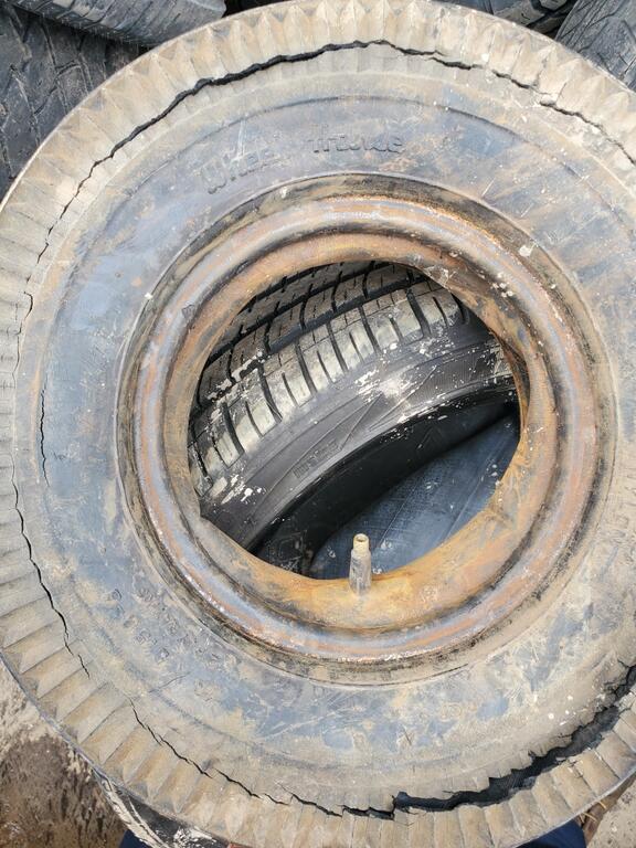

The tires I replaced i believe to have been original. The said Wheel Horse on the side of them.
  • Excellent 2
WHX??
You just threw a monkey wrench in here Mac ... do those tires have WH molded into the sides? Yes you said they do. I only collect pre 67 and all of the '65  ones I have had come thru were 16/6.50's  I have never saw that size on the many 65s I have had come through my stable.
Interesting but going back in time would have thought  the Ponds would have used the same molded tires in 16/6.5 from let's say to early 64/65 through  maybe 1970? Surely the same rims that 6.5's would have come from the factory wirh?
   Guess I'm not going to call your pics fake. Another reason we like our pics here thank you sir.
Keep in mind here early 60's here on out were the boom years for :wh:. and they did that by keeping their manufacturing costs low and sales up due to using the same parts throughout those years.
True that tire size is long obsolete. You got me thinkin here and  doing some more research here. Keep in mind that is a special tractor you have ther since first year made.

Yes they did say " Wheel Horse" on the fronts. I would take a picture but I dont have them anymore. When I seen the Wheel Horse on the fronts I looked at the rears and the rears no not say Wheel Horse. They are labeled Goodyear. My nieces husbands family own a auto recycling place ... AKA Junkyard. He ordered the tires for me and mounted them on the rims. I can see if he still has them. I have no history on the machine to know if they are original tires and wheels to that tractor

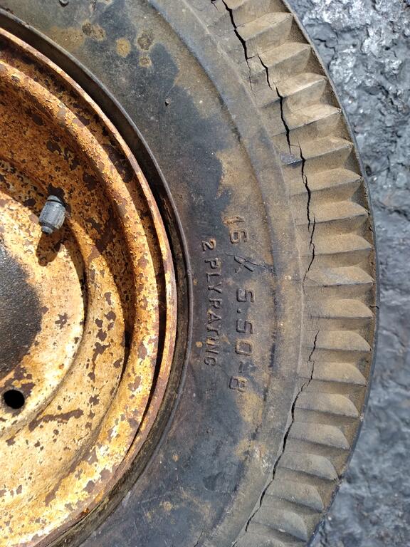

All of the tractors I've had that were in the 60's had 16x5.50x8 tires on them. Branded :wh:   I've got a few of them as back-ups.  I like the saw-toothed tire because they seem to hold the roller chains on them better.
Got the same ones on my 1257! Had to re read tire size like 2x never seen the 5.50-8

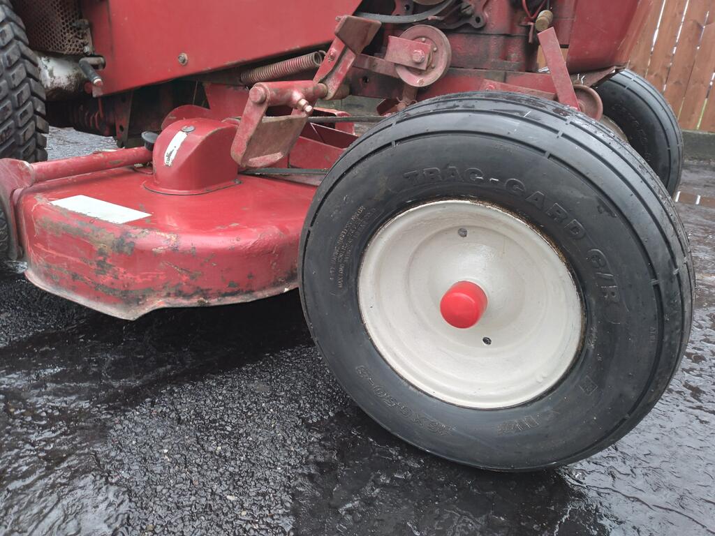

Here they are
WHX??
Just checked my 876 and by golly they are 16/5.50s ! I have a dozen mid sixties tractors most with original tires and all but this one have 16/6.50s.
pfrederi
Interesting by 68 all the charger /electros had 16 x 5.50 .    Parts manual for an 856 shows 16 5.50 x8 with a wheel part number 5635 same part number on Commando 8's and Charger electros.
