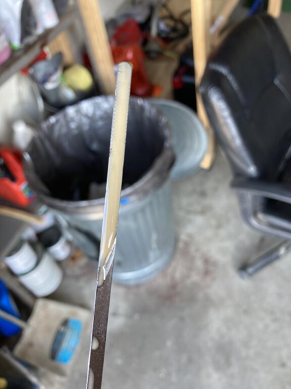

Well it was my dads until he passed away last June and he left it outside most the time. It is new to me. I just drained all the gas out of it and it is running fine after I let it warm up. It happened after it sit all winter long.I store it in a garage now. I haven’t did any changes to it besides new tires and a new filter on it. I plan on changing the spark plug and wire. The oil probably needs changed since it’s been bout 6 years since my dad did it. What type of oil should I use ?  Almost I included a picture of the rear end fluid I think. Is that color normal ? Thanks for the help. I’m new to this so I’m trying to learn.
Ed Kennell
That milky color is a sign of water in the trannsmission.     Probably leakeed in around a cracked shift lever boot while it was stored outside.      when you are ready,   We can offer details on the drain and flush process

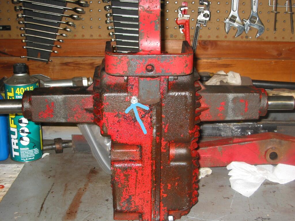

Is this the drain plug ?
The Tuul Crib
:text-welcomeconfetti:T😎:rs:
Nice lookin tractor! Cant find one that
nice around if l can find one!
The drain plug for the trans is on the
bottom . It takes a 1/4 inch alan wrench
pfrederi
Drain plug viewed from bottom.

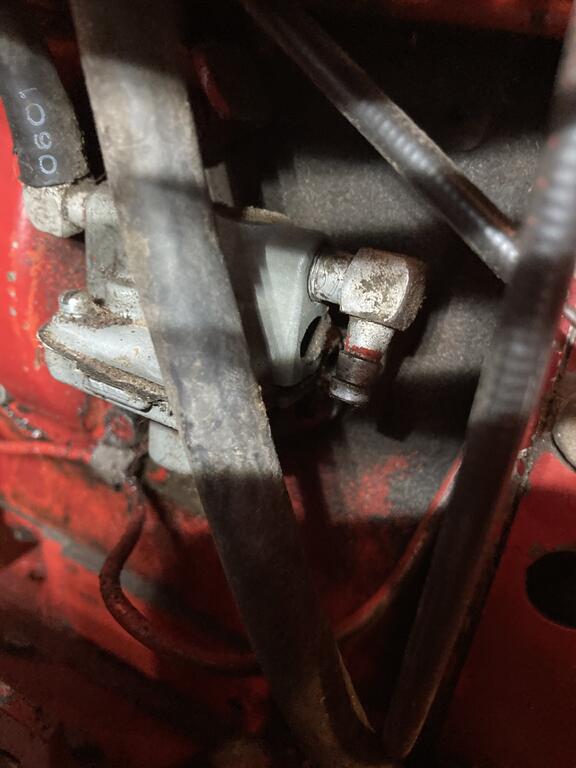

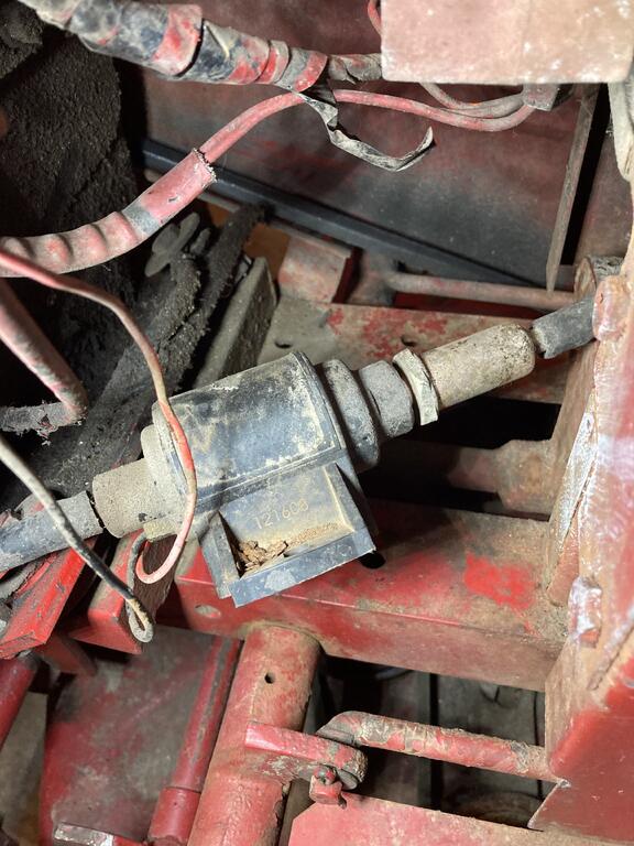

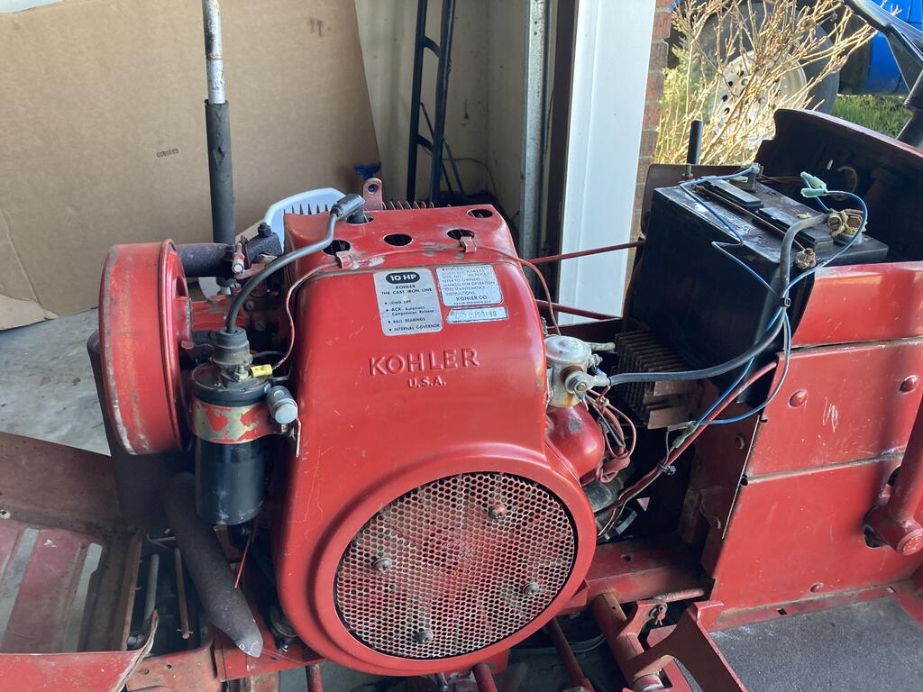

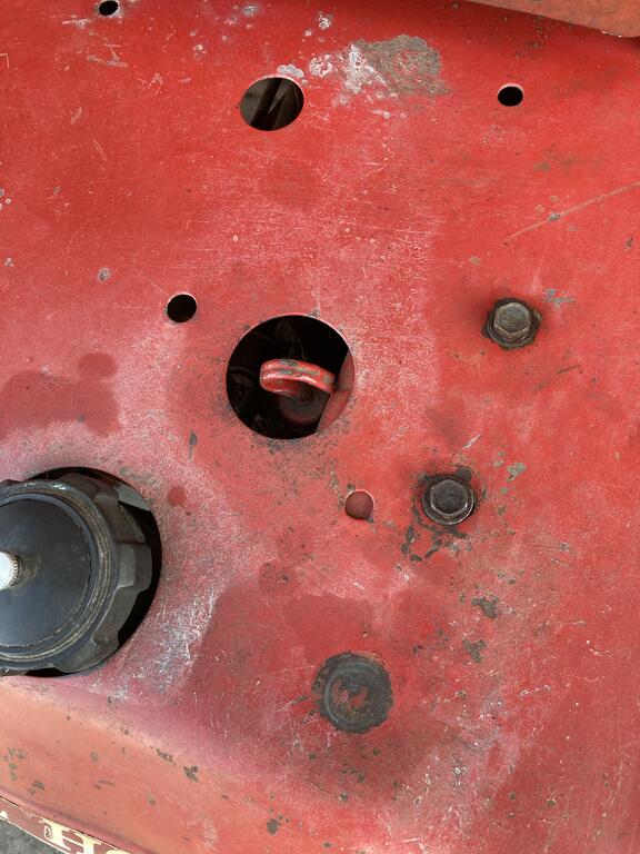

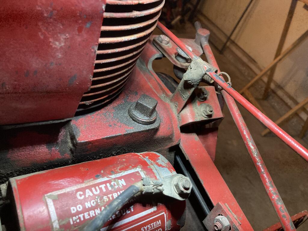

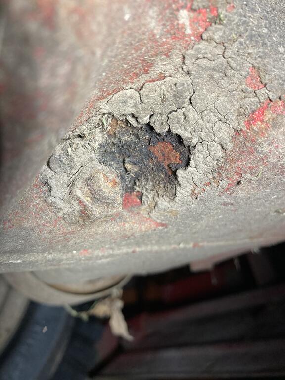

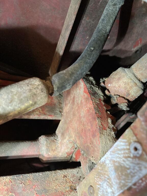

Also is that square bolt where I fill the oil after I change it? I can’t find the drain plug. The 2nd picture. Is there suppose to be a hose attached there? 3rd picture. Can I grease that for my steering wheel to turn better? And the 4th picture. Is that a fuel filter or pump? Thanks for all the help. Sorry about all the questions l
Ed Kennell
Picture 1.    that is the engine oil fill        the drain plug is on the side near the bottom   I don't have my 10hp kohler here to tell you exactly where on the bottom
2. that is the mechanical fuel pump that has been disconnected and not used
3. that steering gear must be cleaned and greased
4. that is the electric fuel pump that has replaced the one in picture 2

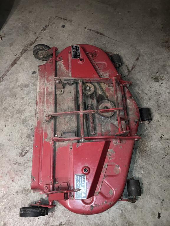

Okay I’m sure I can find the drain plug. I took my mower deck off to make it easier to find. I was trying to take my mower blades off but they are stuck pretty good. I soaked the bolts with PB blaster and hopefully that helps

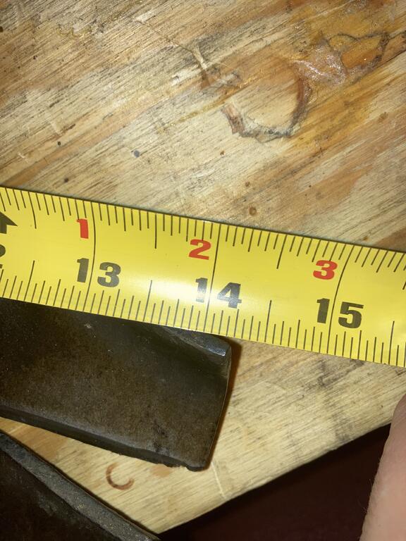

I’m trying to find blades for my mowing deck. I think I have a 42 inch deck and I think the blade side is 14 1/4. I see they have 14 1/2 but it looks like the blades would hit when they turn. Anybody have any sites to order them. I was looking on eBay. I’m trying to find a good mulching blade.
