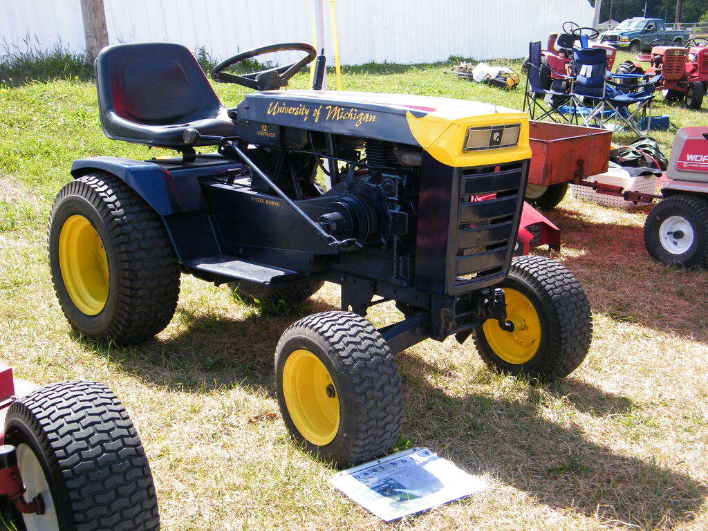

stevasaurus 23,065 #22 Posted March 28, 2021 No problem Mate. I might have welded a plate to get rid of a Tecumseh also. What I was referring to more, was we have had some very young members that not only destroyed horses, but enjoyed telling us about it and posting videos. You don't have to re-build one to abuse it...I am just all about the abuse. I did see one once that was painted in University of Michigan colors. That was disgusting. 1 3 Share this post Link to post Share on other sites
