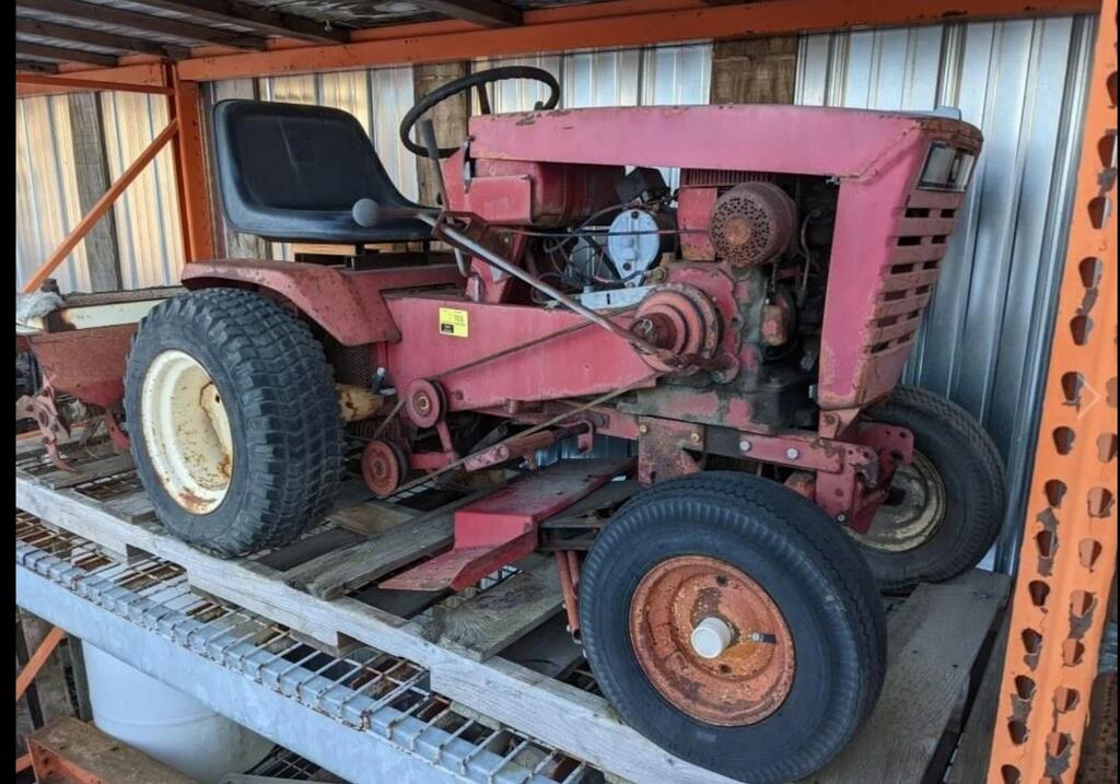

haydendavid380 759 #1 Posted March 22, 2021 Looking at a tractor sight unseen and I'm trying to narrow it down. I'm assuming it's a 1276 or 1277. What do you guys think? 1 1 Share this post Link to post Share on other sites

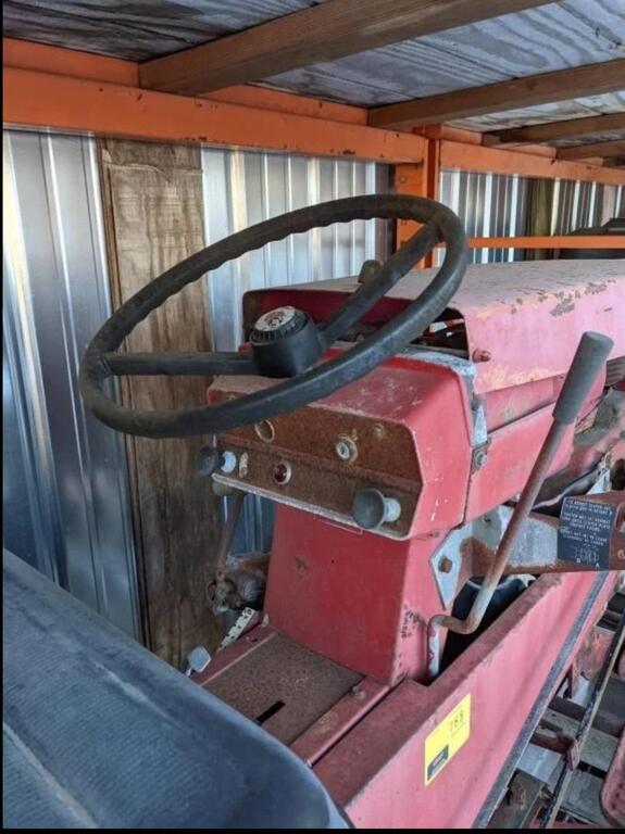

Achto 28,577 #2 Posted March 22, 2021 (edited) Not a 1277. The parking brake handle moved up to the center counsel in 1967. This one has the parking brake located down low on the right hand side like the '65 & '66 models. Edited March 22, 2021 by Achto 1 Share this post Link to post Share on other sites
953 nut 57,471 #3 Posted March 22, 2021 If it started life as a 12 HP it is not a 1965 so guess it must be a 1276. 2 Share this post Link to post Share on other sites
Pullstart 64,362 #4 Posted March 22, 2021 Man these dudes are good! Share this post Link to post Share on other sites
squonk 42,279 #5 Posted March 22, 2021 Also the motion lever indicator slot eliminates 67 I believe. 1 Share this post Link to post Share on other sites

Stepney 2,342 #9 Posted March 23, 2021 Don't forget the steering wheel too, 1967 long frames got the large wide 2 spoke with a small cap, 64-66 had a smaller but similar looking wheel. Difference is very obvious when you see them side by side. Share this post Link to post Share on other sites

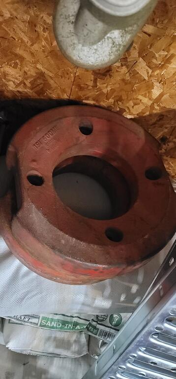

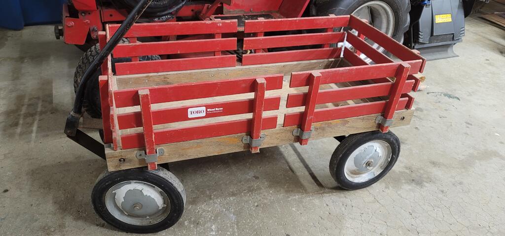

haydendavid380 759 #10 Posted April 10, 2021 Welp, I bid up to $250 on it. The hammer price was $275. I wasn't willing to go any higher with a 16% buyers premium and 8% sales tax on a tractor I hadn't seen in person. I did manage to pick up some very heavy wheel weights (that don't fit anything I have) and a wheel horse wagon. Share this post Link to post Share on other sites
