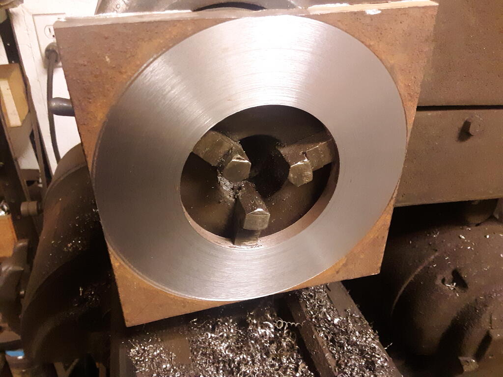

Started on the new rear wheel centers tonight.

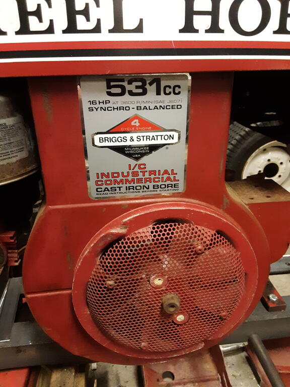

It's almost time for a wire harness.  Wiring is my least favorite part. My Briggs has a 2 wire plug  coming from under the blower housing. I assume it is from the charge coil and one would be accessory power. The other would be for charging,going to the battery side of the solenoid?
Gregor
Don't know much about Briggs, but I don't think thats right. I have been wrong before though. The plug would go to a voltage regulator/rectifier. AC into the rectifier, DC out to the battery.  But don't take my word for it.
  • Like 2
ebinmaine
PITA but the best way is to find a machine that uses that engine and get a wiring schematic diagram.
Could be DC wires. Could be one's a kill/ground. Could be neither of those is true.
How thick is that bad mama jama?
  • Haha 1
Oldskool
In that pic about 3/8". Its thinner now. I should have more pics of it and a rear wheel later today.
There is a kill wire attached to a stud somewhere near the governor linkages.

19richie66
My wheel centers are 3/8” plate. Figured that much more weight would be good. Be interesting to see what you end up with. Everything else looks great so far.

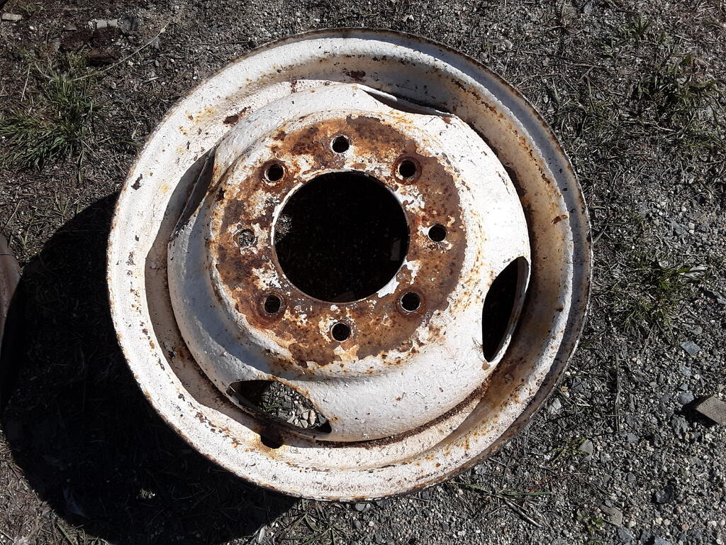

Just picked up my new to me wheels.
  • Like 2

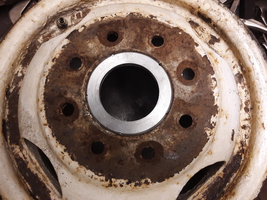

Oldskool
The original 8 holes will get welded in. Then these will then  be welded in,ground down. Then drill the new  holes. That keeps the wheels  hub centric. They also give me the wider stance I'm looking for. About 41in. outside egde of tire to outside edge of tire.

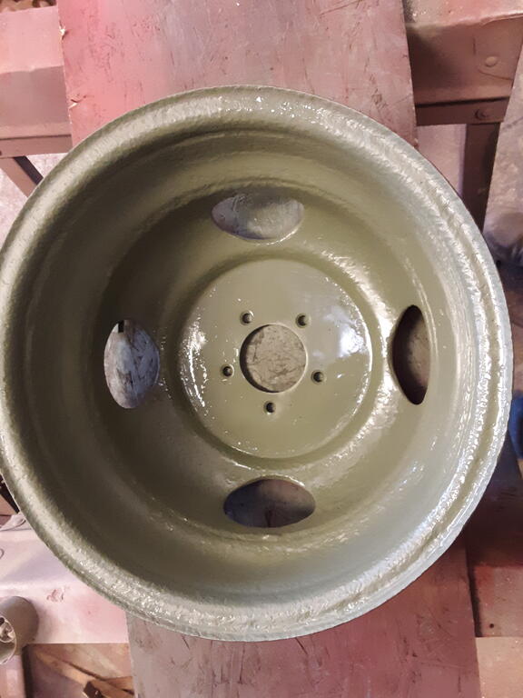

Oldskool
Almost ready to mount a tire.
  • Like 1

ebinmaine

DennisThornton
Missing a few steps...
Oldskool
Missing some steps??
DennisThornton
And some holes too.  Welding, grinding, sanding...
  • Excellent 1
Oldskool
Woops. That's so unlike me. I'm ussually caffeine free, I had one of those frappuccinos and just got whirling around in the garage and forgot.
  • Like 1
  • Haha 3

ebinmaine
Hey can you give a short tutorial about how you fill those holes with weld?
