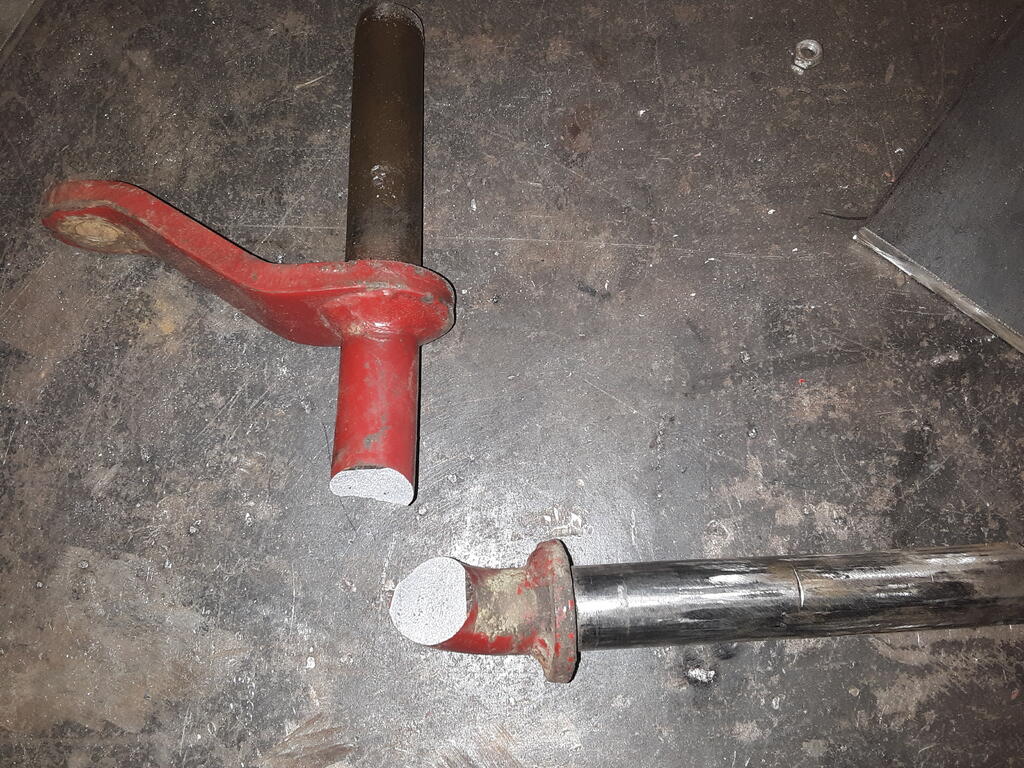

Brute force and a 12in long pipe. I didnt realize that it was hardened steel. The tire tipped in just a bit so I thought I would tweak it back a bit. Ya...no....wrong answer.

With that spindle breaking the build is at a stand still. I can make a spindle but I would have better chances of having 2 that match by building 2 new ones. If I go thru that much trouble do I just go with a 5 lug hub conversion? Then there is going to be a tire change. Ugh! Im kinda at a loss of direction. 🤔🤔

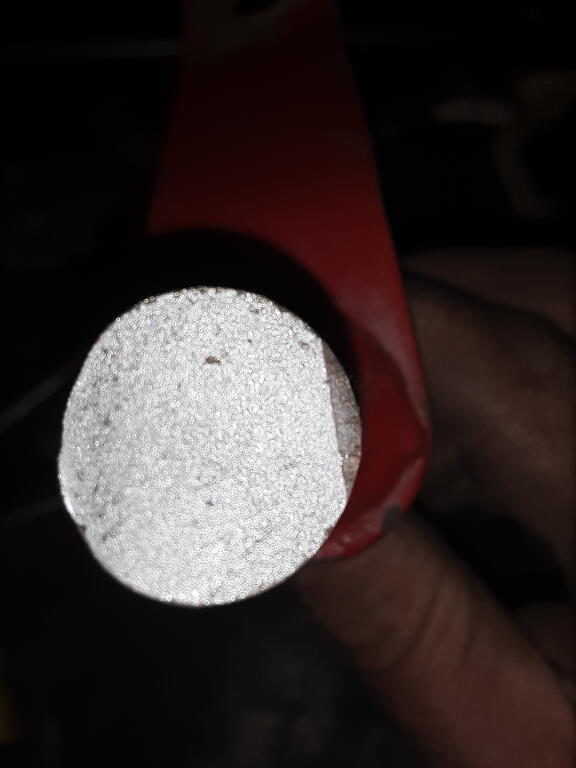

I looked that spindle over again. It was going to break sooner or later. The grain structure was to coarse and there is a black line on one side. That says to me it was already cracked.

8ntruck
That looks like a classic brittle fracture - could use that picture in a textbook.
  • Excellent 1
Oldskool
It was just a matter of time for failure.
8ntruck
All it would have taken would have been a shock load from a rock or a gopher hole.
  • Like 1

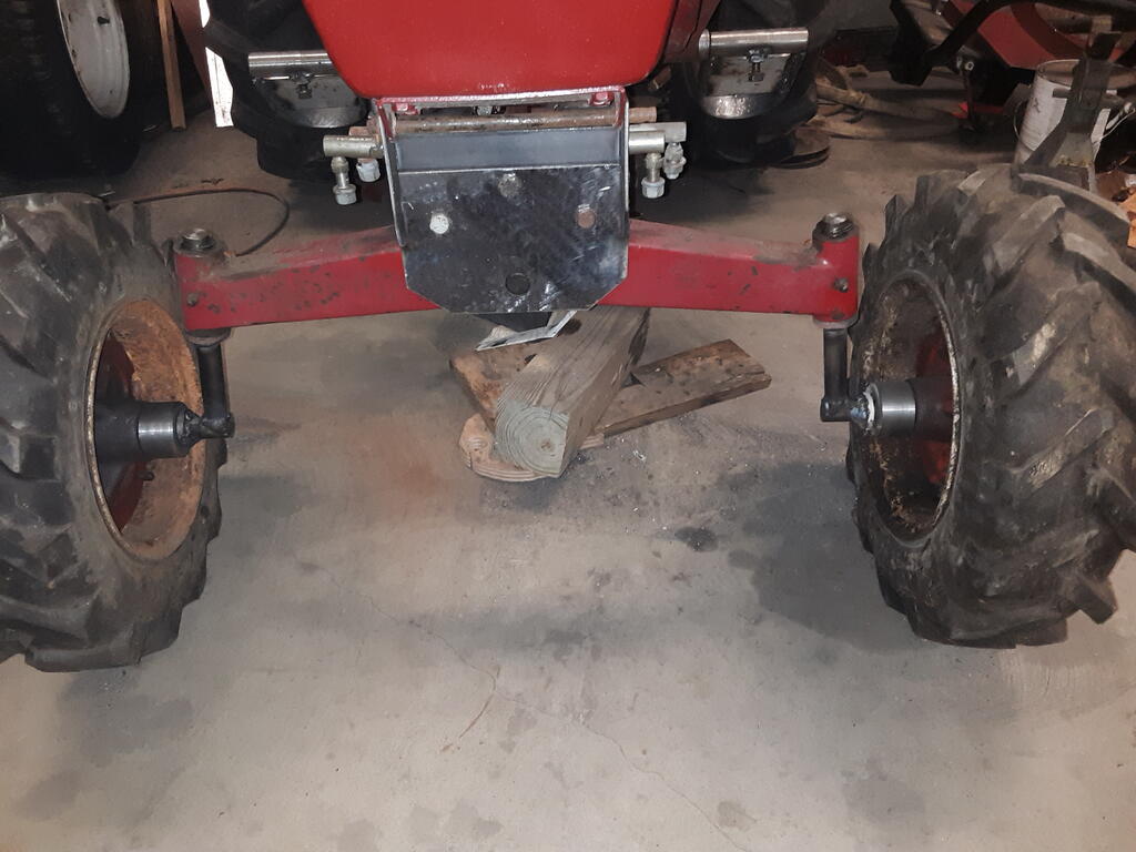

@ebinmaine the other ones I have here are shorter in height. The front already sits a bit lower in the front. I didnt want to go any lower. I decided to just build 2 new ones

The spindles are made and on for a dry fit. Now I know the tires sit correctly I'm going to weld a backbone to the spindles. That will go underneath from the hub stop and wrap up around to the steering arm. I was going to heat and bend some up but I'm about out of Acetylene but I think these will do.
